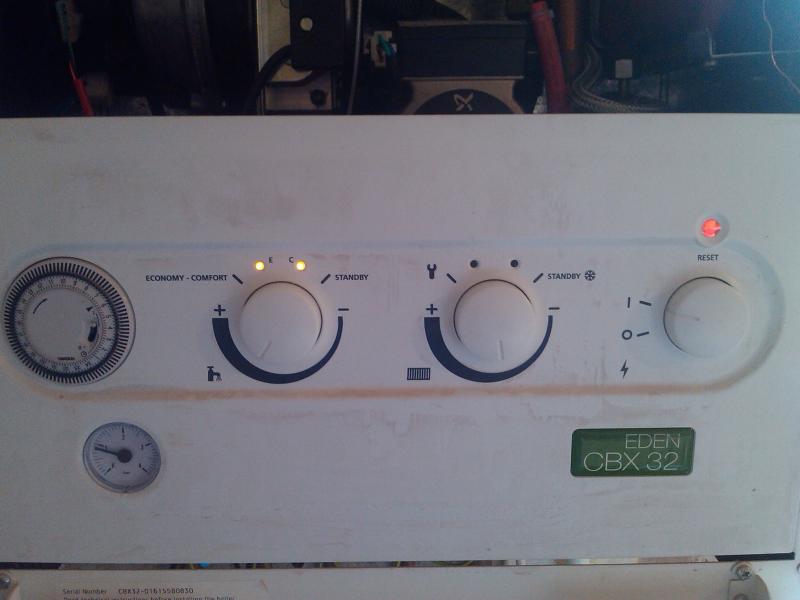

Hi,
My Halstead Eden CBX 32 (Natural gas) boiler's PCB failed, so I bought a 2nd hand one taken from a Halstead Eden CBX 24.
This is no problem (or so I thought), because the PCBs for these boilers are all the same (see Halstead part number 988488).
Anyway the second hand CBX 24 PCB came with a CBX 24 NG (natural gas) BCC chip fitted to it (see Halstead part 500682)
My original PCB didn't have a BCC chip fitted to it, so I thought just take the CBX 24 BCC off and it will work.
However, when I switch on the boiler, I get the following error.
The error means Incorrect /missing BCC - replace BCC
Does anybody know what I need to do to get this PCB working in my CBX 32 boiler?
Is it just a case of buying a CBX 32 Natural gas BCC (Halstead part 500690) or is it not possible?
Thanks in advance.

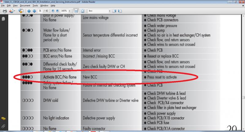

From reading the manual, I recon after fitting a CBX 32 NG BCC
LEDS 1,2,3 will light up, I will then press the reset button and the BCC will marry to the PCB.
Here is the relavent bit from the manual (circled in red)
Have you tried the reset procedure from the Installation instructions ?
a) Press the Reset button. The Reset LED and LED 1 should flash once.
b) Wait approximately 5 seconds, while the control is reprogrammed
and then press the Reset button, to initialise the control.
Yes I've tried that, it just stays like this.
When I buy and fit a CBX 32 NG BCC (halstead part 500690) to the PCB, I recon what you're saying will work. I will report back in a few days after I've ordered one.

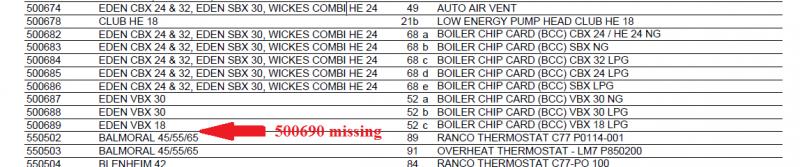

UPDATE:
The Halstead spares catalogue, also seems to imply these boards "default" to CBX 32 NG operation.
The Halstead spares catalogue, also implies there is no such thing a CBX 32 BCC NG. There no entry for part number 500690 in it.
However, loads of companies appear to be selling them, google "Halstead 500690" and you will find them. I'm even more confused now.
It's probably something that's been developed out of necessity, because of the single time programming of the PCB to accept a BCC.

After waiting 3 and a half weeks!! My CBX32 Natural gas boiler control chip finally turned up in the post. (The company I bought it off blamed Halstead for the delay.)
Anyway, I attached it to the PCB and turned on the boiler. As predicted I was presented with this error message.
The error means that the PCB has detected a new BCC has been fitted to the board.
A press of the reset button and the boiler came on normally. Well normally for this boiler, because I still don't have any bloody hot water, which is why I bought another PCB in the first place. See this thread.
