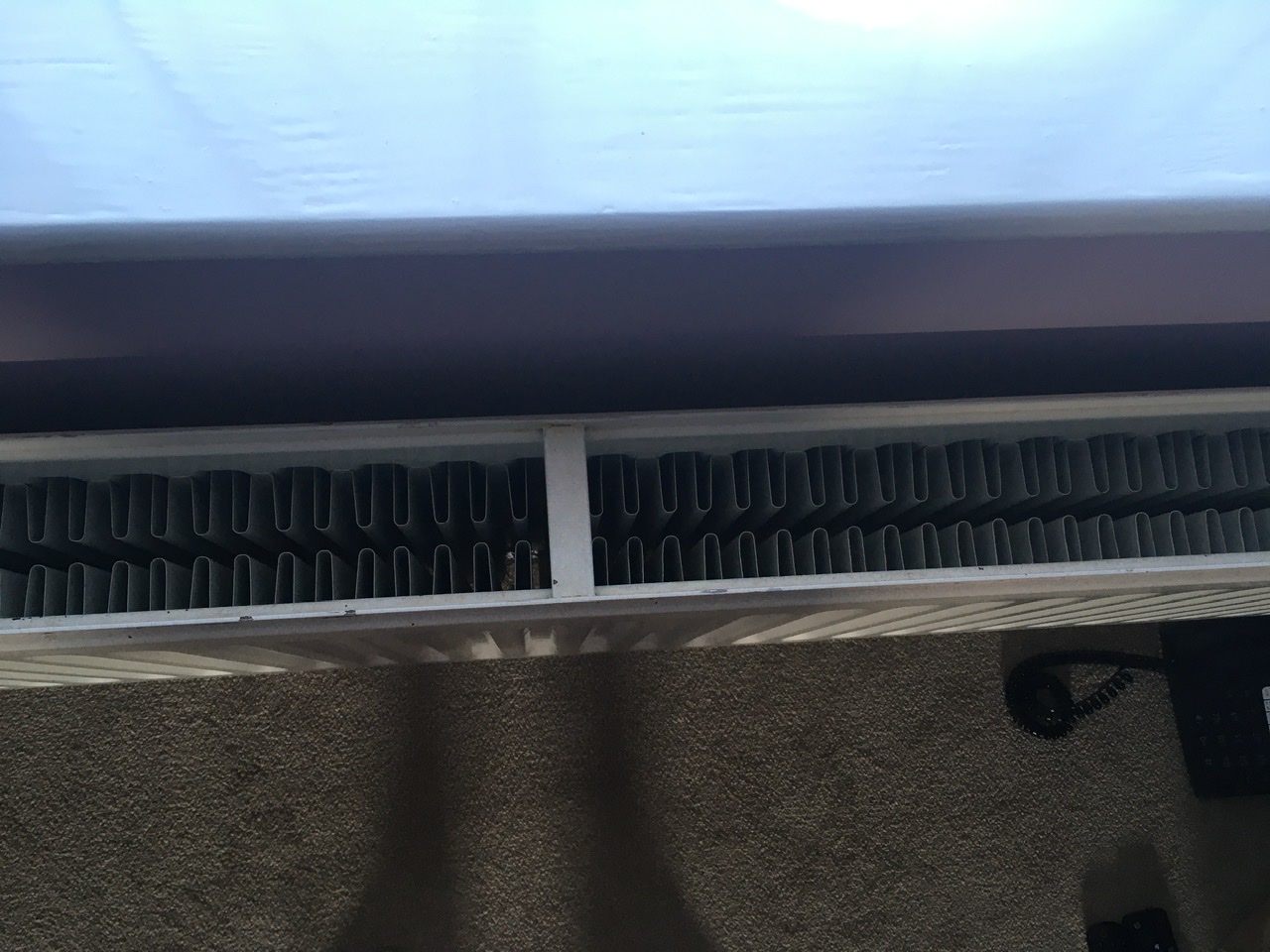

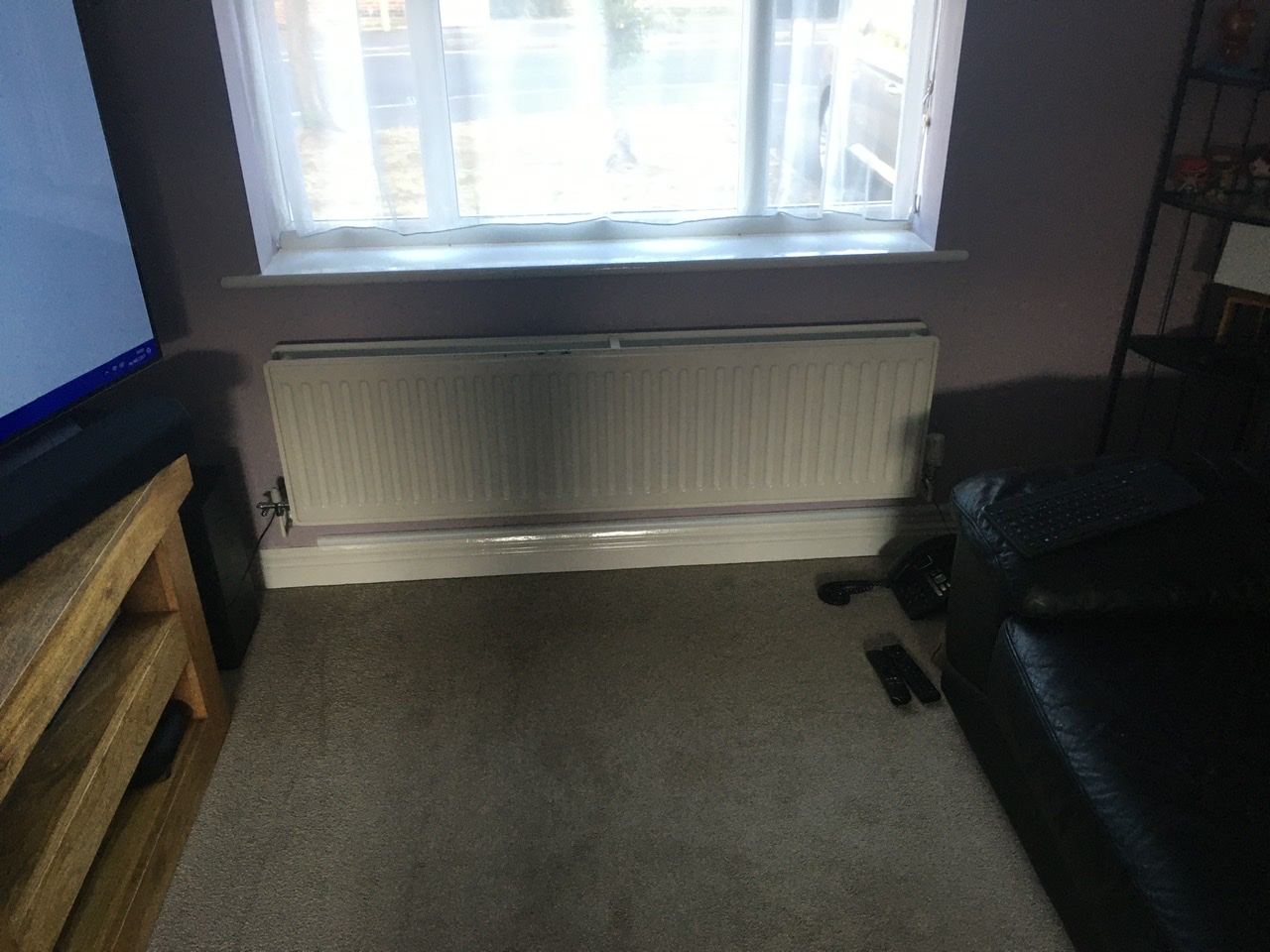

Are you sure it is a type 22 ? if it is then painting it is a complete waste of time, if it is then this will fit
it’s a double convector but doesn’t have the nice grill covers and sides, isn’t that link you sent a normal metric radiator?
This is the radiator
