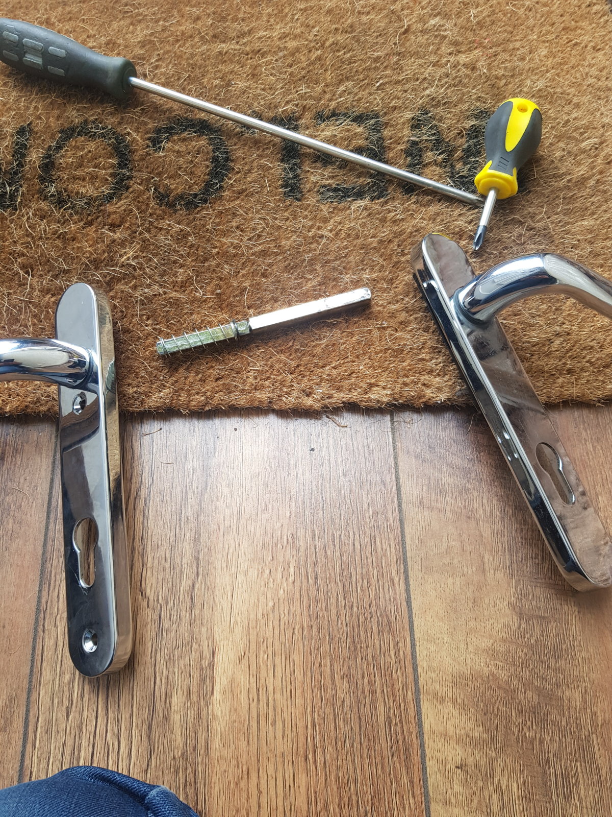

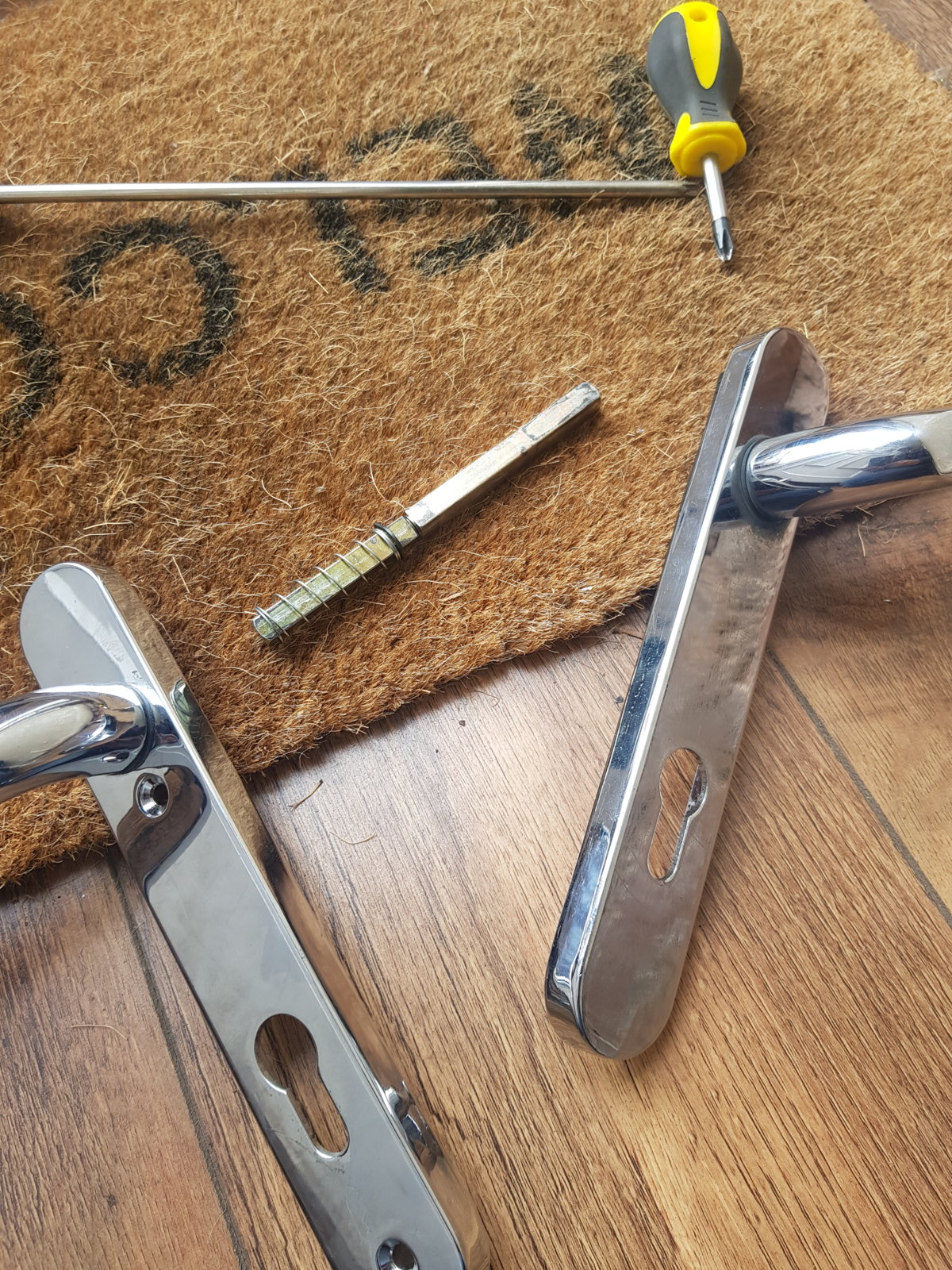

Hi had to get settee through front door, bloke took of front door handles off...put them back on and now the outside handle has no springiness in it..took handles off have , seems like there is a spring missing..see pic..we're working perfectly before.... 20190331_151438.jpg
Should be some of these...
Also make sure the spring side of your split spindle is outside
Ah..I see..actually the spring side on the spindle is inside..I assumed he put it on wrong..also did notice those spring cassettes but are the one with the hole on the middle..thanks
