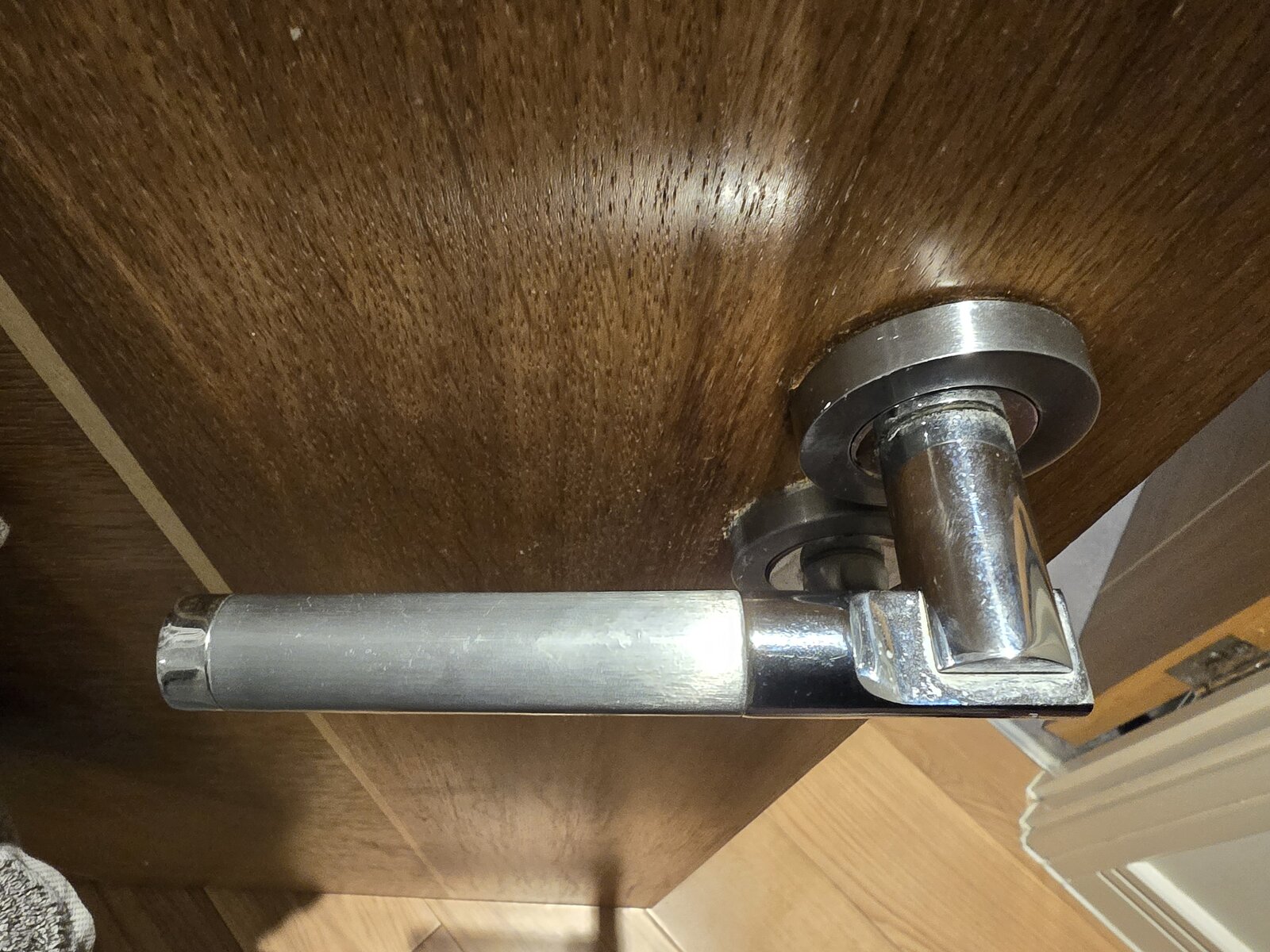

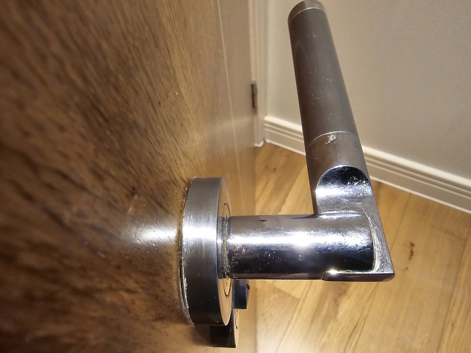

Hi the handle on my door is sagging/loose and I can't turn the circle cover on the handle to access the screws. I've tried using a jar opener gripper. Any ideas on how I can gain access I have a feeling the screws have come away from the wood. Thanks

OP can you take a photo looking up, normally the screw or slot would be at the bottom where it's out of sight, but you may have to take the cover off the lock to get access to the handle screw/slot.

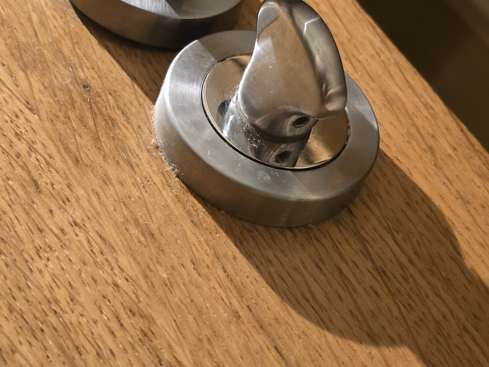

I recently had to paint doors where the "cap"/cover was held in place by a grub screw. Naturally the grub screw was on the underside, which means that you have to remove the lower thumb turn and cover before you can remove the upper one.
Hi sorry for the delay I've attached a photo looking upwards to show the underside. Thanks

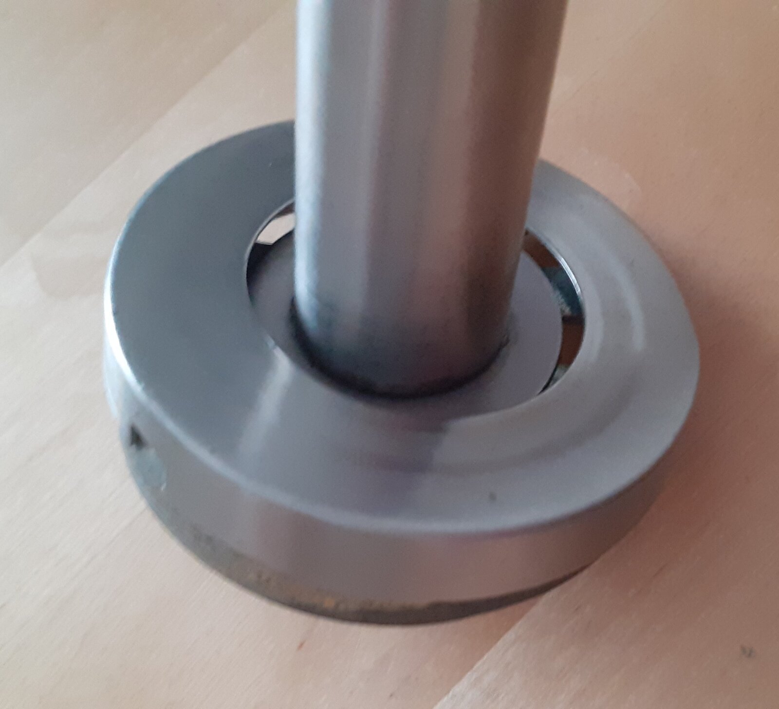

It does look like a screw on.
Have you tried a Boa strap wrench?
You mentioned using a jar opener, but I wasn't sure which type you used.
I have a friend that occasionally wraps his belt around the fitting to be removed and uses adjustable pliers to prevent scratching rather than using it Boa style.
Thanks for the video though.
Thanks all for your advice. I've just bought a boa constructor wrench to see if it can help remove the cover to see what's going on.

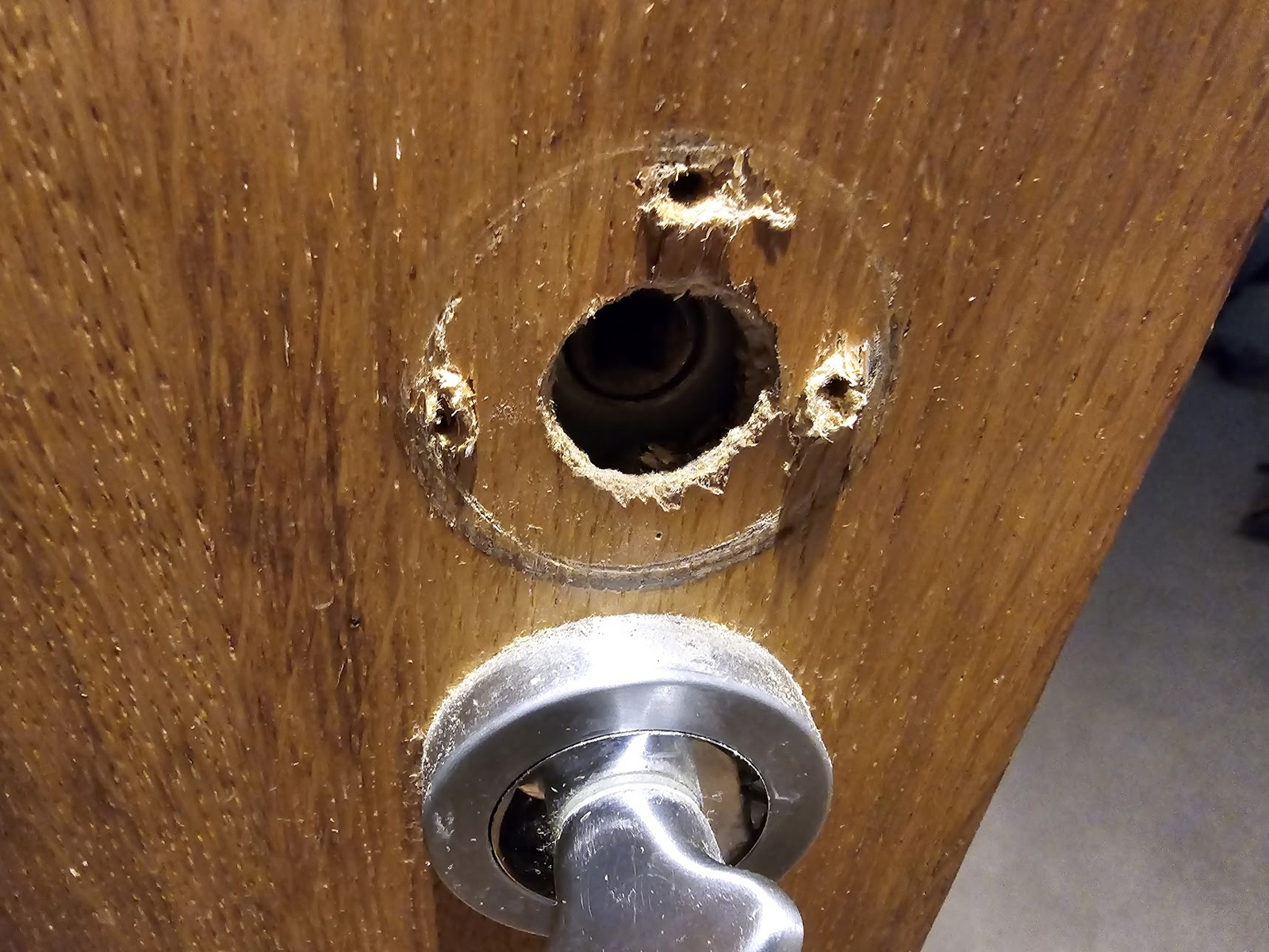

The strap wrench did the trick and I was able to gain access. The screws were threaded and bent. New screws same size capped are still moving around.
what would be the best way to sort this ?
could I fill the screw hole with an epoxy based wood filler ?
