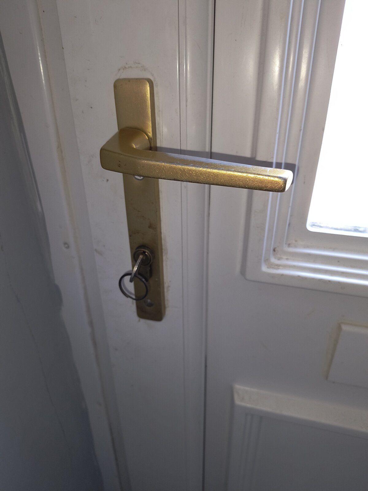

Handles/spindles - any thoughts on repairing these nasties?
22 Nov 2009
3,334
890
Oldham
Something is threaded, spindle or handle? Maybe originally a grub screw underneath? Just a self tapper now and the bottom of the hole in the end of the spindle has disintegrated. Any suggestions on repair/parts/replacement?
I'd say looking at that it's a 92pz with 122mm screw centres, overall height I'd say 205mm

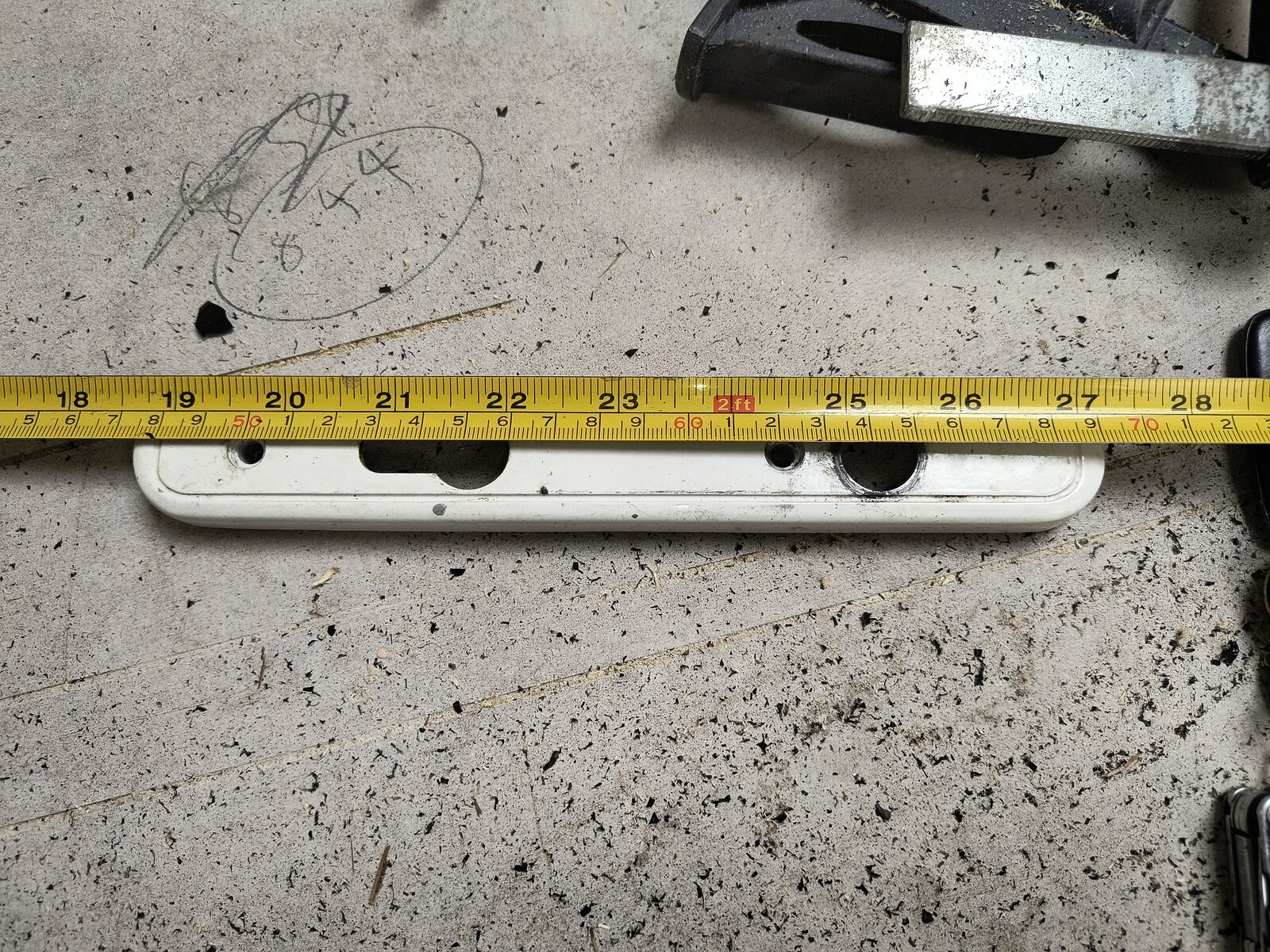

In actual fact it's probably a 215mm overall height but it's screw centres that a critical because the top screw goes through the middle of the gearbox
If they ever bring back the game show 'You Bet!' get yourself on it :)
'Hello, my name's Crank39 and in one minute I can name 20 different handle types just by seeing a picture.'
I think he's won the speedboat! Overall height is 220 including the curved ends, screw centres 122, PZ 92.
Even better for me, I just removed an old door at my house to replace with a fire door and the handle from that is a perfect fit!
