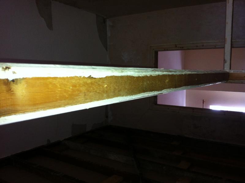

Hi my landing banister was boxed in and thought it mite contane spindles but a thought wrong. Base rail isn't a problem to fit but ad rather not buy a new hand rail but as you can see there is no recess for the spindles and packers to fit. How do you sugest I get round this?
if you buy spindles thinner then the handrail you could just cut them and carefully glue and pin them into position.
That's what I was thinking but with a bead along the top of the spindles to hide the fixing as I dont have a pin/nail gun what pins/nails so you sugest using for just a hammer ?
30-40mm pins,either pre drill the spindles or flatten the point of the pins before nailing them.so it stops any splitting.wipe off any glue then using a nail punch drive the heads in a tad more.
