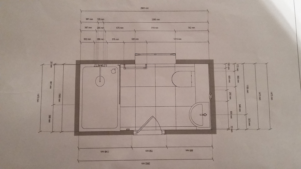

Someone has suggested to us that in order to save space in our bathroom we hang the cistern in the airing cupboard, directly behind the toilet. The airing cupboard is directly behind the toilet, and does not contain a boiler (so it's just really a cupboard now).
It sounds great to save space in the bathroom, but I'm sure there are things I haven't considered here. Is this a good idea or bad, and why?

A valid question. I guess it will save the approx 6-8" as dilalio states. Is it worth it? Maybe, maybe not. This bathroom isn't huge - the toilet and basin are against a wall that is 1.47m long. This doesn't leave a lot of spare room, and means the toilet is closer to the wall, and as a result, the window and radiator (under the window), than I'd like it to be. So it helps if the toilet takes up slightly less space. But yes, is it worth the trouble? Hopefully the experience you have will help make my decision.
I probably should have uploaded this image earlier. Although this shows with a built in cistern.

As @dilalio says any space saved can be useful and certainly worth the effort but it's then what that space is to be used for and what kind of look you want. Looking at the drawing you look to want to use an inset basin and vanity or boxing in and that was to carry along for the toilet cistern? I guess it all depends on the finish you wish to use and how you wish it to look. Moving it to the cupboard is no issue to do technically and gives you that space back behind the the pan.
If the look is to box in right along the wall then not doing that may spoil the lines and the look you want if that's already decided, it also removes a counter top that you would have, if that's important. Not knowing the look you want then it's difficult to say.
