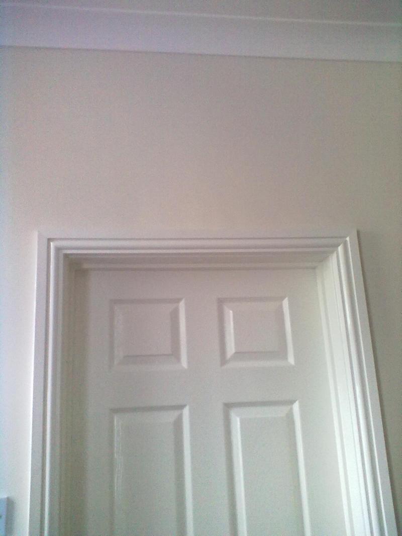

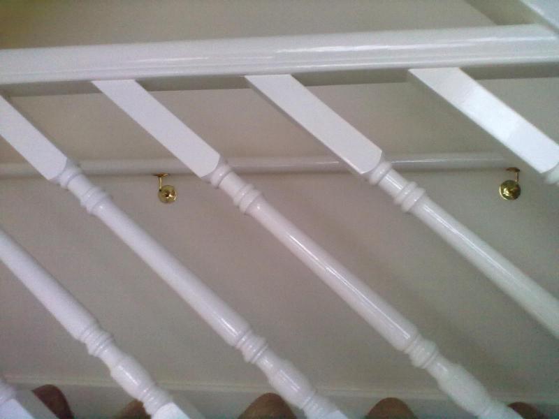

Here are a couple of images of the 'white' woodwork in my house. This is the Dulux 'blue lid' gloss I mentioned previously, 10 months after application.
Hope this gives you an idea of what to expect. I'll try and add a few images of Crown Solo gloss in a few minutes.

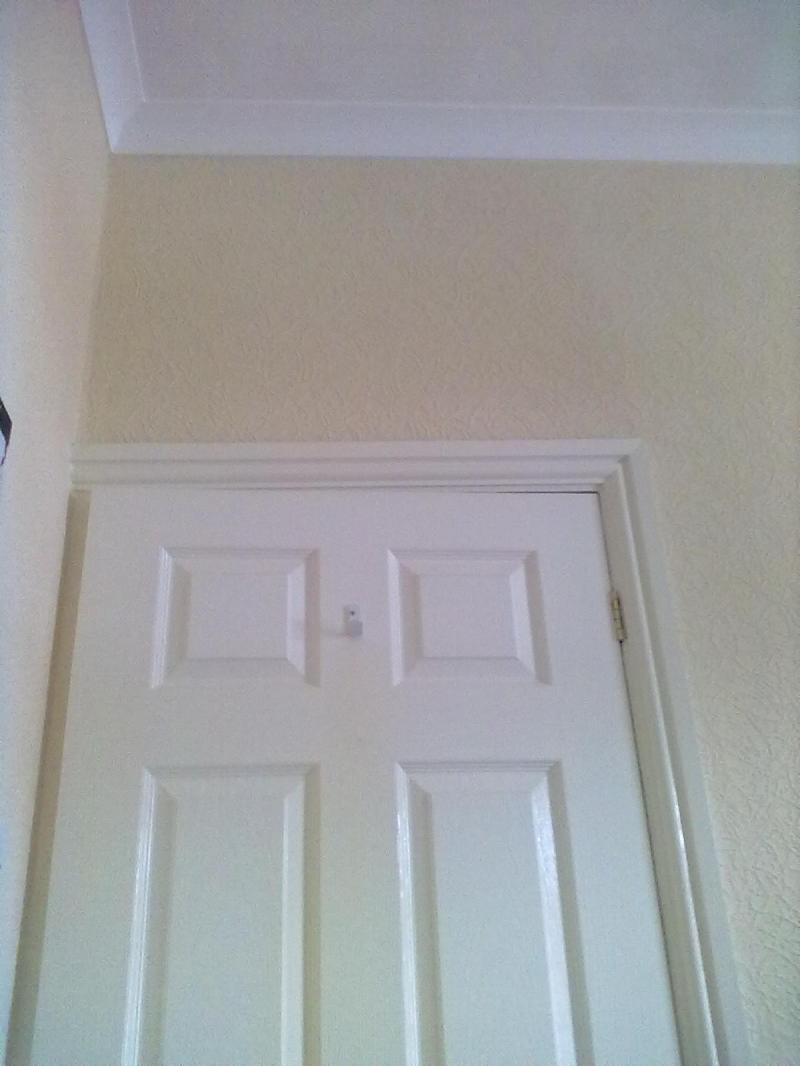

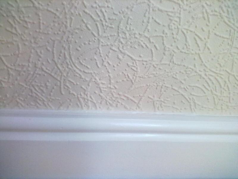

Here are the Crown Solo (post 2010) images almost 2 years after application:
Both of these rooms are North facing, with one window each, so receive average daylight. I've got a little of each ceiling showing so you can hopefully see the contrast between the whites.
*Edited to show which versions of gloss was used.

Thanks for the photos misterhelpful. I think all those shots look perfectly fine.
