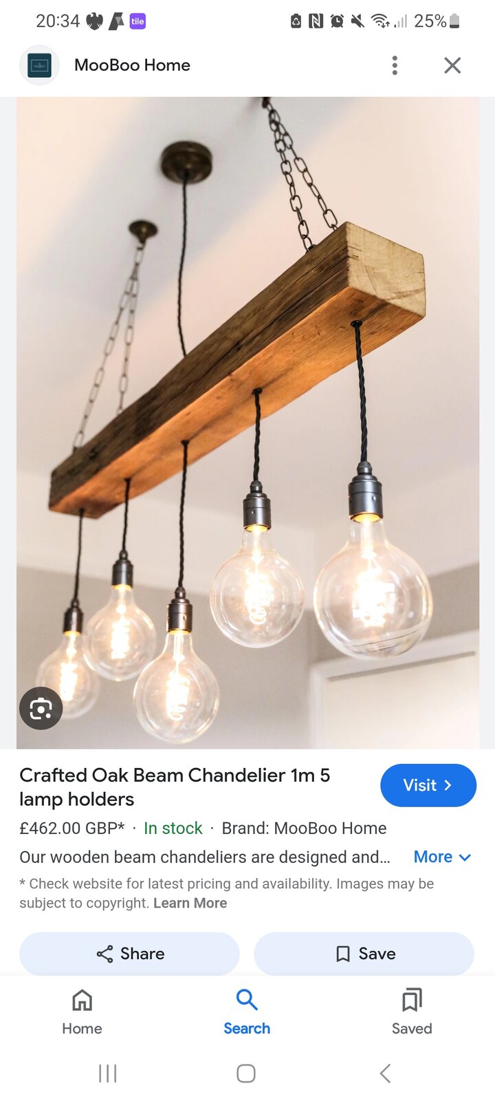

Hello,
We are about to hang a oak beam light fitting to our dining rooms
The oak will be hung via a joist in the ceiling .
I fear this may cause the plaster on our ceiling to crack ?
We are a 1970s house in UK if that helps
Example of fitting attached

Simply drilling through the plaster to secure into the joists shouldn’t cause a ceiling to crack. It’s likely plasterboard but you could open the screw hole up a tiny bit to ensure that no pressure goes onto the plaster?
20kg is heavy so I’d hope that you can get fittings into more than one joist and maybe use some bolts.

It seems to be a long suspended fitting. So you need a support at each end to prevent it twisting. Each must be screwed into a joist, not just supported on plaster. A vine eye or hook is very suitable, a couple of inches long so it is screwed well into a pilot hole drilled in the joist. You can paint it to match the ceiling.
There are various ways to identify where the joists are. You can get a "stud finder" electronic device.
The trained eye can often see a dust shadow or the dimples where plasterboard nails run. You may be able to hear them by tapping the plastercwith your knuckles. If you can access from above you can drill tiny holes through the ceiling.
you can also drill a hole between the joists and probe with a Special Tool in both directions to feel the distance to the two adjacent joists. They will be around 14 inches apart.

Fitting comes with its own hook fittings so it will be fine .( see ops photo).

That's amazing thank you
Just to add the photo an example.
We plan to hang the fitting by a two steel wires (rated to take £350kg) by a hook screwed into joist and eye bolt screwed into fitting.

No chance of that the two wires half the weight taken by each.
