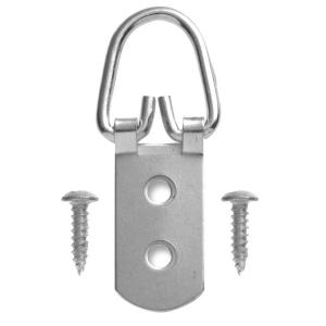

Hi Guys,
I need advise/guidance.
I am looking to hang a mirror approximately 10 - 15kg on a plasterboard/stud wall. Incase I don't find the studs or the mirrors measurement don't land on a stud, I plan on using a wall anchor (shown below).
What worries me, is that the mirror has a D-ring faster behind it (shown in the picture below). Now, I plan to use the screw that arrives with the wall plug or a nail to the wall (if I'm able to find a stud).
Please advise if using that screw will be enough or are there any much better holder one could put on the wall to hold the picture properly?
Don't want the weight of the picture to slip off the nail/screw etc/
Hope I'm explaining it properly.
Cheers in advance and look forward to your response.

How about the usage of screws though? Is this good enough to hold the mirror (the mirror as the above D rings behind). Would I have to put the screw in at an angle if I can, to give the mirror proper hold? Not sure if screws will be enough holding grip for a heavy mirror.
Please advise.
Thanks.
Think about it like this, that bracket will be attached to the back of the mirror using those two short and fairly thin screws shown in the picture. If those two thin screws can hold the weight of the mirror, then one longer and thicker screw into the wall will be able to hold it easily.

Only got kinda worried. Was thinking I had to look for some curved screw to hold that bracket in place - since there could be both outward and downward forces.
