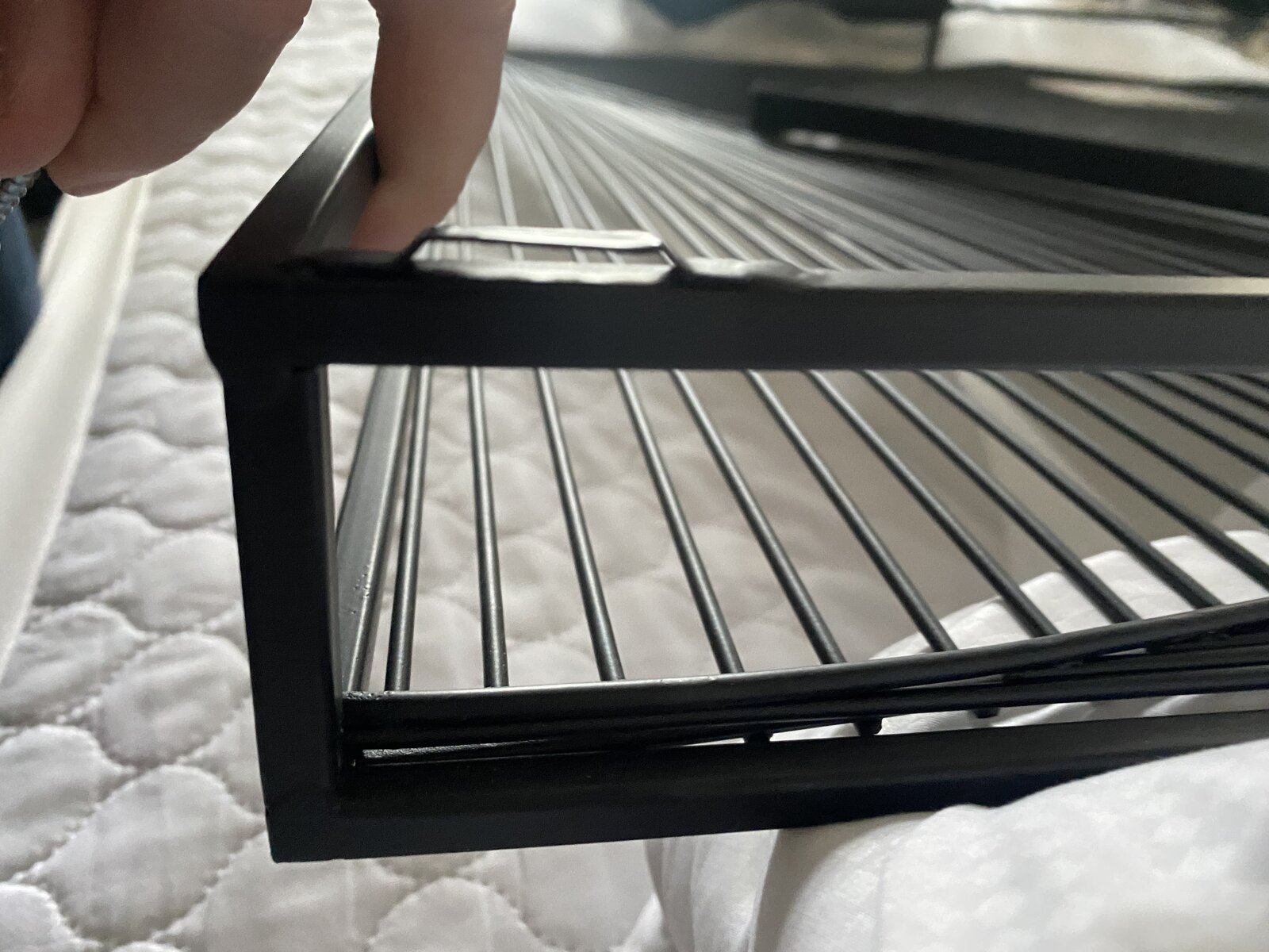

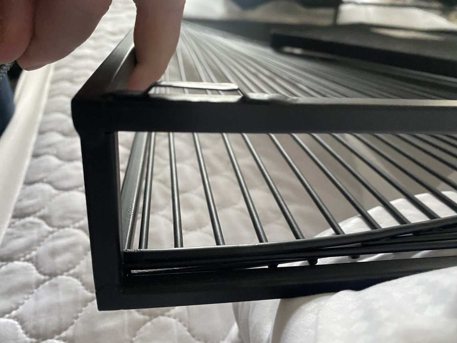

I have a new build with plaster board thin walls. The picture has two iron built in sawtooth hangers which you can sort of make out from this photo https://d2kz53n3bzvihv.cloudfront.n...90cm-oak-furnitureland-60ae05fac12b7.jpg.webp
What do I put in the wall, just pins and then let the sawtooth hang from them? The picture frame is about 10/11kg if I remember rightly.
I'm absolutely petrified about putting anything on these walls in this house, you hear so many stories. Normally I'd have used long screws to brickwork for anything I don't want to be at risk but they won't hang in the space of a sawtooth so not a chance.

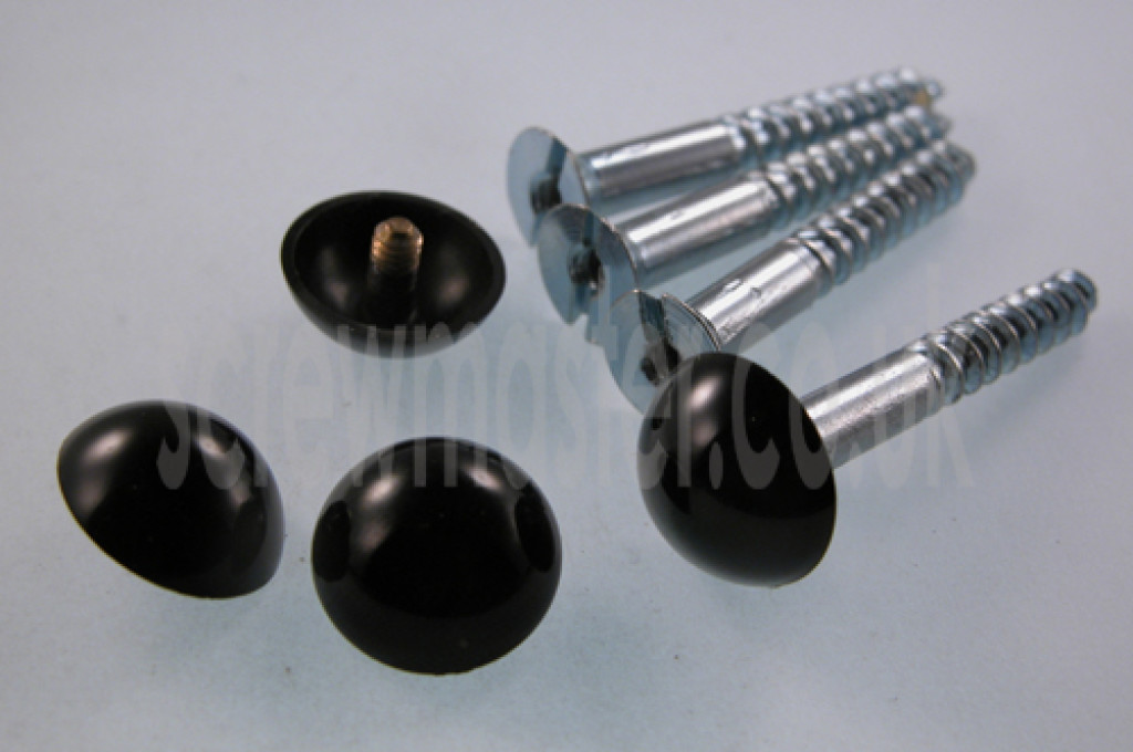

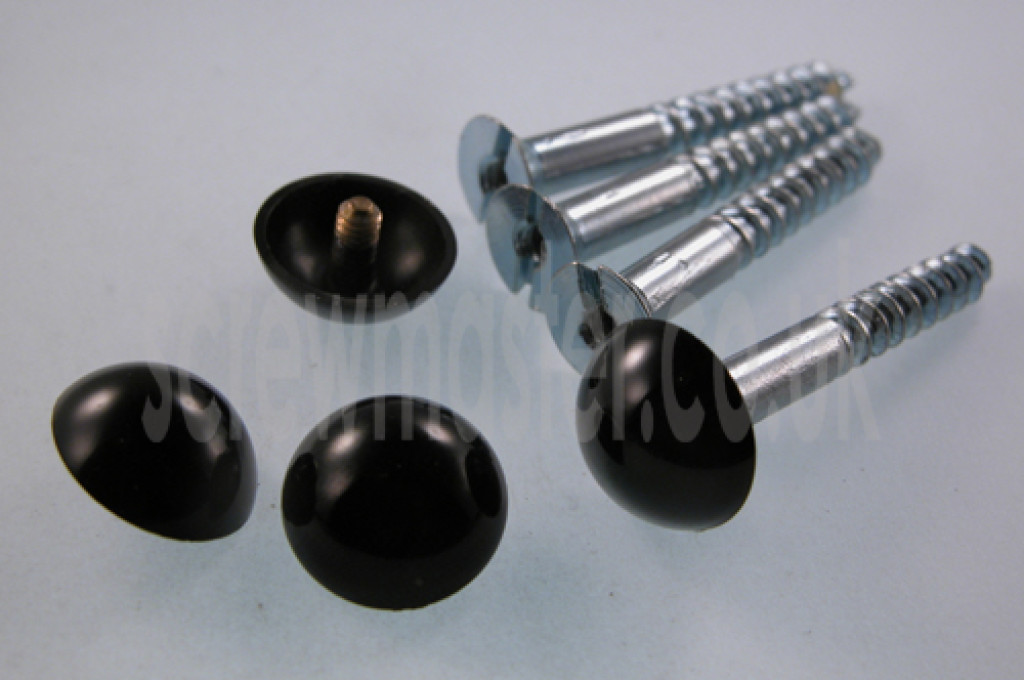

I would get something like some decorative mirror screws, that would be long enough to protrude past the sawtooth and frame.
A little like this...

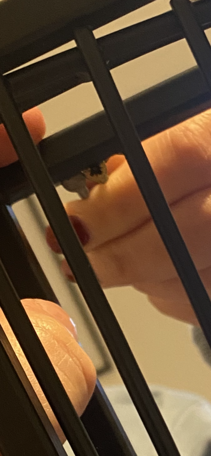

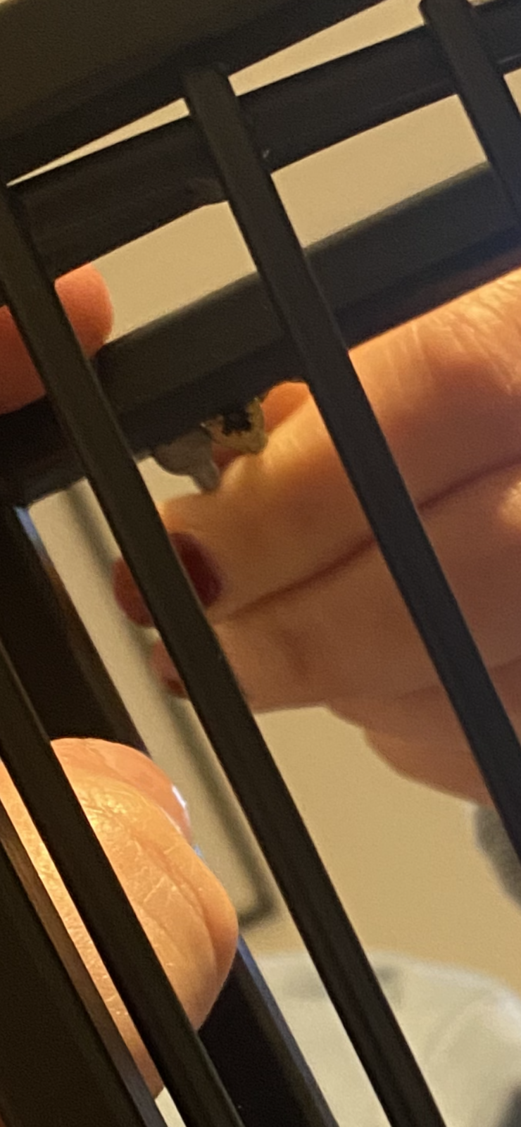

I bought various 3” screws today and all the heads are too big to fit on the sawtooth, what is it about these that make a difference is it the decorative part which means it can just rest but look fine? Sorry if it’s a stupid question
These are what I’ve tried today
I'm saying, let the screw come out of the wall by the depth of the frame - the sawtooth will sit in the shaft of the screw.
And if the screw is decorative, it won't look out of place, sitting in front of the frame.
