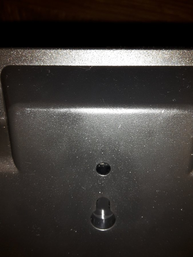

@HawkEye244, I can't damage the tiles as I live in a rented property.
@handyjack, That wouldn't work, see picture of the back of clock.
Ninko
A very very small splodge of gripfill will hold the clock on the wall, just enough for you to take it off again if you want. Splodge can be scraped back to the tile without leaving any scuff marks if you are careful.
Self adhesive velcro strips?
Put two strips on the tile vertically, then put two strips on the back of the clock horizontally (noughts & crosses board style). This way the velcro won't mate too well and should ensure the velcro separates properly, rather than the glue failing when you take the clock down.
Gaz :)
If the grout lines are fairly wide , drill into the grout, not the tiles.
