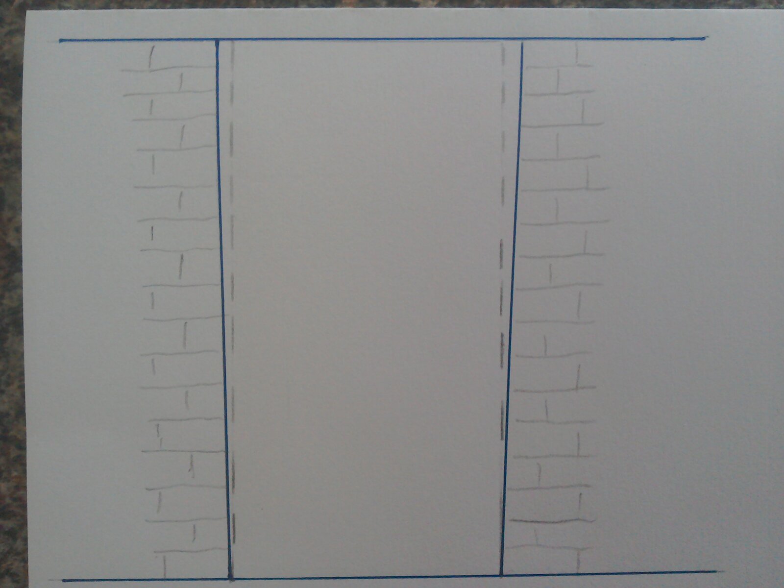

I am trying to fit an external door in an old outbuilding where the brick walls each side are out of square.
What is the best way to do this please?
a) Make the frame side batons square then fill in the gaps between the batons and the wall
or
b) Fix the frame side batons to the out of square wall then fill the gaps between the batons and the door
Attached is a rough sketch. The door is approximately 2 metres tall and the out of square gap at the top on both sides is about 2cm. The blue pen lines on the drawing are the out of square walls, the dashed lines are the proposed door.
Many thanks.
a.
Ensure the frame is square by using shims where required. Gaps will be covered with architrave.

How far out is it? And will a standard square door liner/frame fit?
You could use hardwood and trace the brickwork into the hardwood, using a bandsaw or jigsaw to make a packer that exactly fits the profile of each wall. Then insert a factory made frame
Many thanks guys for all your ideas and suggestions.
So fundamentally, the correct way to do this is to pack between the frame and out of true brickwork....thank you.
The gap at the top left is about approximately 2 to 3cm and the same at the top right. I like the idea of trying to cut a wedge/tapered shaped piece of wood to use as a packer, which I guess will need to be the same width as the frame itself. I think that will probably give the neatest finish too and I can cut some kind of "architrave", i.e. a thin strip of wood to use as a facia covering the verticals and the packing. May be a bit fiddly but happy to spend the time on doing the best job I can.
As the exterior outbuilding is very old and the opening is an odd shape and size, I am making the frame and door myself to fit. The frame is nothing fancy, just two pieces of timbers for the verticals to be attached to the inner walls, plus 2 separate top and bottom timbers.
I had considered trying to use some filler/mastic/foam instead of the wedge/tapered piece of wood for filling the gap but I think maybe 2-3cm could be too much to fill successfully.
Thanks for pointing me in the right direction as to the best way to proceed.
You missed out another option, namely trim the masonry to be more square
Best way I know to fill gaps is to use traditional trowelling mastic which will cover up to about 25mm or more
Whilst you obviously want to do a good job, depending on what the outhouse is used for can to an extent govern how precise you want finishes to be. For example if it's getting an overhaul/refurb to be used to sit in etc, you want everything more precise and 'neat' looking. If it's basically a store for household junk/stuff, then yes you want a decent job but having finishes as precise isn't quite as important.
Personally, I'd do the verticals with individual packers at the location of each fixing to ensure verticals don't bow when fixings are drawn in. Then fill gaps with any sort of exterior filler that can accommodate up to 30mm. Then cover areas where frame meets brick with basic trim.
Thanks again. Just looking up trowel mastic, not seen that before. I don't think I can trim the masonry to be more square due to the poor quality of the bricks and also lack of suitable tools.
diy_fun_UK: You are absolutely right, it is just an outside brick shed really, but I am always keen to try and do jobs the most professional way and am always eager to learn new tips and tricks.
I think as long as I can find a suitable filler to fill the gap (max 3cm) between the frame and the brickwork, then that is another option which is just as good as cutting a tapered piece of wood to fill the gap.
Thank you.
Try any builders merchant, Wickes or believe it or not Amazon. There's a bit if a knack to installing it, namely build it up in layers (leaving an hour or two between layers) and wet the trowel (a small pointed trowel will do) when working it.
I live in a stone district in the Pennines and nobody would spend the time to make a scribed infill (way too time consuming, plus they in invariably shrink or swell over time and they never ever fit tightly leading to draughts and water penetration). Mastic is the traditional way of sealing around windows and door frames up here, especially those in rough cast openings. You can also make your own burnt sand mastic from sand and linseed oil if you are keen, but using that is a tad more involved (cheap as chips, though). Filler behind it can be expanding foam or those poly tube gap fillers favoured by decos (Google "Fossa caulk saver")
