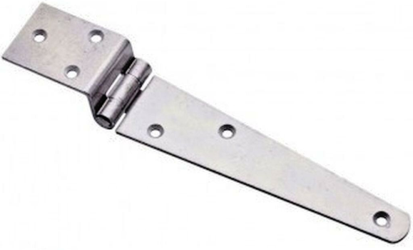

All the room doors in our cottage are traditional, tongued and grooved, "ledged and braced" (like a garden gate and not framed). They all open inwards, hung using T-hinges screwed into the "ledges" (on the inside of the door). However, in a corner of our hallway we are adding a guest toilet, which for space and access reasons requires the door to open outwards into the hall. It would seem totally wrong to hang the door with the ledges and T-hinges in full view on the outside of the door. The hall-side of the door should be the uninterrupted tongued and grooved face.
So, should I use conventional door hinges, rebated into the door lining on one side and screwed into the endgrain of the ledges on the other (presumably with appropriate endgrain screws, and maybe some packing to reach the edge of the door)? But would this be sturdy enough? Alternatively, are there such things as cranked T-hinges (a bit like kitchen cabinet hinges), or should I crank back the T-legs myself (using a vice) so the remaining leg-lengths could be screwed as normal (but actually "back to front") onto the faces of the ledges on the inside of the door?

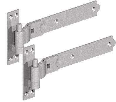

I am curious about the type of hinges you actually have. Do you mean hinges like these:
or like these strap hinges:
I presume it's the lower type we are talking about

Well, for starters there is no such thing as an "end grain screw", appropriate or otherwise. Any screws put into end grain are going to be more likely to pull out over time, but it also sounds like the ledges are set back slightly from the edges of the door meaning that a packer would be necessary whatever type of hinge is used. I don't thing conventional butt hinges would be at all useful. You can get "pre-bent!" ones (called cranked strap hinges) like these (from Ironmongery World and others):
but I think they are designed for face mounting on doors which are inset from the face of the frame, rather than what you are looking for. So it may indeed be easist just to use a vice and bend your own
Thanks for that JobAndKnock.
Yes, I should have realised that I could fix the hinges on the front face of the door, screwed through the Tongued and Grooved boards into the ledges on the back face. My garage doors are like that. So it would only be the hinges on full display in the hall (probably acceptable). And yes, my hinges would be strap hinges (but my local hardware shop called them T-hinges).
You are also right that the cranked hinges you showed would not work - it is the strap part I want cranked back - to pass behind the door edge and fix to the back face of the ledge.

I understand what you mean by 'T Hinges' as a long 'strap' hingeing to a 'leaf' similar to a butt hinge; "Strap" hinges I know as both leaf's of the hinge being long, equal length leaves. But of course differing parts of the country have different names for the same item.
Well jcp you have think about what you do. Are you buying in the L&B doors? or making up yourself?
With buying in you will have to bend the T-hinges to suit the depth of the Ledge and facing carefully so that the hinge leaf that fixes to the lining doesn't bind. So I guess the bend will have to be the thickness of the door facing plus ledge from the centre of the hinge pin.
Making up the door yourself you could consider having the door hinge leaf between the ledge and facing - obviously the ledge will need cutting out to suit. The bend will not be as far from the hinge pin in that case.
You also have 'interesting' jambs to make up to work around the ledges.
