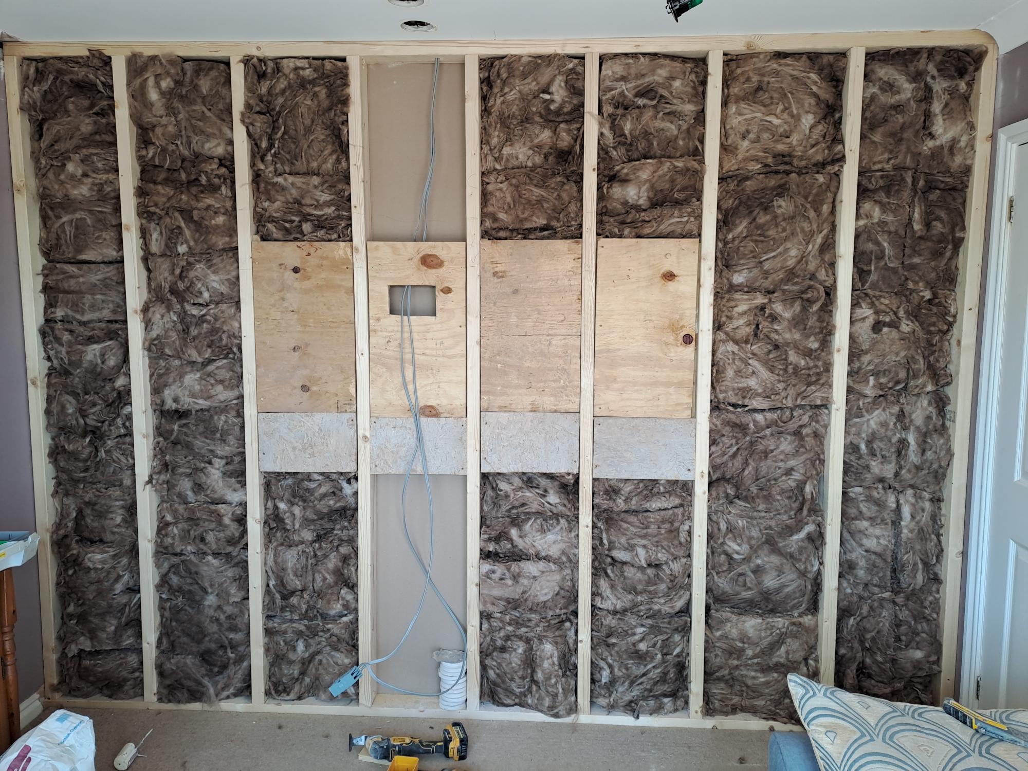

Friction between the studs will hold it in place both till you board the wall and subsequently. If you pack it quite tight vertically it will minimise any settlement.
Cavity batts are easier to work with than rolled rockwool.

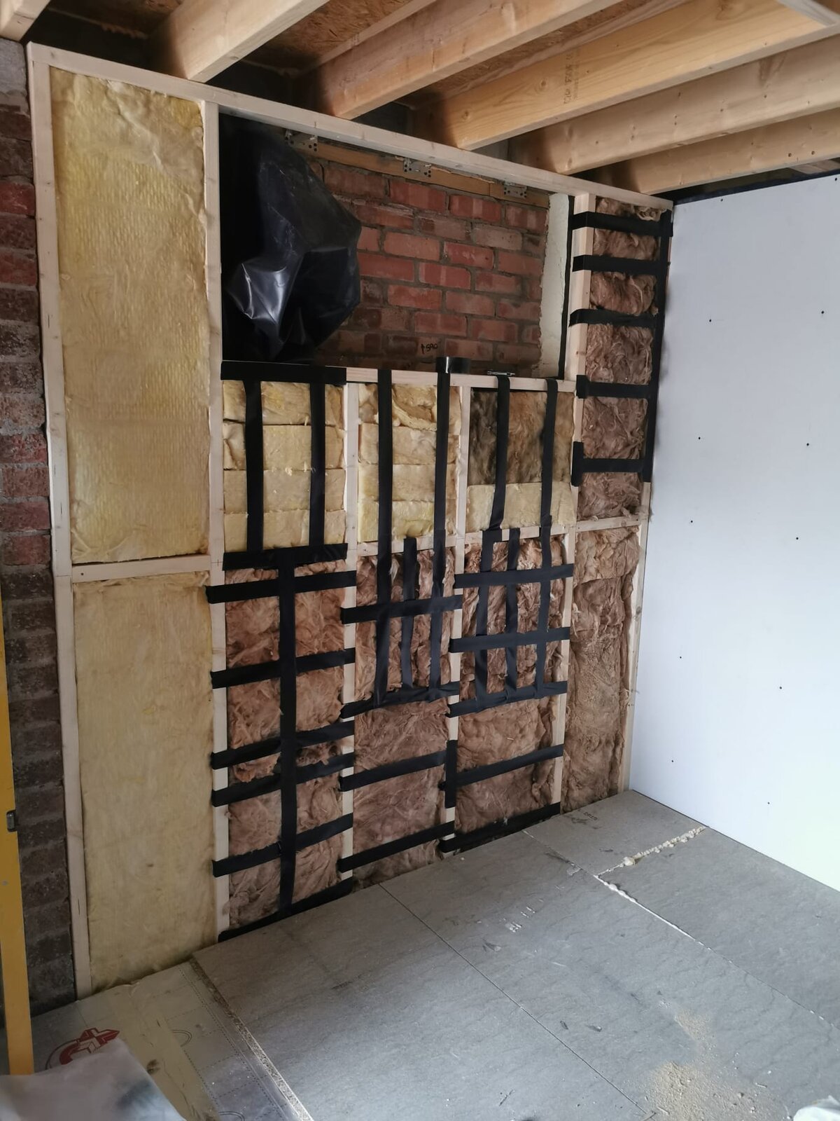

I've used both, cut them slightly oversize and squash them in, I then use a couple of lengths of duct tape stapled to the insides of the next stud if I'm not going to be putting the plasterboard on for awhile and they've always stayed in place fine.
That's the last one I did, it was done with alot of offcuts so there's alot more tape than I'd usually use, normally it would just be 2 horizontal lengths.

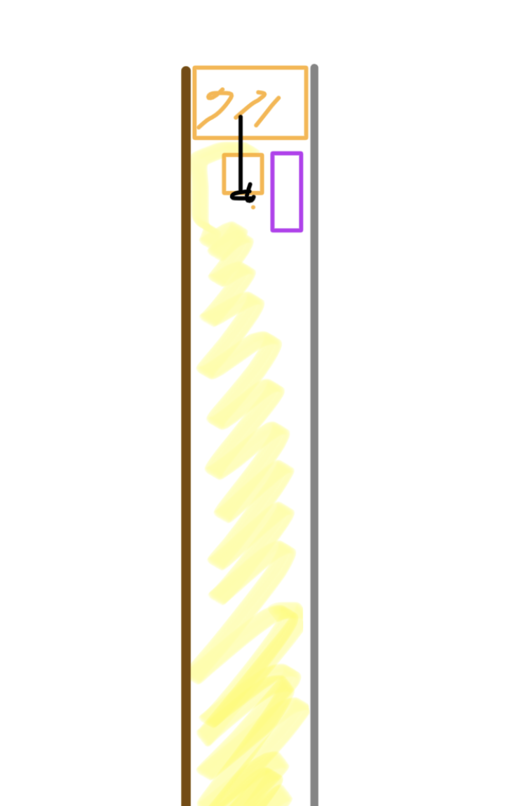

If you do think you'll get slump (eg 100 roll in 100 wall) you can cut it slightly longer and at the top fold it and trap it between a screwed batten, then fit another bit or wool (or better, PIR to compensate for the batten).
Side cross-section cut view of the wall:
Sheathing(brown), wool(yellow) and plasterboard (grey) and at the top the top rail (orange) with batten (orange) screwed (black) through trapping the wool and small slice of PIR(purple) (or more wool)
