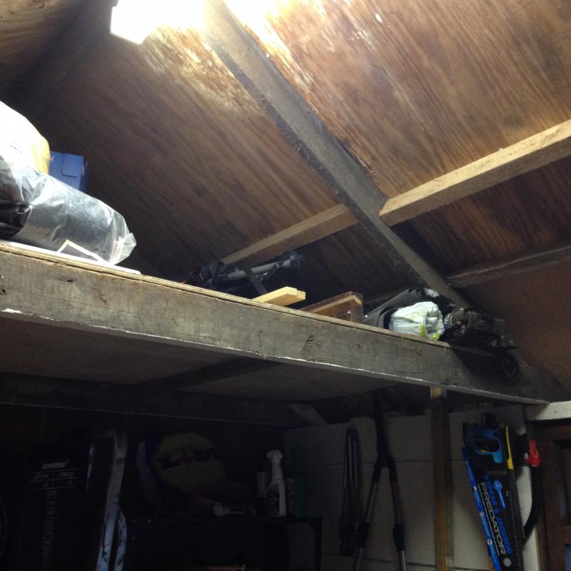

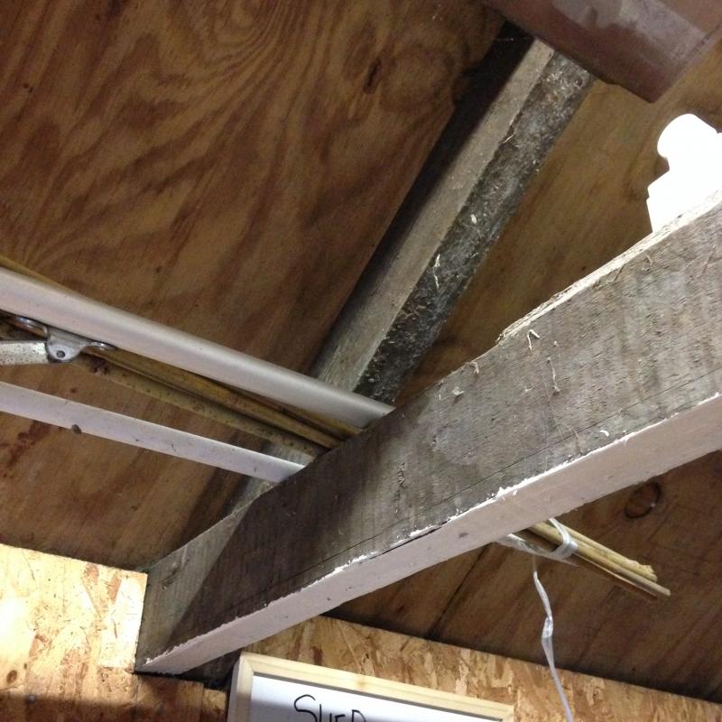

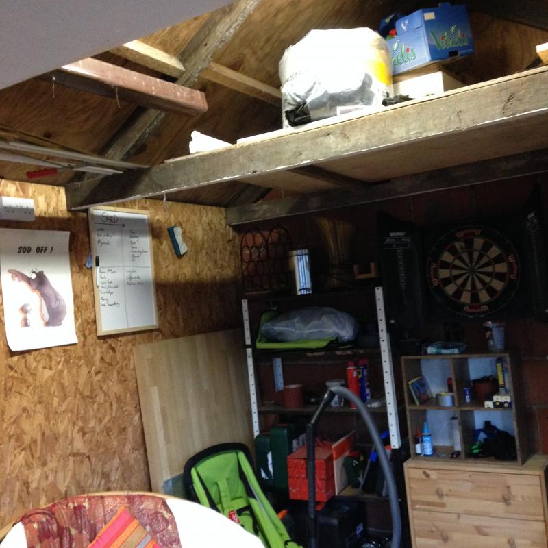

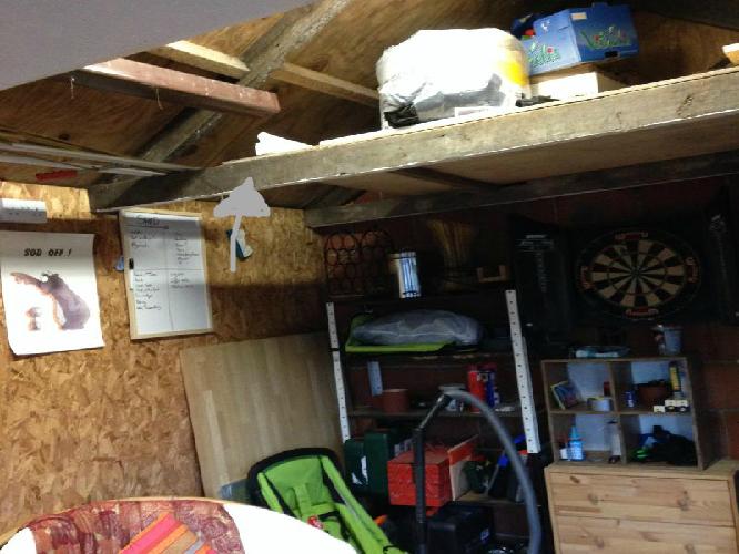

few of pics of the shed beam location:

Bag won't be hanging in centre of beam - is that an issue?
