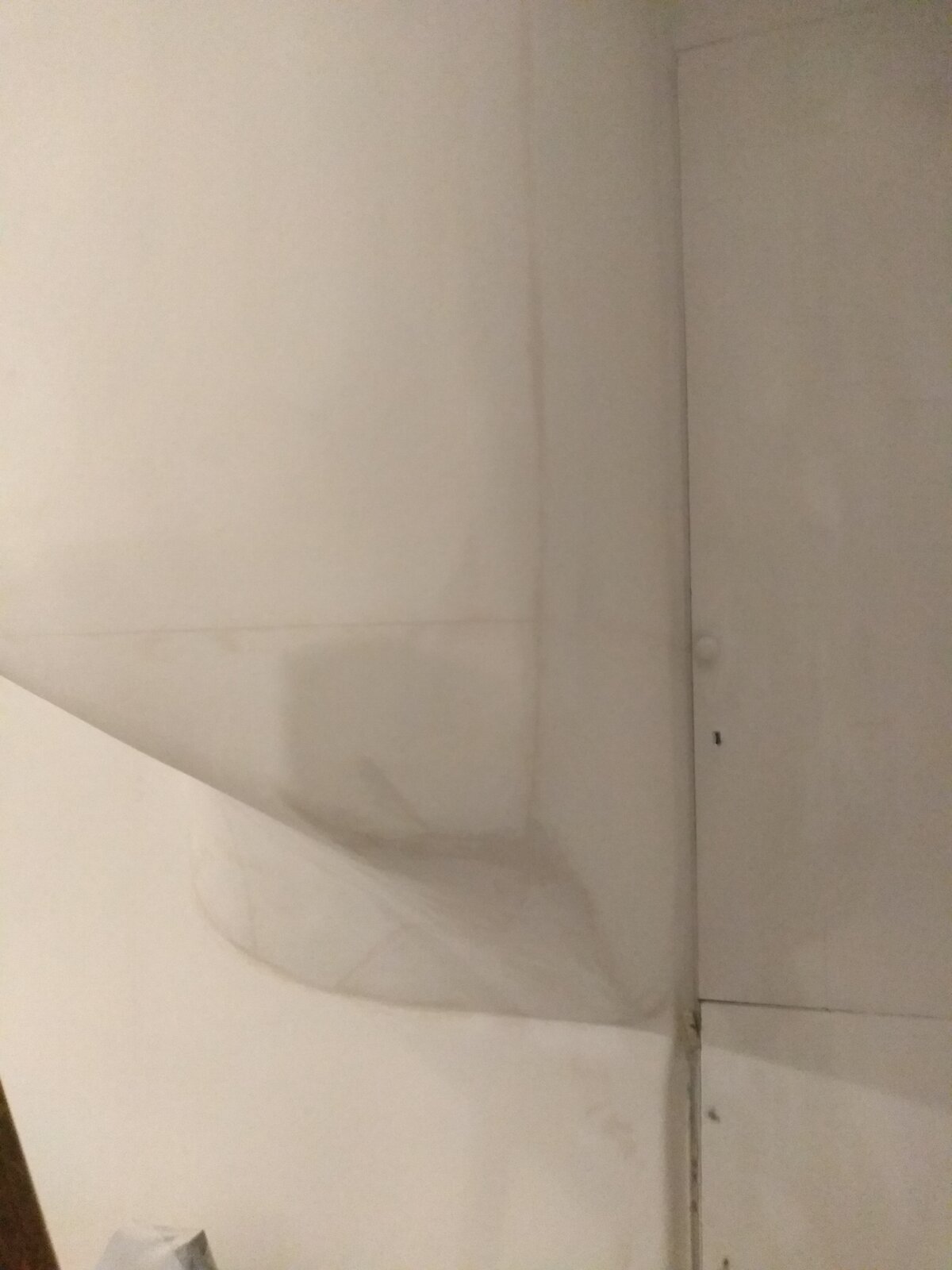

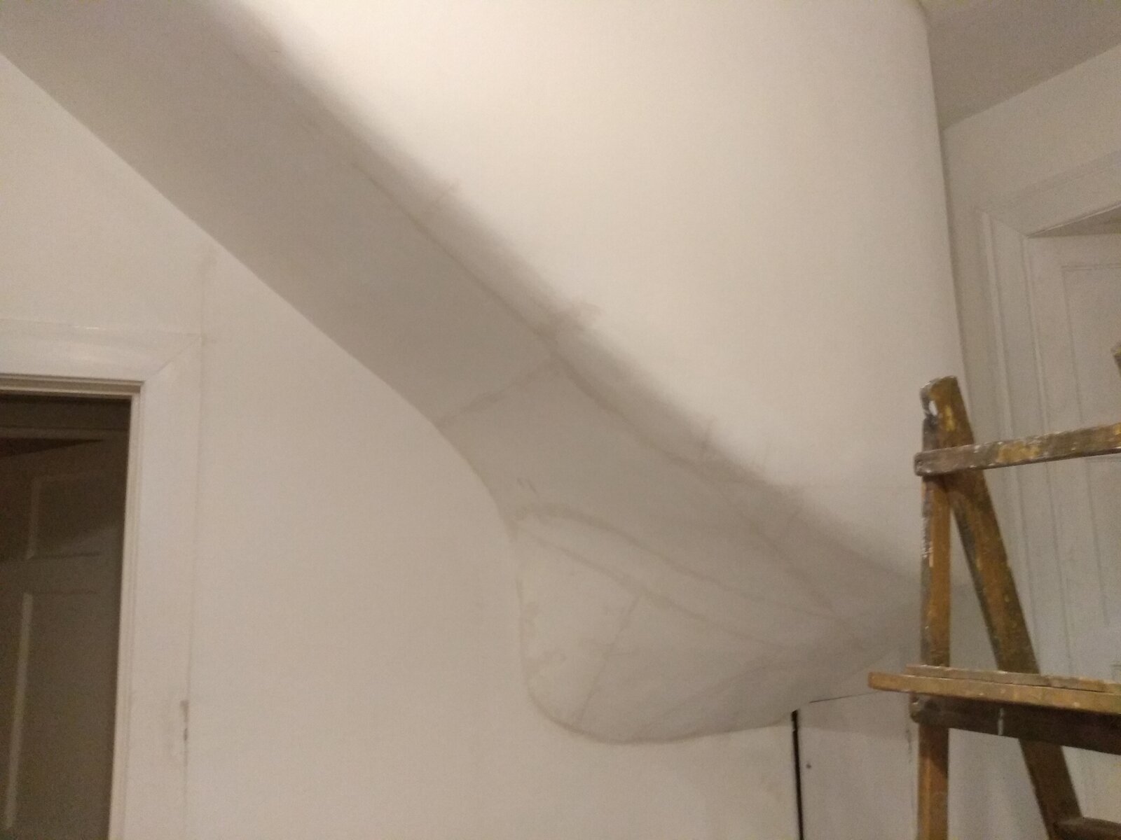

I had a lot of quite big gaps because I had to paper around a curved surface, running at opposing angles at some places. As I had quite a lot to do, and I had a tub of ready mixed plaster I just started off using that. The pics below show the feature I am talking about, after I had filled the gaps with the ready mix plaster, but before painting. I painted the lining paper and gaps before plastering, to protect the paper from sanding, as per the advice in the second video above.
Later I bought some screwfix own brand dry filler, mixed some water and some paint in and used that for some of the smaller gaps on my next pass. The good thing about having the paint mixed in is that you don't need to wait and paint to see how it looks, you almost have a final finish straight away. I always find when filling that I fill sand, then paint and after painting it shows up any issue so I end up filling again and painting a second time, but this saves a bit on the painting steps.
