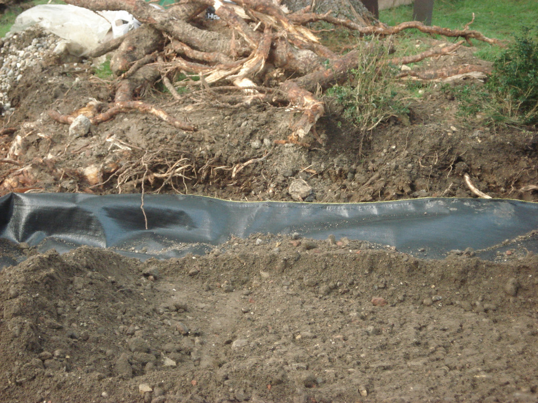

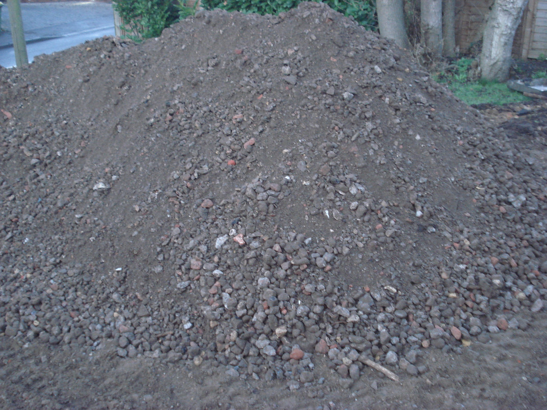

Hi, we're having a new driveway installed and the hardcore being used looks like soil with stones in it - is this normal? It certainly does not resemble type 1 hardcore. Cheers.

I apologise if I have misread you then. If you had said "did you mean to say 'do they have an accent'" it would have been clearer. I'm always happy to help and from your photo I can see they are not doing a good job of your driveway.

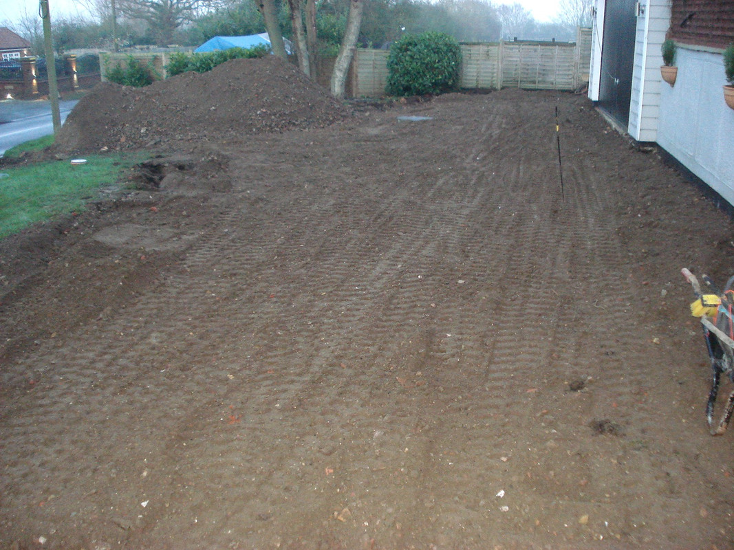

Do the workers have accents? Were they recommended to you? Have you seen their other work? If you could stand back and take photos of the whole area that would also help.
But I would say that if they lay your driveway on what you have sent in that photo, it will move fairly quickly.

It's a 250sqm drive, you can imagine the price. I just need to clarify what the 'hardcore' being used is good enough. It literally is soil with a small % of stones, nothing like type 1.

You have had a big pile of dirt delivered - the cheapest thing they could get hold of by all accounts. It may look great for the insta photo and the checkatrade rating, but you'll see the consequences in a few years.

Is what what it literally is, dirt? Not even a hardcore-name attached? The dumper trucks delivered it before scooping the old rubble away at the same time.
The drive is on a slope so drainage goes into the lawn and road drains - as before when tarmacked.
Nothing re planning permission, didn't think it needed it?

As others have said - that all looks bad.
And your drive is NOT allowed to drain onto a pavement - have to put in channel drain and soakaway.

This is great site to ensure you are forewarned and forarmed - it talks about thickness of MOT needed, issues, drainage, etc.
This page shows what MOT should look like:
https://www.pavingexpert.com/subbase
And step by step block paving construction <<< not clear if that is what you are having, but they also describe other drive materials:
https://www.pavingexpert.com/bpvseq01
