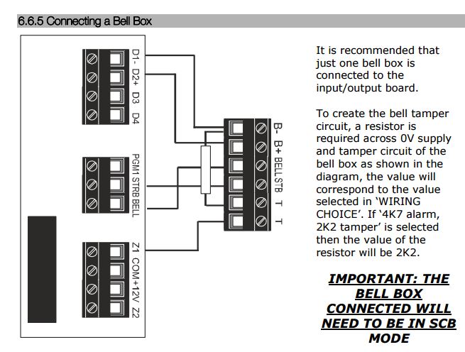

In the Pyronix, however, it suggests that the Tamper circuit is created using connections 1) Z33 and 2) D1- on the panel, connected through the TWO tamper connections on the sounder, with a 2k2 resistor in series between one of the tamper connections to the negative power.

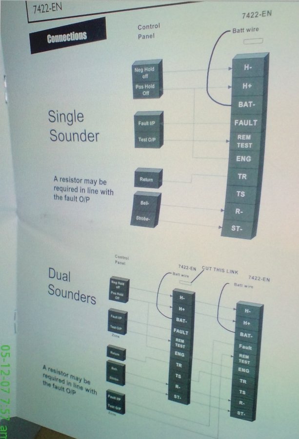

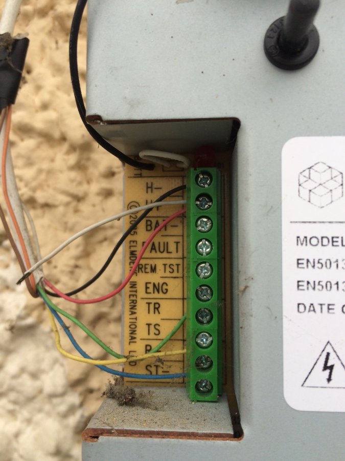

The Elmdene only has one tamper input (TR), the other tamper connection (TS) is when you link this to the TR input to a second Elmdene sounder, according to the manual. I've attached the manual and actual photo of the current connection. I'm confused how to create this tamper circuit - do I use the TS connection?
I also see a note in the attached Pyronix manual (not actually my manual but close) that the bell box needs to be in SCB mode. I also see a black wire from the -0v connector on the sounder, that isn't connected to anything, I think it should be in the Batt - connection. Does this mean that its in SCB mode if the battery is connected and can activate without power? What if the battery is dead, does this mean that it would sound?

On the Elmdene sounder the 'TS' terminal is normally linked to the 'H-' terminal. It is possible to break this link by cutting the little white wire loop which is visible towards the top of the OPs first photo. You'll need to do this if you want to use two bell boxes or you want to use a different tamper circuit. However, this doesn't do anything to address the SCB/SAB problem.... unless you use an external PSU and a relay.
The black wire which can also be seen exiting next to the white loop needs to be connected to the 'BAT-' terminal in order to enable the battery backup feature.
