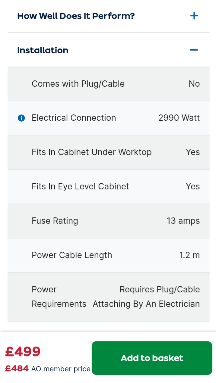

Asking for the in-laws. Their current oven is plugged into a standard UK 3-pin socket. They're looking to replace it, and we're struggling to get a definite answer, either from John Lewis, the retailer with it at sale price at the moment, or from the Bosch online installation instructions, whether or not it comes supplied with a standard UK power cable with moulded plug, whether or not it needs a hard-wired connection to a double-pole wall switch, etc. etc.
There's no illustrations to help in the Bosch installation manual, and the wording is vague and unhelpful.
Has anyone installed this actual model recently, and could advise?

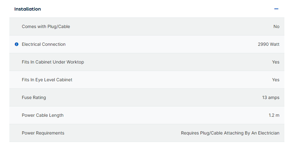

I have no experience with this oven, however the specifications are available...
It does not come supplied with a plug and cable.
It is also rated at 2990 Watts - this is bang on 13A @ 230V
Most plug-in an go ovens are rated at around 2400W, quite a bit below the 13A fuse rating - allowing a safety margin, even with continuous use.
I think it would be unwise to put a plug on it!
Hardwiring would be preferable.

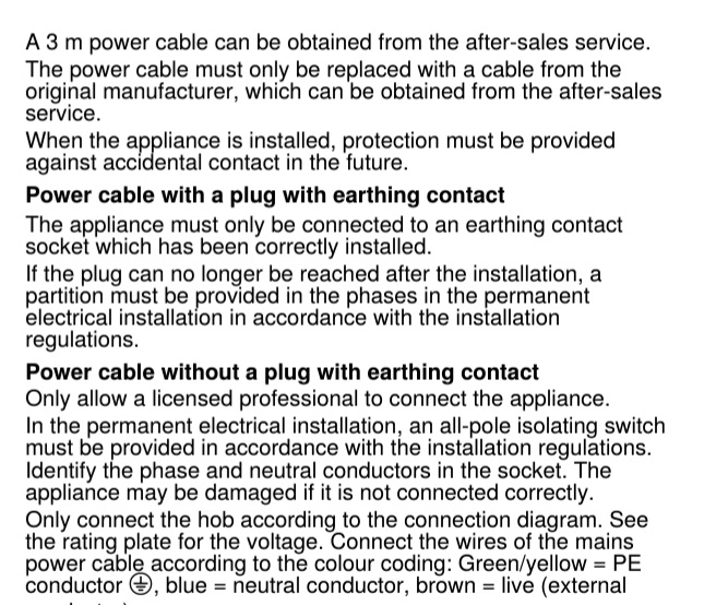

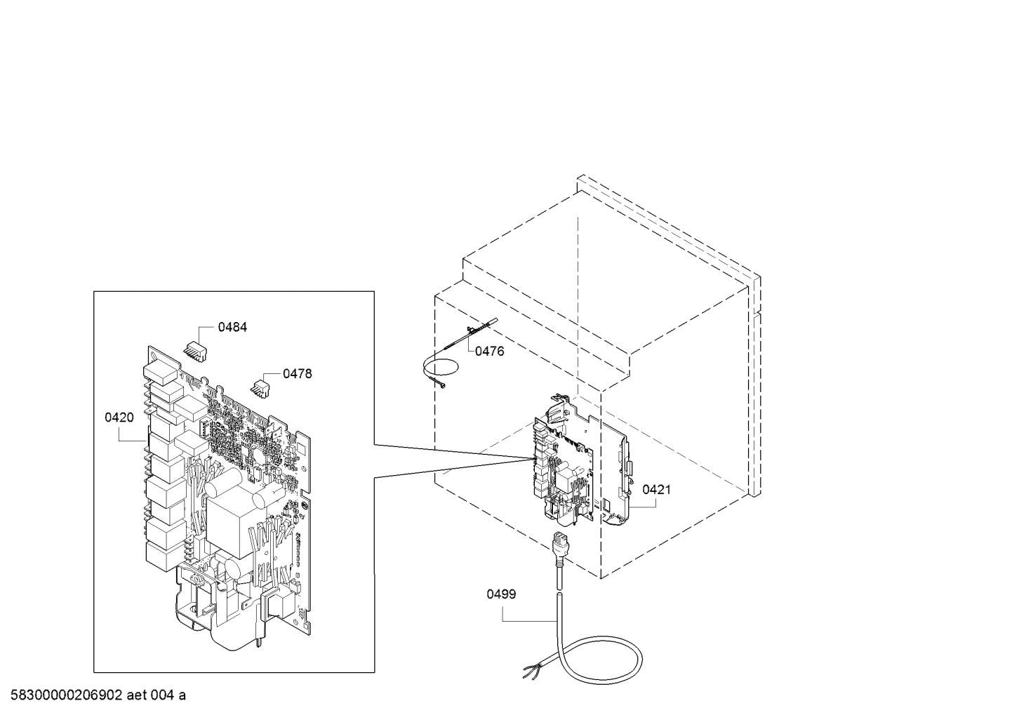

At the Bosch website, they show a plug-in cable with a bare wire at the power supply end, and the installation instructions suggest that a longer cable is available as a spare ....
and the spare cable appears to be standard flex ..
Yes, but the Bosch manual also has instructions like...
And pictures like...

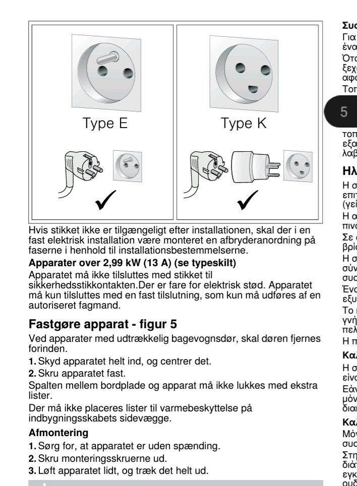

These are aimed at the European market where you may be able to plug an appliance in that can draw up to 16A.
Am I the only one who reads "earthing contact socket" and thinks that could mean a simple UK 13A socket ...?
Honestly, I really don't think they've worded it very well
It's probably an automatic translation from the german original.
Some plugs in Europe do not have an earth contact.
I think that is intended for the continent, where some of their sockets lack an earth pin. Me - I think the only way forward, is a 16amp plug and socket, or a direct connection to a cooker outlet.
I also note that the word afbryderanordning in the Danish version (switching device) has been translated as partition in the english version. They might as well not have bothered with the translation.

Bosch UK website states a cable supplied and a 13A fuse required (to protect said cable). Thus a 13A good quality plug fitted should be OK. Changing the socket for a fused connection unit may reduce the plug to socket spring connection heating that can sometimes occur. But a (13A) fuse is a requirement from Bosch UK it seems.
