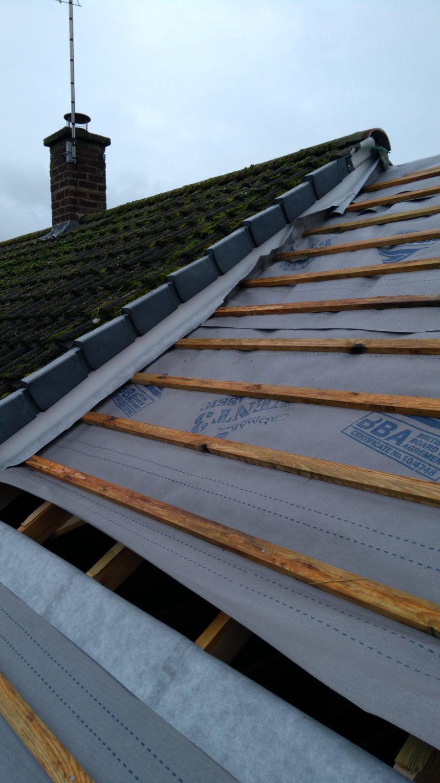

Been doing some of my extension roof today, and at the front the new roof sits below the existing verge by about 200mm. My plan is to do code 4 lead flashing tucked around the existing barge board and dressed down onto my new tiles (Anglias)
The existing is a dry verge which I was planning on removing and then putting back once the lead is in place.
I have felted and battened the new roof and lapped the felt about 200mm up the existing barge board.
However I've not touched the existing roof and I'm now wondering if I also need to strip some of the existing roof along the verge and put new felt in lapped down onto my new felt. I had assumed I didn't need to (existing felt is quite recent and good condition) but I'm now thinking I should make the whole thing continuously felted? Hope the question makes sense and any thoughts appreciated!
Cheers
John
Pic attached, I've lapped the felt up the barge board a bit but I don't know if I need to also strip and re felt the existing verge

As far as I can tell racking my brain about this I think I should be ok, as long as the existing tiles are ok ... But would welcome any advice as this is a pretty common arrangement for an extension so hoping others who've done it can comment
No.
Leave the new membrane up the wall and run the flashing up the gable to be covered by those plastic verge covers and thats it.
You just need to secure or seal the top the flashing to the wall.

Yeah but in this case it'll be Tucked over the top of the existing barge board, should I trap it under the battens for security?
if you can get it under the battens of the old roof all the better. If the verge caps are coming off, why not take off the barge board too and flash up behind that.

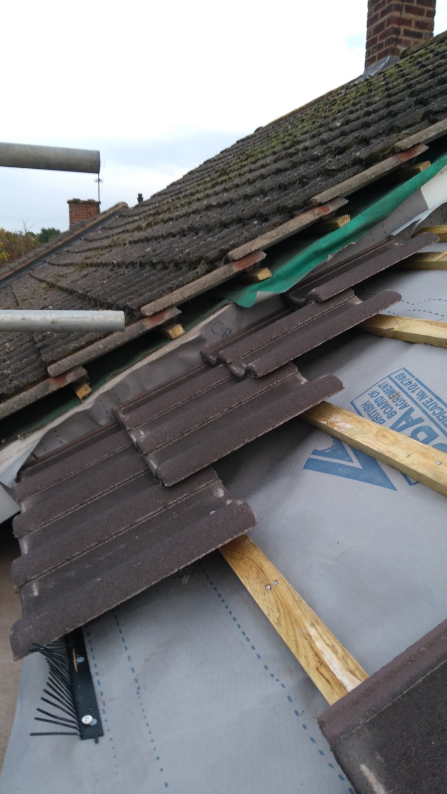

Picture with dry verge removed
So plan is lead tucked under the battens dressed down the white board and onto the new tiles below
Catlad Fair point about the dry verge not being water proof, but if water gets behind it then surely it would run out the bottom of the verge cap and down the lead on the outside so we're ok
But if the above is wrong then I could do a mortared verge
