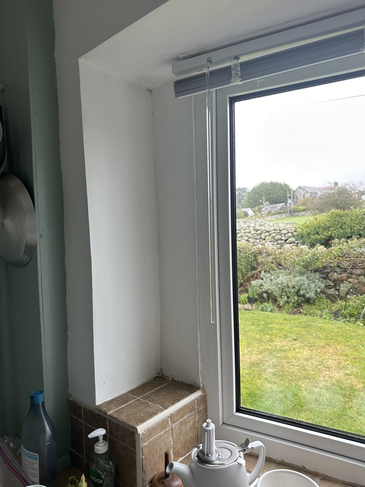

I have realised what looks like an open to one side alcove shelf at the end of my long kitchen window could actually be missing brickwork as the exterior wall attached to the window measures only 95mm! Would filling the gap will concrete blocks or standard brickwork be the answer??? I’m sure it needs some kind of damp proof barrier between but I’m unclear how/what. Any advice please?
It looks to be an older solid brick or stone wall, if it's not damp' jut keep an eye on it. If you're concerned about insulation, you could fill whole of the vertical area above the tiled step by creating a timber frame and filling with insulation, and plasterboard over. Keep the studs off the wall with plastic shims, and use plastic plugs to take the fixing screws. Both these will reduce the transmission of damp. But at the end of the day if the rest of the room is not insulated it's not going to make any realistic difference just leaving it, and you have an alternative location for the teapot.
Thanks for your reply …but on measuring my neighbour window (terrace of 4) I can see where the same size as their window Aperture shows on my wall, but my present window is one that is narrower right to left and deeper top to bottom that original. So it doesn’t reach the solid wall on the RHS and part of wall below has been chopped out to accommodate the present window. Hence why the stone shelf is there and the RHS window frame is attached to a rendered ..who know what which is only 90mm in depth to accommodate the window frame. Is Re-bricking the gap to the window needed !????
Why brick it up? Is it causing any issues?
starting a crack in from the side and concerned about what is underneath the render that filled the gap..sounds a bit hollow…concerned it might just be wood.

Take a look. See whats going on behind the render i say.
No, as the upvc window is presumably properly secured to section of the wall abutting it.
And if the joist/ beam supporting the wall above the window is adequate in terms of size and bearing

thanks for your answer…but not a box window but a bodge upvc job by someone putting in a replacement that was too small so attached a length of timber to screw the window to then covered it with render. Builder sorting it for me.
