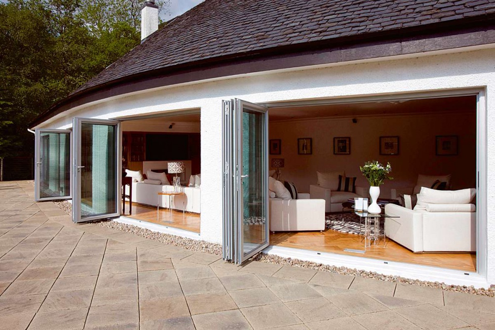

I have seen in some houses where the external floor level is the same as the internal, so basically when you step outside it is the same level.
But i am not sure how this was done because as far as i know your external ground level needs to be 2 courses (150mm) below your DPC.

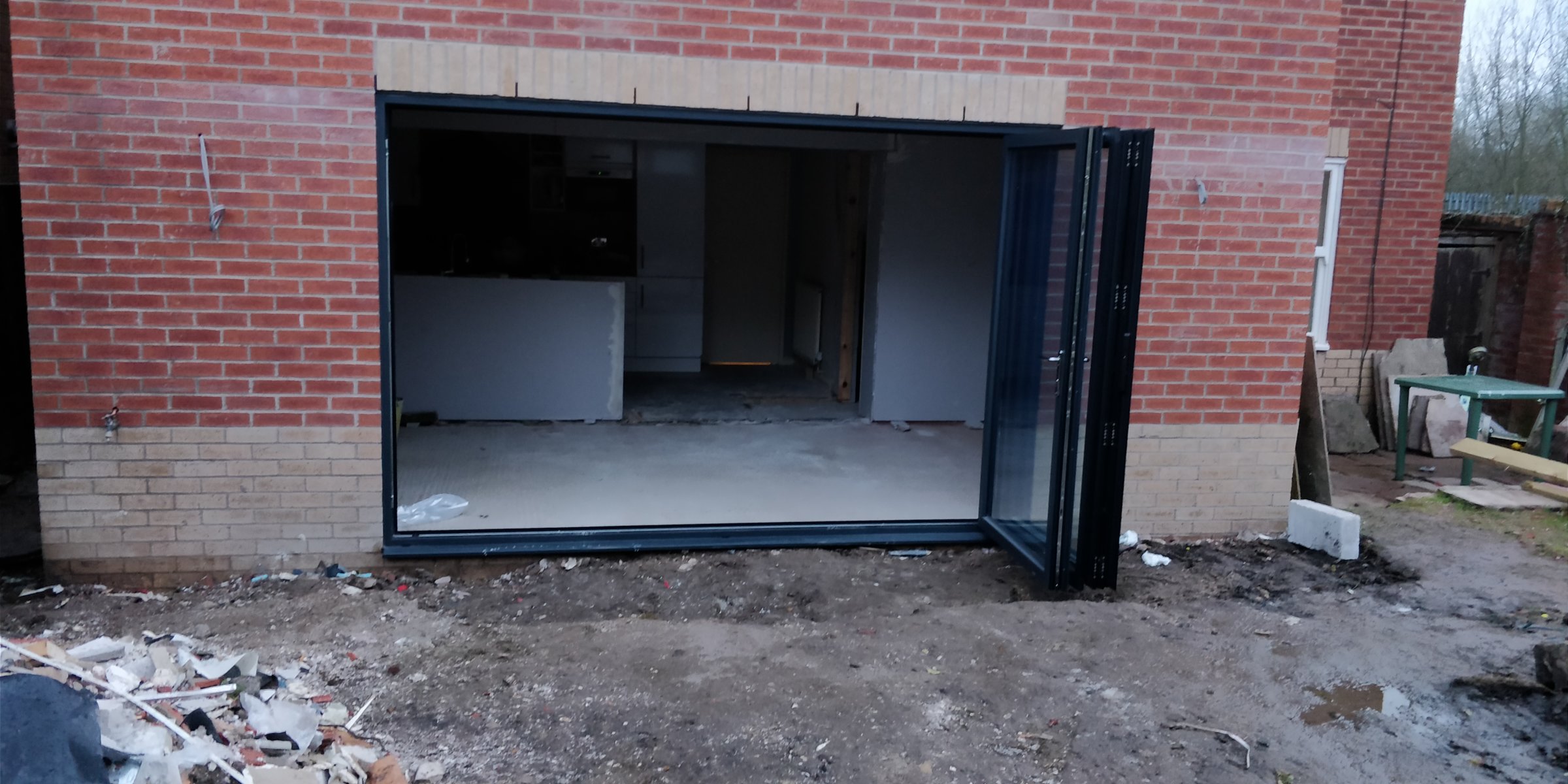

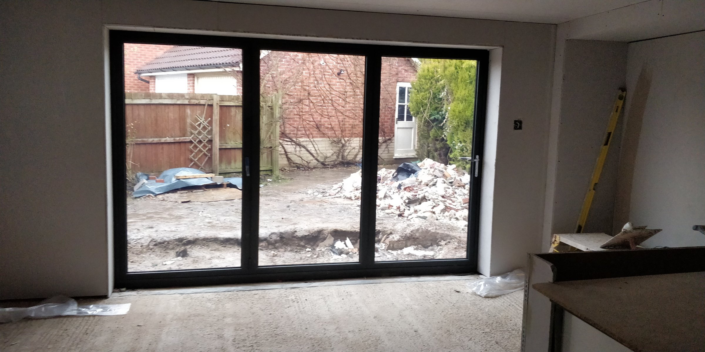

My extension has basically eaten into a part of the garden where it was a higher level so either i need to have the rest of the garden leveled out to match that height (will then require alot of digging and soil removal) or i find a way to try and keep it the same level and save the time+cost of having to do all the digging etc.
my garden/patio currently:

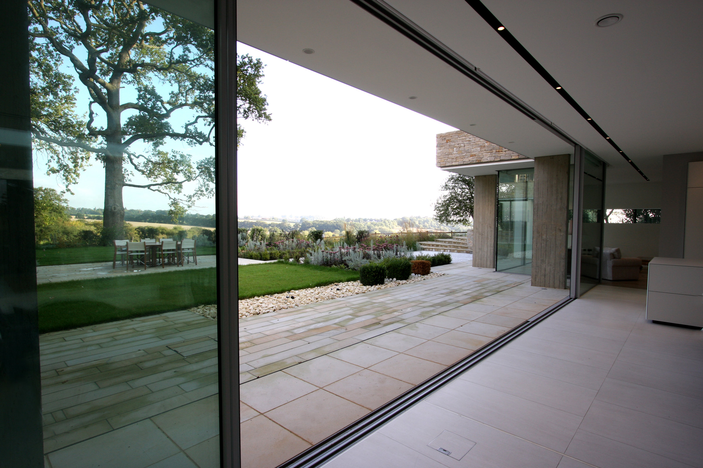

and ones that have same internal/external floor level.

You can do level threshold, you will need a level threshold aco surface drain.
Googke threshold drain, there are various options
I have similar, and left a 200mm gap between the house wall and a dwarf blockwork retaining wall supporting the patio (except of course at doors where it meets the house). Ensure the patio falls away from the house, and you have appropriate drainage. Paving Expert website is a great resource.
