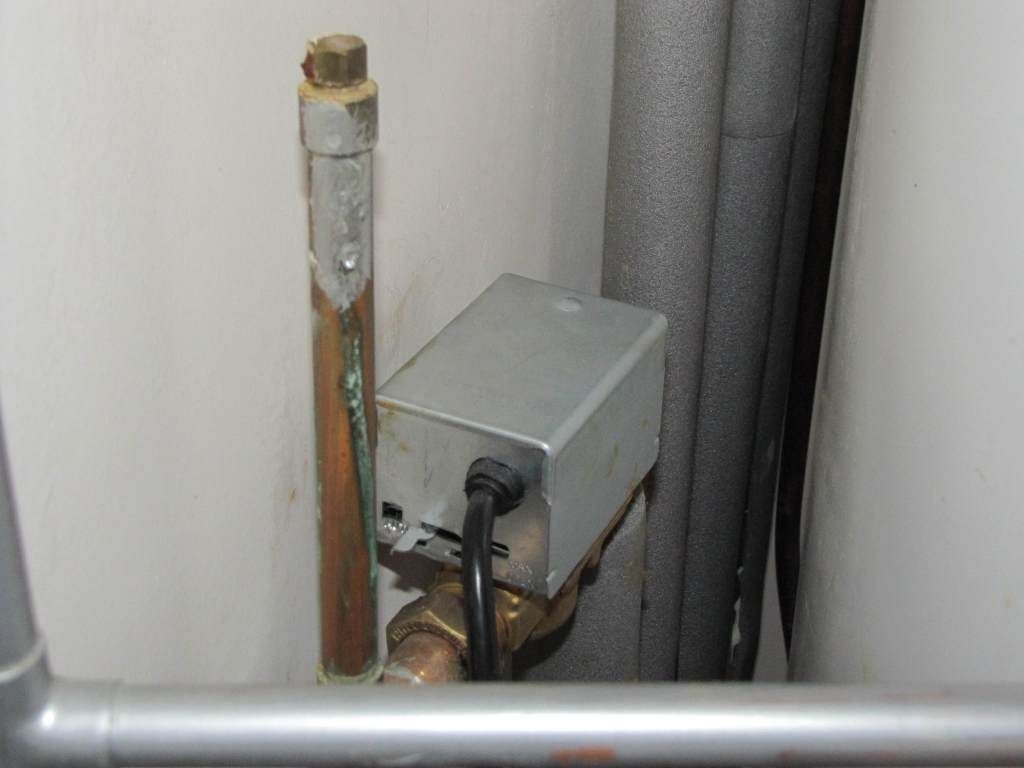

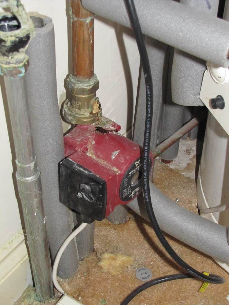

Long story short...boiler is 6 years old...brand new barratt house. Lastnight my wife came running downstairs saying the cylinder was buzzing. I went upstairs and noticed it was coming from a silver box, which I now know to be the 2 port valve. What is does I havent a clue however it was extremely hot and buzzing loudly. To stop the buzzing I just turned the heating thermostat off and this did the trick. It doesnt appear to buzz when running hot water.
Upon closer inspection tonight it appears more damage is on or around pipes. Whether this was related to something lastnight I really dont know but I do fear something has gone wrong somewhere.
I have taken pictures below showing the damage I mean along with the offending part. I would be really grateful if someone could offer a dumb mans explanation along with abit of advice. I am thinking and hoping just get a plumber in to fit a new 2 port valve but the extra damage is what concerns me the most.

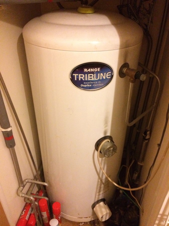

First is a pic of the cylinder -

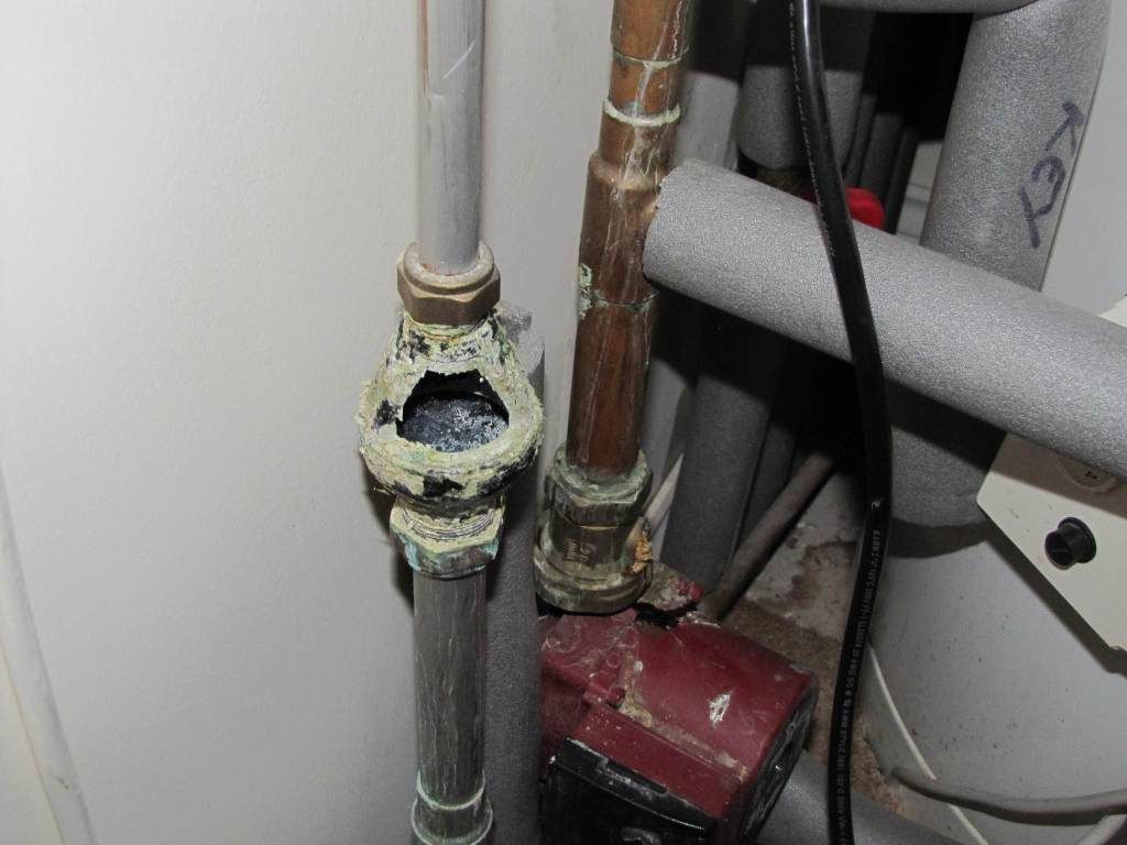

Next the offending part (also note the pipe in the background with all water damage)

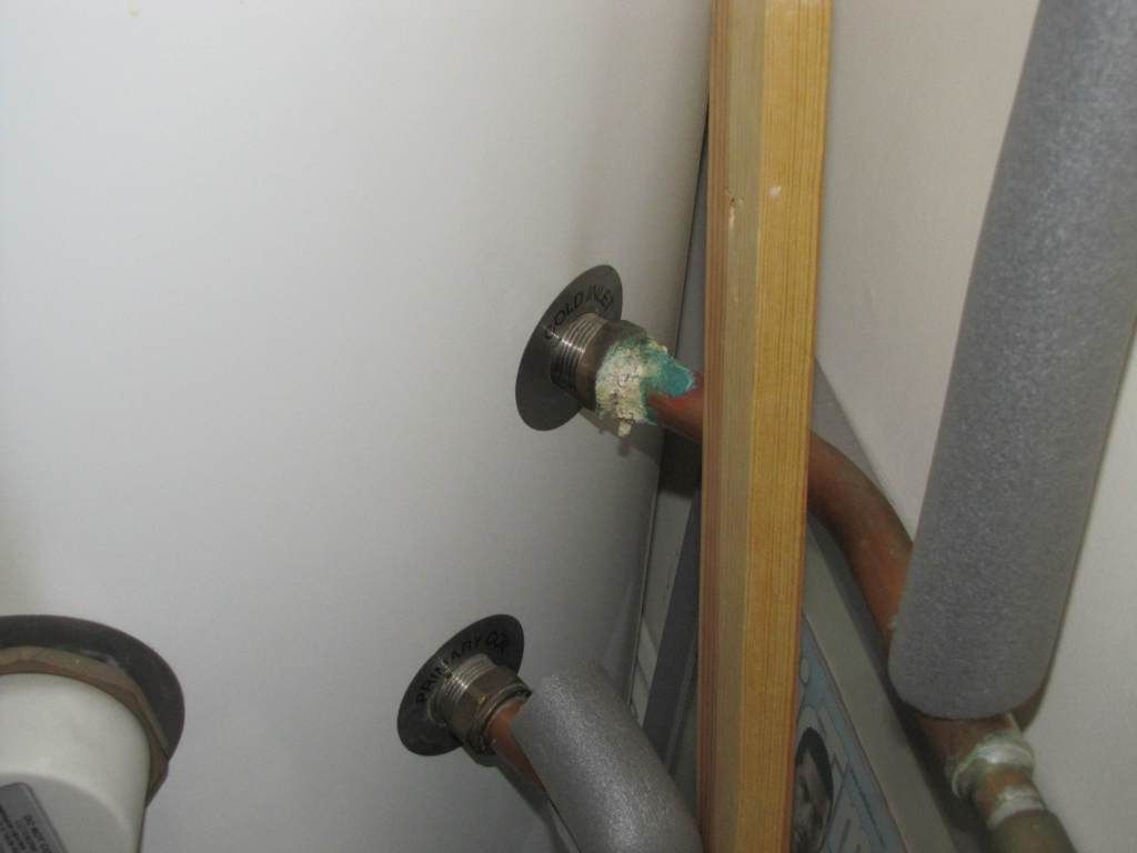

Next is what appears to be an old leak from the cylinder
The rest are just water damage which I am pretty sure shouldnt be there surely?
I cant feel any damp or water anywhere so I would have thought if this water damage was anything to do with lastnight it would still be wet somewhere? Maybe it is normal and I do infact just need a new 2 port valve (I hope so) but like I said, I know nothing lol

The two port valve you say is buzzing needs replacing. Not a big job.
Looks like your cylinder has been releasing pressure so expansion vessel
need to be checked it has probably lost it's air charge.
There appears to be an air vent that has leaked a bit so just need a new
washer.
Get someone in should be able to sort the problems out.
Make sure they have the proper unvented hot water tank qualification.
Don't like the mark around the tank but that could be just rust on the
outer skin due to damp rather than the stainless steel tank inside leaking.

The cruston the COld Inlet pipe (5) is mains. Pretty normal, but if you have someone ion let them check it's in properly/tight.

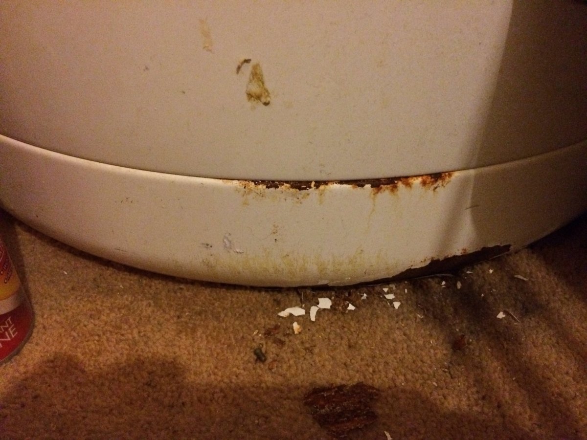

The stain round the seam inthe cylinder is not something I remember seeing. CLean it off and monitor it.
The crust round the black funnel thing (tundish) is where water has splashed a bit when the pressure has bult up and escaped. If the pressure vessel for the hot water cylinder were pumped up it should stay dry.
The leaks around the pump valves are annoying. That type of pump valve is almost always terrible. They're worth changing for better valves, which means draining the system to that point.
You need "screw down" or "gate" valves, not "quarter turn".
That would make your boiler pressure drop too.
(The cold water inlet one wouldn't..)
Some of the green marks are from the initial plumber's solder flux round the joints - scotchbrite pad will clean those off.

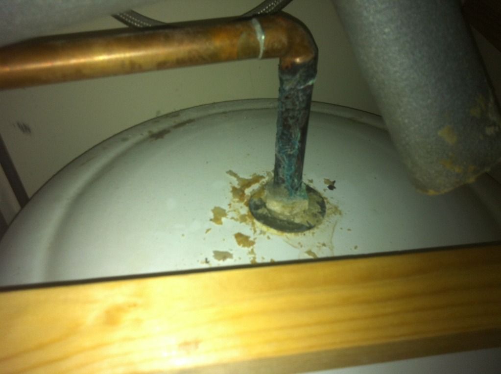

I have a guy coming out tomorrow who has the unvented hot water qualification to take a look at the problems.....hopefully it wont be too bad! Although I did notice tonight when cleaning out the cupboard ready for him that the top of the cylinder (what I think would be the hot water outlet) has also leaked at some point and is really crusty....I am hoping this is normal too? but not holding my breath! :confused:

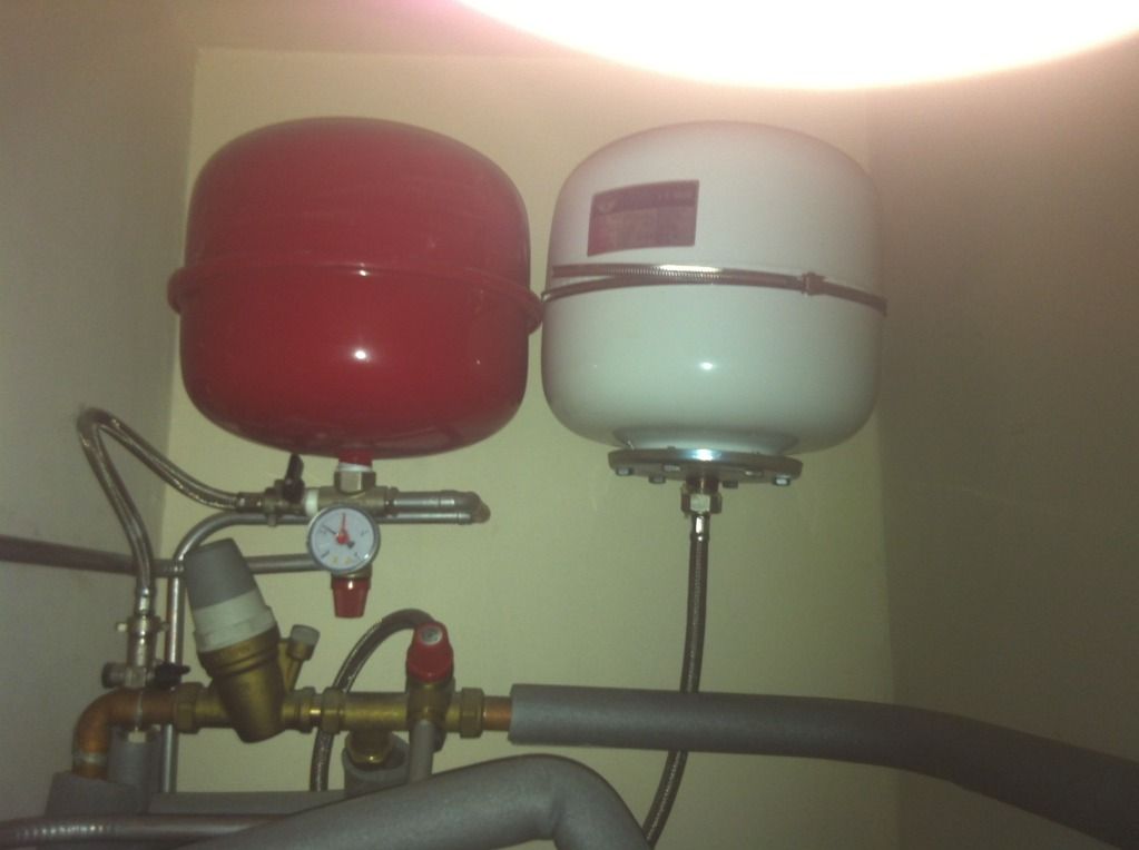

Surprised no one has mentioned the shocker that is the safety discharge pipe on the TPV?
Can't see the pressure reducing valve or where the expansion relief valve connects in either?

Just while I am here aswell I just thought I would post a quick pic of the hot water outlet damage....what could have caused this? It isnt leaking or anything now but clearly has done :eek:
Also the expansion vessel which has no visual damage or anything.
Upon reading up alot more on these systems I dont think I have a leak in the system anywhere as the pressure doesnt drop as often as what literature states it would if there was a leak. What I have experienced is normal pressure loss I think. Have I just over pressurised the system or something to cause all of these apparent leaks?

I have a Range Turbine Boiler and have noticed this rust patch in the lower seal. I have scraped some of the paint off. My water is also always boiling hot so on advice I removed the cap to the lower thermostat and it was set to max so I reduced the temperature but its still hot, this is when I noticed the rust. Do I need a new stat and more importantly do I need a new boiler. This was in a new build, it is 11 years old.
Many thanks.
