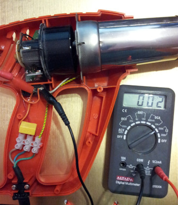

I was using my heat gun fine on max heat with a restrictive nozzle. Then I turned it off. When I tried to use it again, it wouldn't come on. I checked the plug fuse and that was fine. Any hope of repairing this?
Make? Model? If it's a decent make spares should be available, DIY tools - much less likely. The heater element is the most suspect part
You presumably don't know how to prolong the life of your heater elements after running the gun hot - you don't just turn guns off after using them, instead you turn the gun down to the lowest setting (ideally blowing cold) and run the gun for 3 to 4 minutes to cool the element down gradually before switching the gun off. You see the trades users of heat guns doing this all the time on site. I believe the cost of the element on something like a Steinel industrial gun is well north of £100, so it makes sense to baby them. Not so sure it's as worthwhile on a £30 DIY gun
It's a very old black and decker KX2000K 2000W type 2. By today's standard, it's probably a luxury model worth £500 because it has (I believe) an analogue heat dial. The cheap guns I see now only has 3 heat settings.
I have measured the resistance across the switch and it's fine ON or OFF.

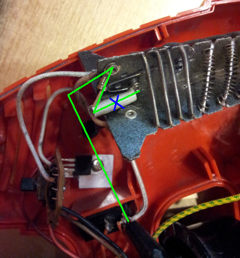

The continuity of the element looks OK. Nothing broken and no burnt marks anywhere. Green indicates the path from the switch to the element. X marks a shielded object that does not have continuity across it. Any idea what that object is and is it supposed to have continuity?

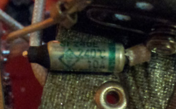

I am guessing the shielded object is a heat "fuse". It's blown from the heat and the heating element is now permanently disconnected.
The thermal fuse is SF240E. £2.7 for a pair including crimps on ebay. Expensive but cheaper than a new gun
OK, got the gun back in action. I cut out the fuse and bridged the gap using a 13A wire. This allows me to use the gun while I get the fuse replacement. Thermal protection is on manual. So, the gun is not kaput after all.

How do you propose to connect your new fuse into the heat gun?
Soldering it will likely make it fail and the solder may melt in use.
They are generally riveted on.
The old fuse was fairly loosely clamped on by rivet on one side. This side could be replicated using a slight force. If this fails, I can simply unwind the wire going to the element from the rivet and crimp the new fuse onto that. The other side was crimped on by a mini ring crimp attached to a rivet. Since I left a large part of the old fuse wire in place, I can splice crimp the new fuse onto the old wire. I believe the exposed old wire was intended as a temperature conductor.
