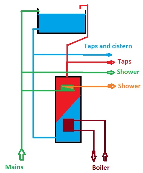

Vented cylinder with heat only boiler
Is my choice. with a shower coil in the cylinder for hot water to the shower.
A system boiler has all the pumps and valves etc crammed into the case, difficult for access and repair.
A tank of cold water in the loft gives more than enough constant pressure to supply taps and cistern without the problem of fluctuating mains water pressure
Edit withOUT the problem

@bernardgreen in your diagram why are you supplying the cold water taps from the header tank rather than directly from the mains?
because the taps and toilet cistern are operating at low pressure which prolongs the life of the valves and means they are silent in operation,
Do you drink from the tap? I guess if your header tank is clean and well sealed then the water quality is about the same as what you get through the mains

@bernardgreen didn't know you could get cylinders with a separate coil for a mains fed shower.. I guess the difference is you get a nice powerful shower? Is the shower hot water a high temperature with that set up? I imagine it's not as hot as the water for the taps
Ours wasn’t! Before we went unvented, every time the loo was flushed or the bath/hot water taps were used, we could really hear the cold water tank filling up in the loft. Our bathroom basin tap has always been mains fed. Since we’ve been unvented - perfect!
