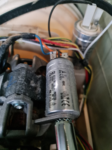

Update- it looks like the capacitor on the motor is faulty. With the lid off, I selected a program and as soon as the buzzing started, I pushed the drum and it started spinning.

In the video, the guy does say that Hoover/Candy don't sell the motor capacitors. I visited a spares website and searched for a new capacitor. It was £18 (plus postage).
It wasn't until I started to dismantle the machine that I discovered that he was indeed correct. I had accidentally ordered the capacitor for the heat pump and not the motor.
Knowing that she wot scowls at me would not be happy about the machine sitting in bits in the middle of the kitchen, I popped down to Capital Repairs in Raynes Lane to get a 7μF capacitor (if you live in west London, I strongly recommend them- helpful & knowledgeable staff and competitively priced). They tested my old capacitor, confirmed it was dead and then sold me a replacement for a tenner.

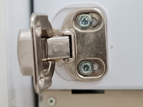

Taking the machine apart- the first hurdle was that the kitting fitters seem to have used an impact driver to fit the (integrated) door hinge screws. They were completely stripped.
I used TCT drill bits to drill the screwheads off.

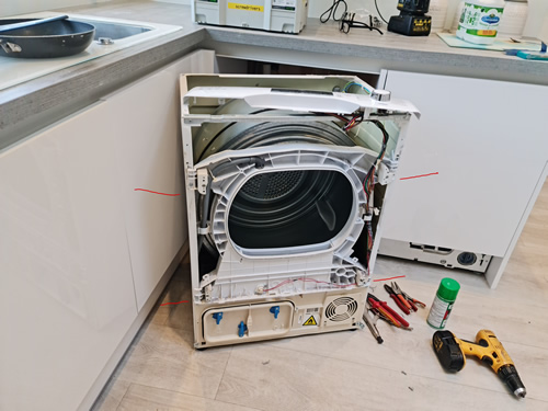

With the hinge arms removed, I was then able to open the tumble drier door fully and remove the two torq screws. The only screw on the front metal skin that doesn't need to be removed is the door lock sensor.
This is what it looks like with the front skin removed.
The red lines show you which four screws need to be removed.

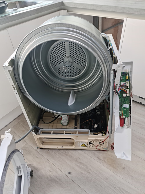

Because of the quality of construction I had to use a block of wood and hammer to tap up the bottom right of the plastic front. The invaluable youtube video recommends removing the drum. I undid all of the retaining screws, and then discovered that the drum is too big to remove. I tried to twist it and pull it forward- no joy. I then removed the metal L profile bar at the top, still no joy.
In the end, I used a plastic paint kettle to lift the drum up
With the drum lifted, I could see the motor.
The capacitor in the background is the one that I purchased in error. The one in the foreground is the motor capacitor.
