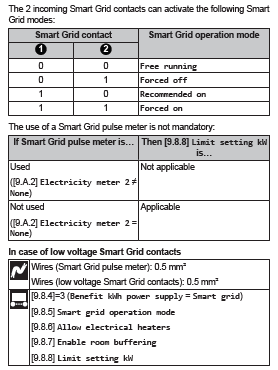

So I've read the manual and looked through the settings. One setting is called kW limit. It was set to 2kW. I guess this is the max electrical power it will use. On a cold day with a CoP of 3, that limits the heat output to 6kW. Even on a mild day where you'd expect a CoP of 4, that limits the heat to 8kW. I've set it to 5kW. We'll see in the morning how much difference it makes.
This setting?
Sounds complicated. This is from the manual for a different model, but gives a bit more detail. Might be helpful?
I've found the setting you meant now! Please ignore the info in my post just above.
