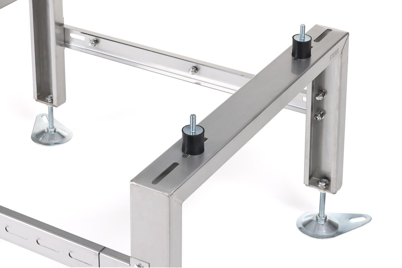

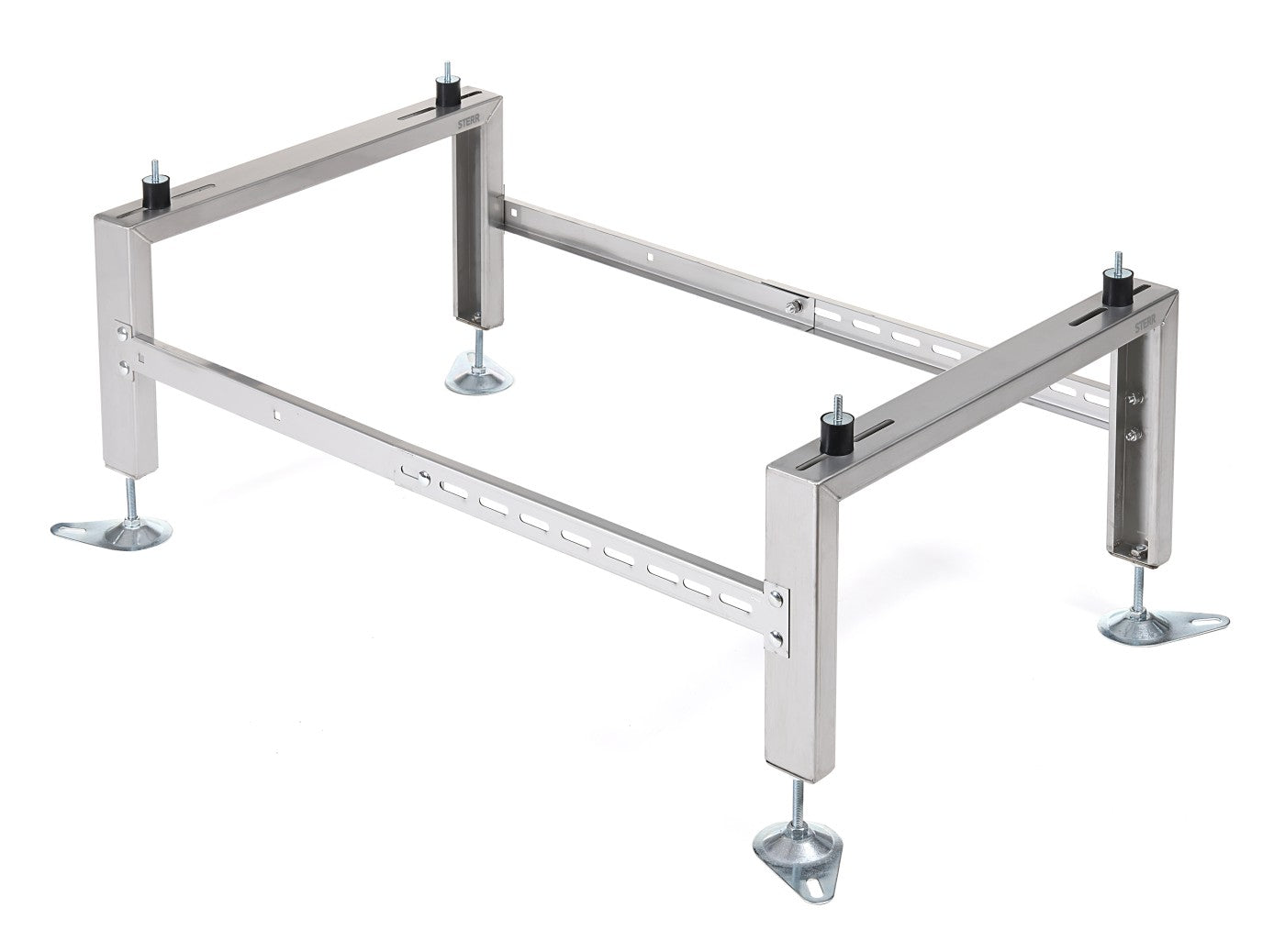

Unless anyone's got any better ideas I'm going to slope it and buy one of these...
This has loads of adjustment in all four feet, so I can do what I like with the base then make the stand precisely level.
The advantage is that I can then make the slab the same height as the surroundings, it doesn't need to be 5cm higher as the stand will make it lots higher. It definitely won't get covered by a snowdrift or immersed in ice on one of these. Also it won't get splashed from the rain or condensate landing around it.
It looks a bit industrial, but so does an air pump. It's round the back of the house so doesn't matter.

That Sterr stand has rubber feet under the heat pump, it's designed for the job. Think higher is probably better, keep it well out of the way of blowing leaves and muck, mice, snow, ice etc. Possibly also better for airflow.

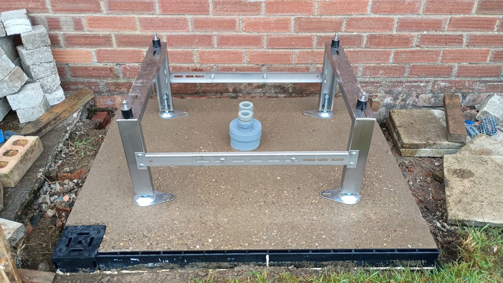

I'll surprise them with the stand on a concrete base with a drain, already fitted with the bolts ready for the exact dimensions of the heat pump.

Just an update to say the Sterr heat pump rack has arrived and it's an amazing bit of kit. You can't appreciate from the photos just how solid it is, all stainless, welded corners, totally adjustable in all directions. An absolute bargain for just over £100 delivered.
So I can now make a surface that drains AND have a level heat pump AND have it higher off the ground, which is bound to be good for airflow and for keeping the muck and mice away.
The mounting standoffs are 30mm wide solid rubber anti-vibration rubber lumps with an M8 thread sticking out of each end. They look tiny in the photos, they're not.
It doesn't include nuts for the heat pump mounts, I've ordered various stainless M8 nyloc nuts, 30mm washers, spring washers and M10 stainless expanding bolts from ebay for £16. So that's about £120 all-in including everything to bolt the heat pump down and bolt it down to the concrete,
A few mixer loads later...
Base will be adjusted, levelled and bolted down once I know the exact make and model. Got a central boss for direct connection of a drain pipe, plus the channel for anything that dribbles off the edges and the rain.
