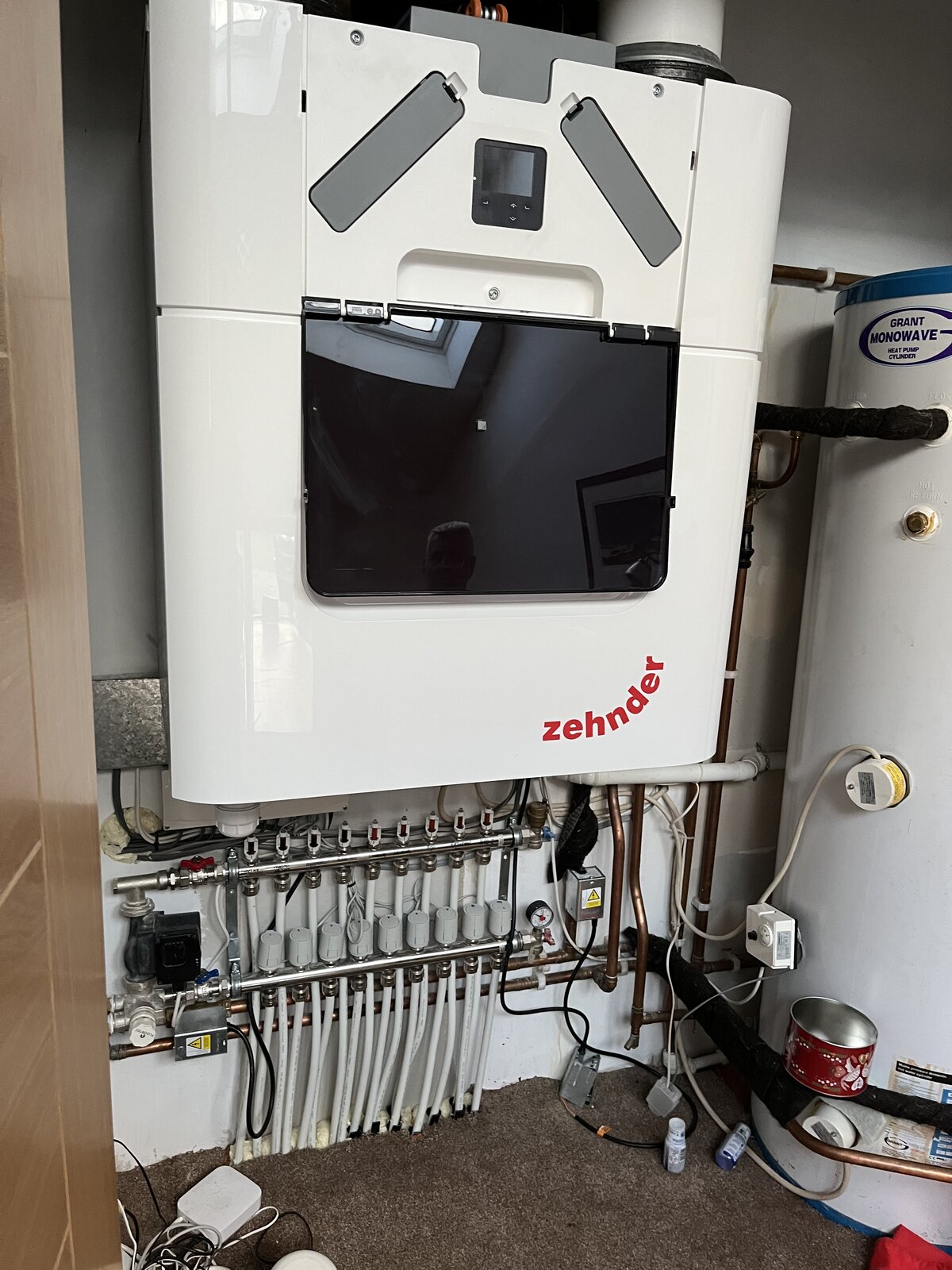

If you actually have a heat recovery system it wont be hard to find they are larger than a gas boiler and will have 4 x 100mm pipes coming from the top and a condensate pipe fitted
Air source /ground source is a completely different thing , here is a pic of one, there are other makes but all similar in size
