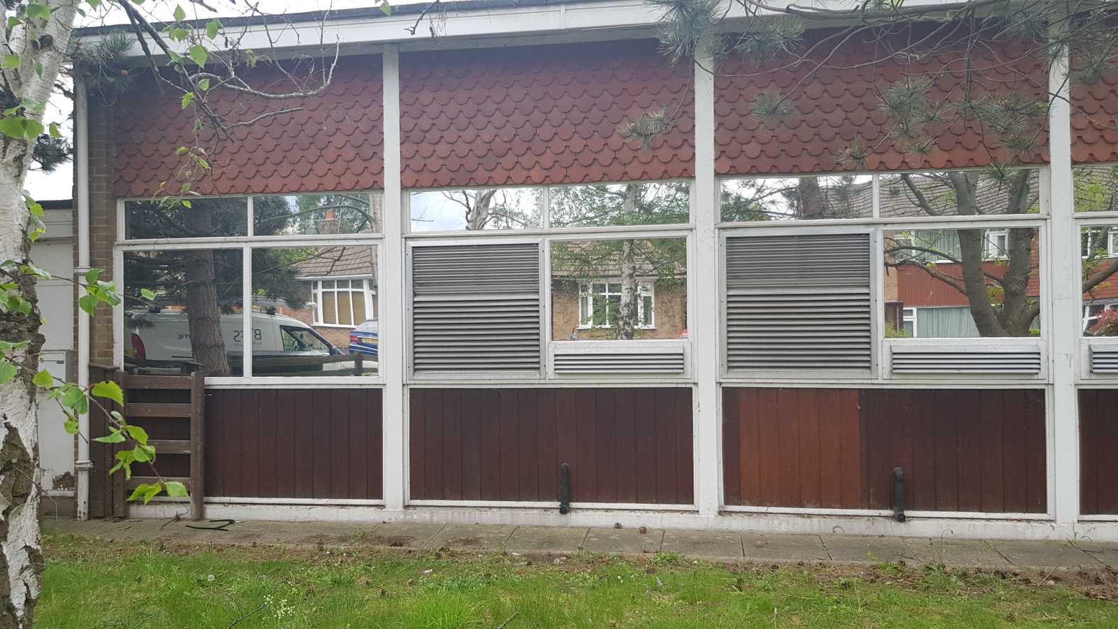

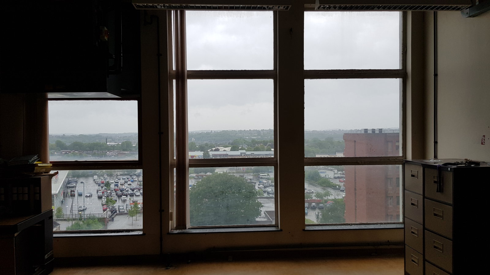

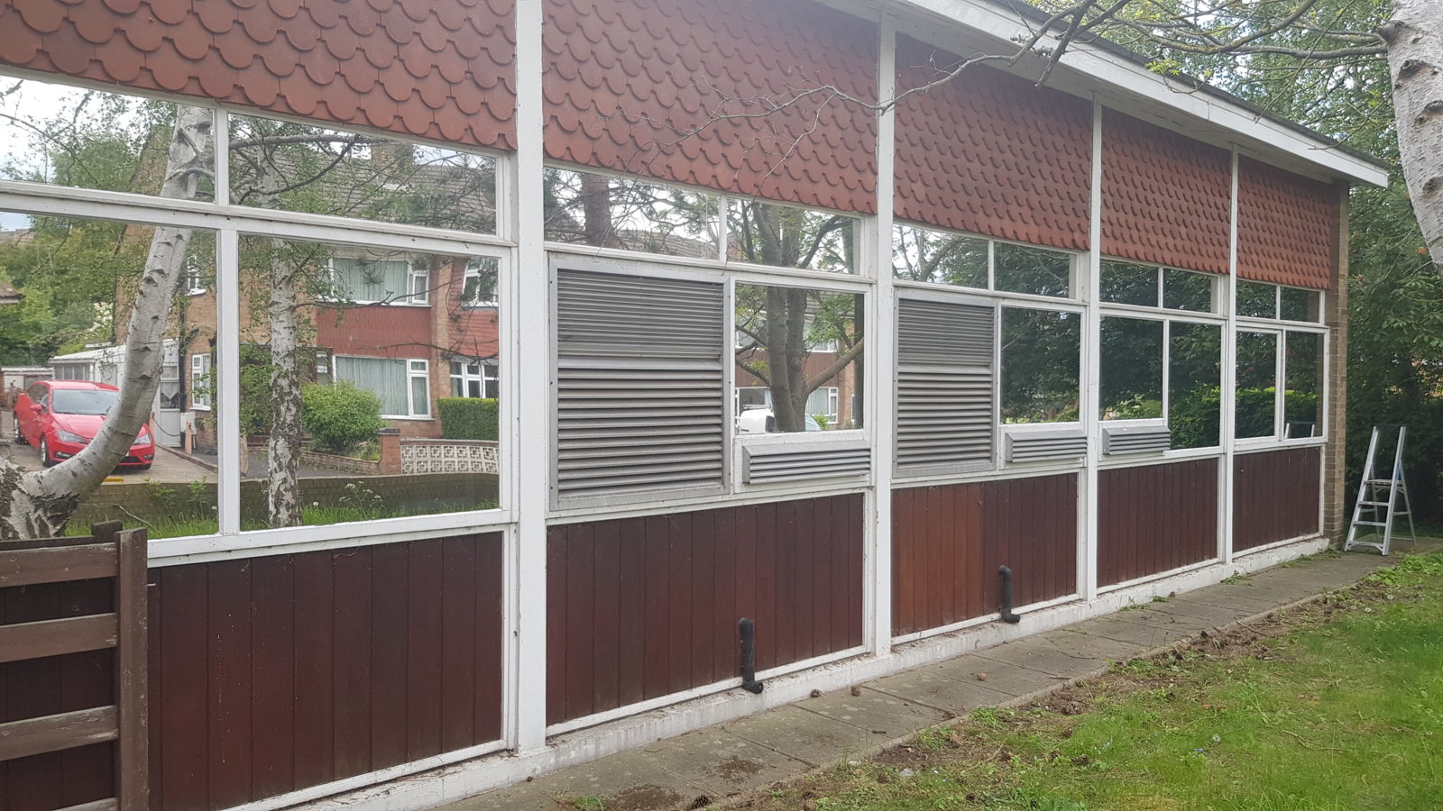

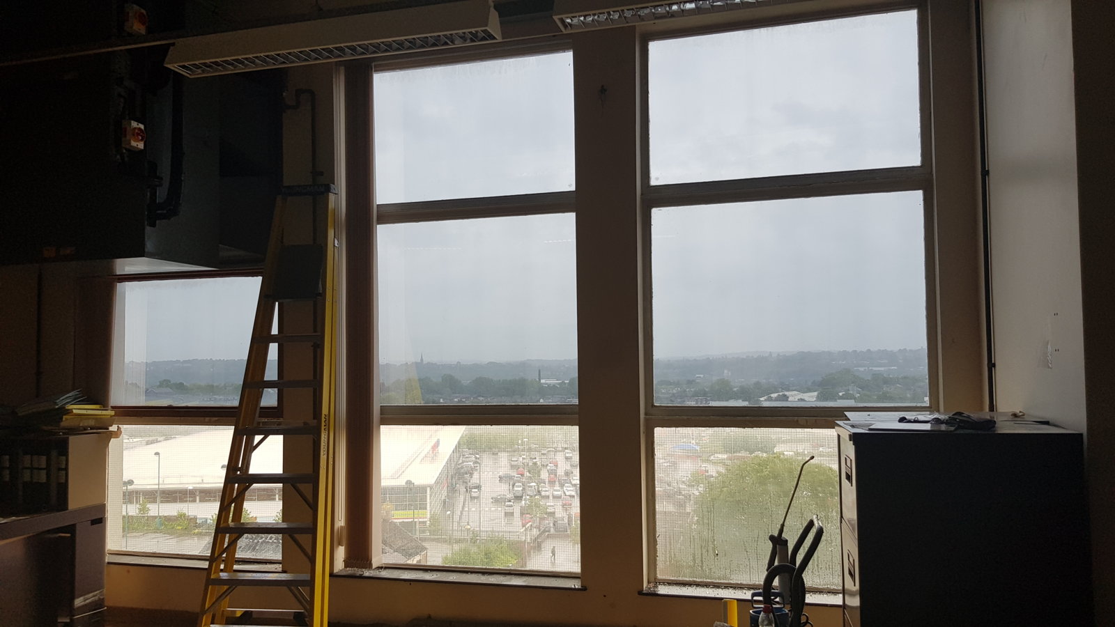

Im currently fitting a shed load of solar control 20 across roughly 2000 BT exchanges to keep the heat down along with upgraded air con, should keep me busy for the next few years
We buy our film from Arc Films up in Wigan but theres others, stock films is another, both would be happy to ship to you, also try ebay and buy by the metre. Quality wise look for a film that has real aluminium reflective foil NOT the cheaper end of the market dyed stuff, will last half as long, quality films are guaranteed for 10 years now
