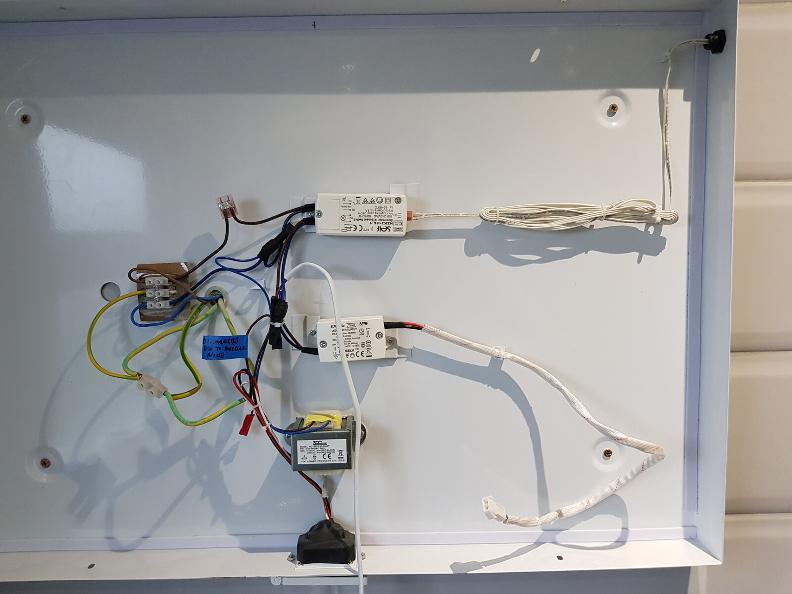

Hi,
I have a heated and LED lighted bathroom mirror with integral shaver point, however the shaver transformer buzzes.

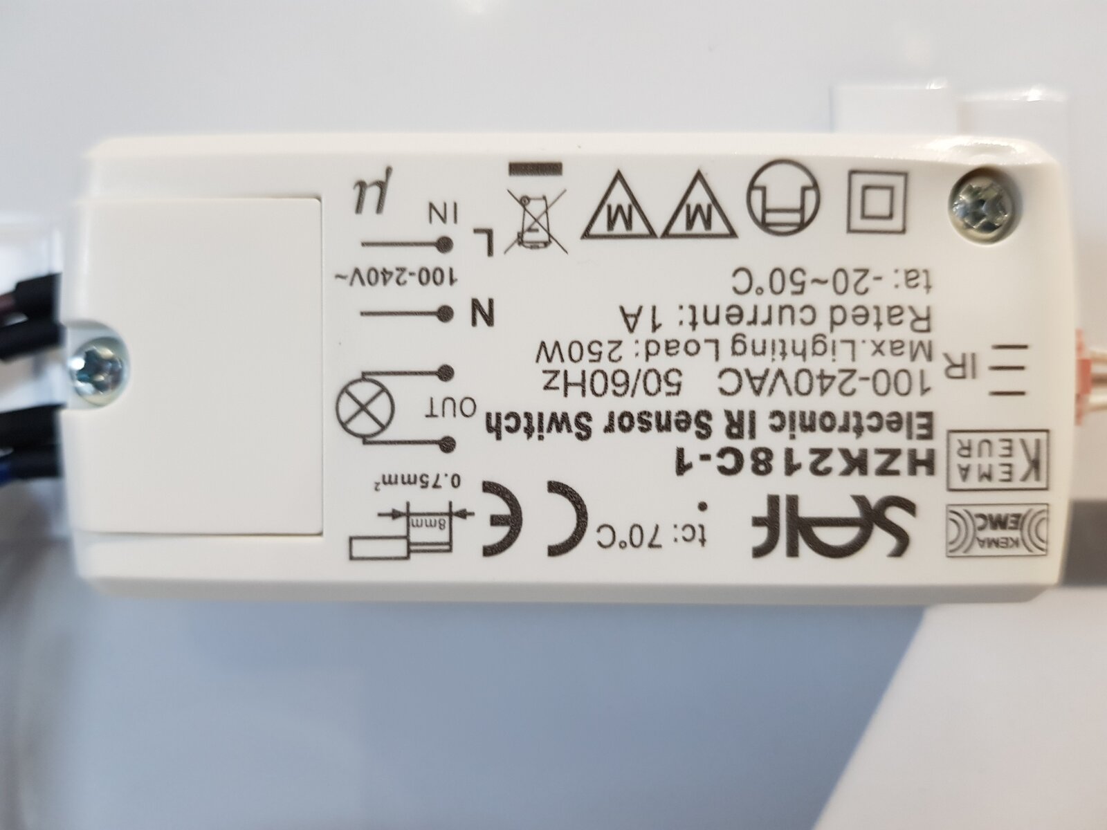

The LED and Heat pad are controlled via an IR sensor switch. On the switch control box inside the mirror it says:
100-240VAC
Max Lighting Load: 250W
Rated Current: 1A

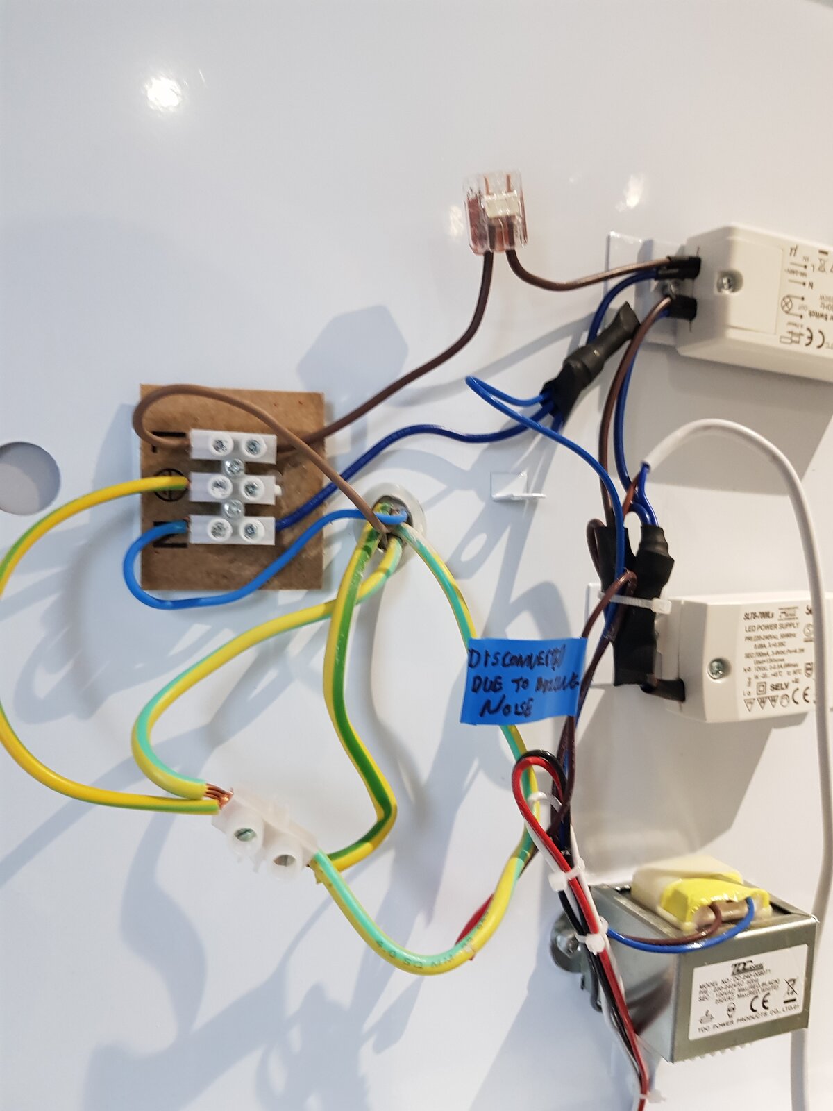

My question is, can I alter the wiring inside the mirror (which I'm fine doing) so that the Shaving Transformer comes on with the LED lights and Heat pad via the IR switch as opposed to it currently being on permanently? I have disconnected the live feed to the Shaver Transformer for the time being as the buzzing noise is annoying given the bathroom is an en-suite.

Thanks, but my question is whether I can utilise the existing IR switch?
The problem will be if you want to charge a shaver you will have to spend 8 hours waving at the IR switch.

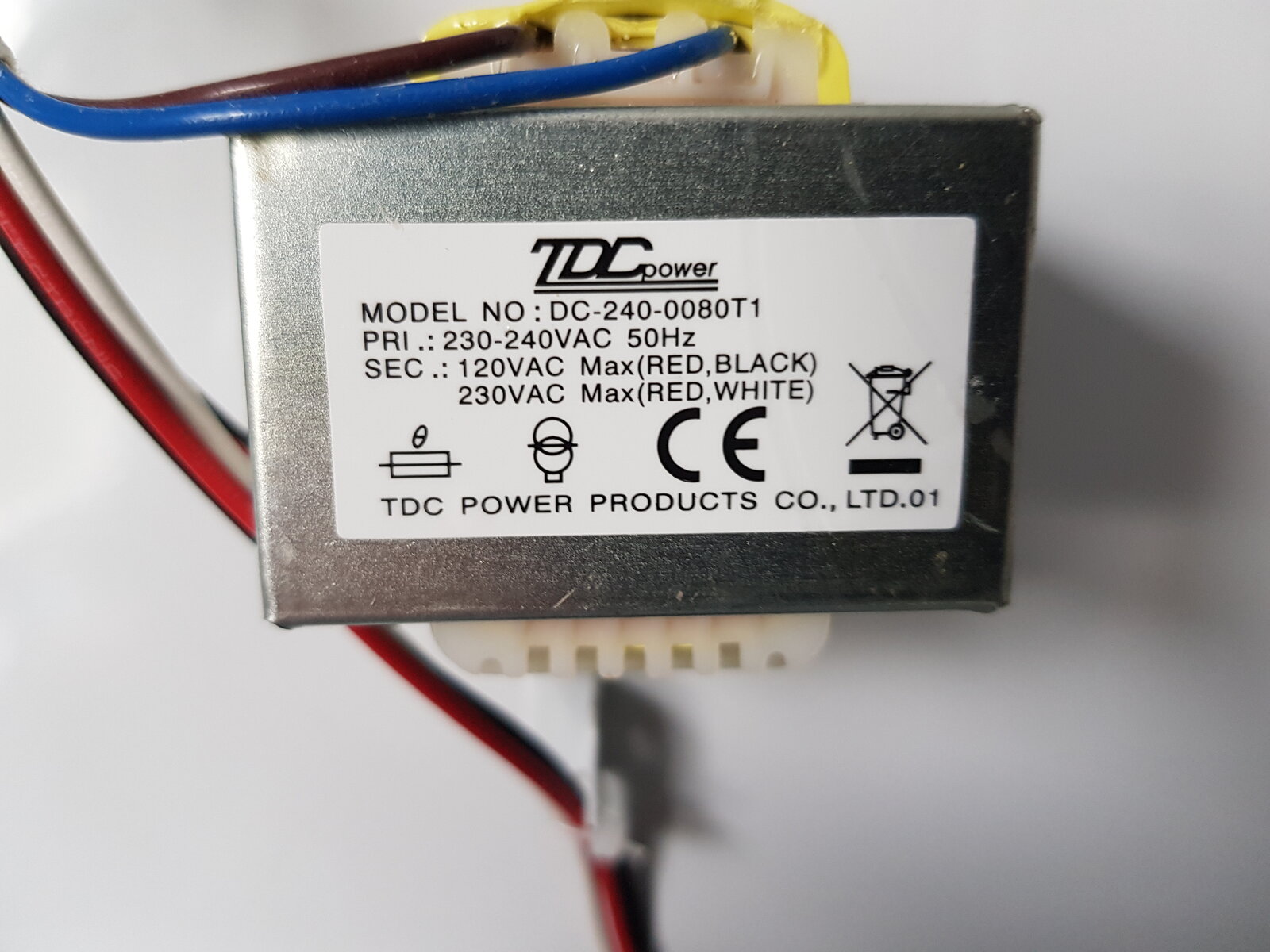

I looked for spec on that transformer
Bathstore TDC Power Transformer DC-240-0080T
Input Voltage: 240V
Frequency (Hz): 50
Power Rated (W): 28
Exciting Current With No Load: 80 mA Max
Exciting Current Full Load: 140 mA Ma
Output Voltage: 240 Volts +-10%
Output Voltage Without Load: 250 Volts +-10%
Output Current: 0.08 Amp Max
The maximum to comply with British regulations is 20 VA so this transformer does not comply, and with most shaver transformers putting the plug in the socket actually switches on the transformer, it should comply with BS EN 61558-2-5, there are some older specs BS3052 and BS4533 but I would think that mirror is not suitable for the bathroom.

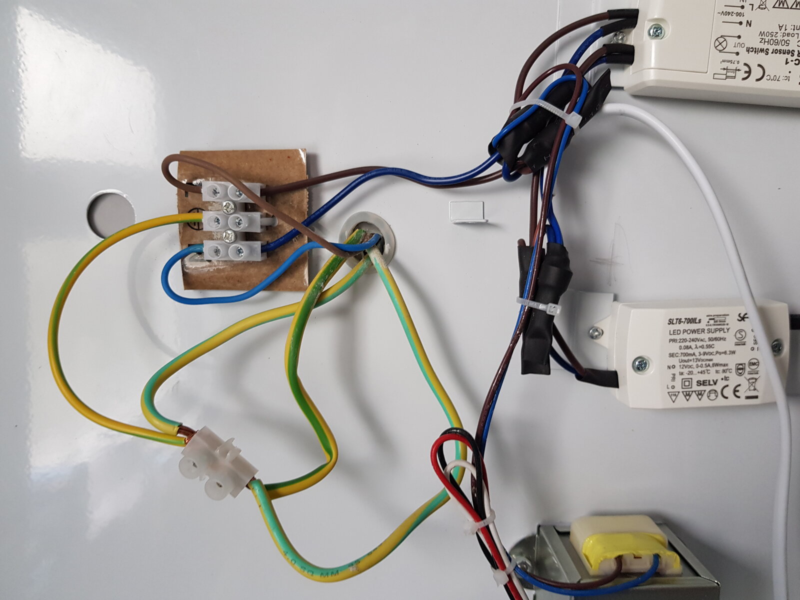

The mirror is fine and I am confident in my abilities to re-wire the isolating shaver transformer to the mirror's infra-red switch (currently used to turn on and off the LED lights and demister heat pad) BUT am not sure on whether this would be OK mainly due to "Back EMF" associated with transformers. Could this damage the IR switch? If Back EMF is a general issue, then how do other types of Shaver Sockets with manual on/off switches or built in switches that are operated by the insertion of the 2 pin plug get around this?
In the main nothing is done, a surge protection device would help, but in the main nothing. In the main a micro switch activated when the shaver plug is inserted is used, it has caused problems as clearly a shaver is only used for a very short time, but this is not the case with rechargeable items, also one tends to hold a shaver in one hand and plug in with the other, so no risk that the shaver will fall in the sink, items being recharged can fall in the sink.
An isolation transformer means the RCD will not work, so tooth brush falling in sink will not trip any RCD. It is also unlikely to cause a problem as no earth path, but most shaver transformers are intermittent rated and not designed for tooth brushes, so in many ways what you have is better than the proper shaver transformer.
So all I was doing was giving you reasons why you could return it. But some times the non compliant items are better, I am using 5 G9 bulbs which are non compliant and far better that compliant bulbs as have a smoothing capacitor built in.
