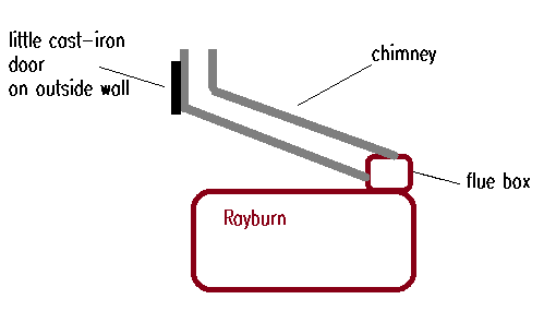

To demonstrate what I mean (you must all know by know I love doing my little diagrams). Brace yourselves:
This is the view looking at the Rayburn from inside the kitchen (I have no idea what this sort of chimney arrangement is all about (!) but it is what it is):
And this is the view from the outside wall:
We don't know the route from the door into the main chimney breast as we can't see that, but I'd guess it goes up diagonally to meet the main chimney?
Anyway... a big no-no for solid fuel, or ok?
