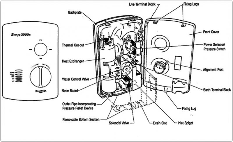

Hello all.
What part is needed to control my temperature on my shower please?
The shower has a High, Medium and Low setting but when I select Low, the shower indicates so but after a few seconds, all three lights glow and the temperature rises to what can only be the High setting.
To combat this I have to turn the dial up to High, wait for the 3 lights to go off and 1 come on indicating High. The I have to turn down the temperature but stop it between Medium and Low to obtain the constant Low temperature. If I let it click into Low then the above is repeated.
The Medium and High setting are fine and stable but obviously to hot for use this time of year.
The shower is a Gainsborough Energy 2000x.
Hope you can advise.
Probably the selector switch, but given the age of the shower, it is probably not worth repairing.
If the water really is too hot, the flow rate is too low, probably due to limescale or other blockage, or the water pressure to the unit is too low.
The heat settings select which of three elements are powered, the other knob controls the water flow rate which also determines the temperature.

I have included images of the shower to help in the opening post.
I can't afford a complete new shower, plus this shower runs on a thicker electrical cable so a shower compatible to the cable would be more expensive than just buying a simple shower.
I know the website as I have bought from them before but I not sure exactly what part to replace (if available) please?
The grey rectangular item next to the white circular knob is what's known as a microswitch. These are standard sizes usually and picked as component for consumer electrics. It may only be for the on/off function though rather than the elements, so that's something you'll have to determine.

I would hazard a guess at the power selector/pressure switch (which is obsolete) cant see what else would cause it.
