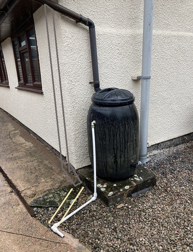

The previous owner installed this bodge of a water butt. It's very annoying as the overflow often gets blocked and water floods onto the driveway. Also, I have fitted 2 water butts at the rear of the house near the garden so I don't need this one.

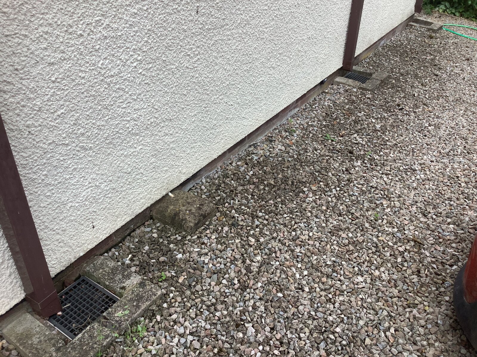

The overflow water travels several metres down a concrete gully into a drain like this:
Anyway, before I can do anything with the water butt I need to decide where to route the rain water. Is it permissible to just connect the rainwater downpipe to the grey wastewater pipe in the picture? I have a septic tank for waste water so perhaps that could end up flooding the septic tank or forcing me to have the septic tank emptied regularly?
Or I could fit a rainwater downpipe that runs to the concrete gully. It would still look a bit naff but would work more reliably than the current overflow.
Other ideas welcome. I'm struggling to understand why the builder didn't provision a rainwater down pipe when the roof was built.

The gutter above the water butt is 7 feet high. The nearest rainwater down pipe is 31 feet away so it’s not going to work and/or will look silly trying to connect the two. Also there’s a greenhouse in the way.
I'm thinking of removing the drainpipe, butt and overflow and adding a downpipe (grey lines) and extending the concrete gully (yellow lines). This will look neater and avoid the trip hazard and will direct the rain water to the nearby rainwater drain.
It's baffling that someone fitted 5 downpipes around the house that look great and flow into the stream, but in this section they fitted a gutter that doesn't lead anywhere. I'm suspicious about what was done when the butt was fitted. Perhaps there's a rainwater drain under the stone plinth that the butt is sat on?
It does seem the most likely explanation @robinbanks I can’t see why someone would install guttering on that section of roof if there was nowhere for the water to go. It would have been better to just let the water run off the roof onto the concrete and down the gully. So (like you) I suspect the gutter and down pipe were correct and then some idiot tried to fit a water butt, but completely misunderstood how rainwater diverters work and bricked over the drain!
