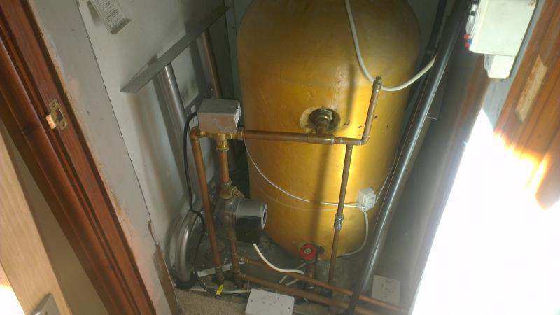

The hot water tank/programmer is in an airing cupboard that can only be accessed through one of the bedrooms, which is the bedroom that will be the new nursery. So, the main idea behind the changes, is to allow us to make program changes without having to go into the airing cupboard through the bedroom! And hopefully to get a more reliable thermostat.

Heres what we currently have in the airing cupboard...

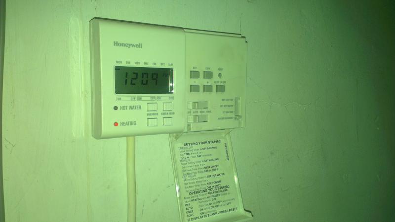

Heres the programmer....

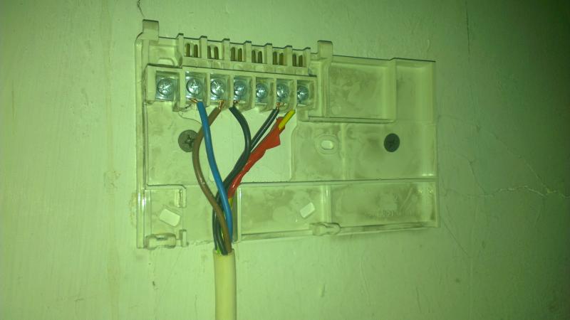

And the back of the programmer...

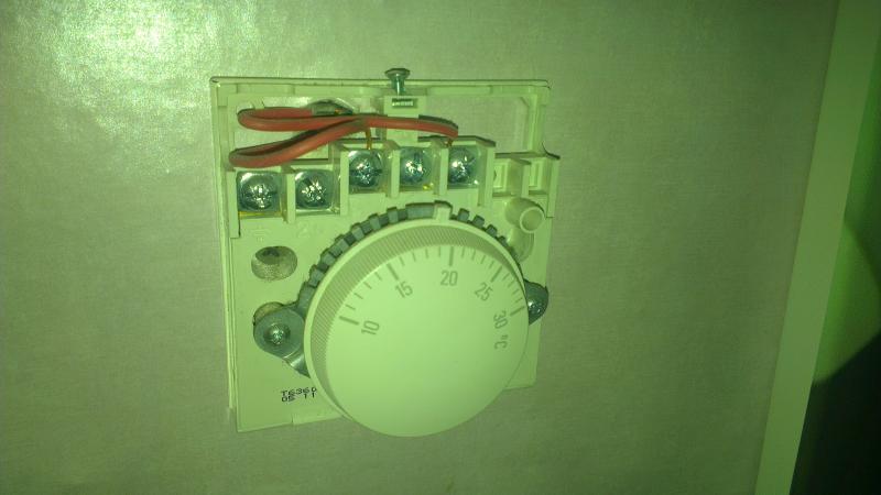

And the thermostat....

The plumber was here servicing the boiler the other day. He suggested changing the thermostat with a Honeywell CM907. Then keeping the current programmer for just hot water control. Does this sound like a good idea?
I think that would be an easy change over, but I am just concerned that then we have two programmers each of which is a potential failure point? In an ideal world, I would want to replace the thermostat with a good combined hot water/heating programmer and thermostat and ditch the existing kit. I don't know if that's possible or not?

Simplest option would be to fit a wireless programmable thermostat and leave the existing programmer controlling the hot water, as your plumber has said.
Programmers tend to be quite reliable.

I thought that if I just replace the current thermostat with something like a CM907' I wouldn't need new wiring?
Like I say, ideally I would replace the current stat with a combined heating/hot water and thermostat programmer. But I can't seem to find a recommended one.

One other problem you have is that your earth wire appears to be used as a live conductor which is a bit of a no-no.

Is it the cable on the right into the programmer that's an earth being used for live? I an easily swap that section of cabling out to correct that.

You could re-use your existing programmer if you want and use a 2-wire thermostat.
I usually fit Drayton programmers and Digitat+ thermostats. The thermostat is battery operated but the batteries last several years.

The plumber's suggestion is a good one, but it only solves the problem so far as heating is concerned, you would still have to go into the bedroom to override the HW settings.
Installation of the CM907 couldn't be easier. ;) You just connect the two wires from the existing stat to A and B on the CM907 (either way round) and set the existing programmer so the heating is permanently on.
any thoughts on how to solve the HW side?
Change the HW on times - seriously! ;)
I have a similar system to you - minus the baby. Our HW times are:
2100 - On; 0030 - Off
1200 - On; 1400 - Off
Evening times ensure that the cylinder is hot enough for three evening showers and reheats the water afterwards, so there is hot water for the morning until lunch time. The afternoon makes up for any used during the morning. If there is a high use during the day, the timer is overridden for an hour or so.
Obviously your requirements will be different, but a well-insulated cylinder will keep the water hot for a very long time.
