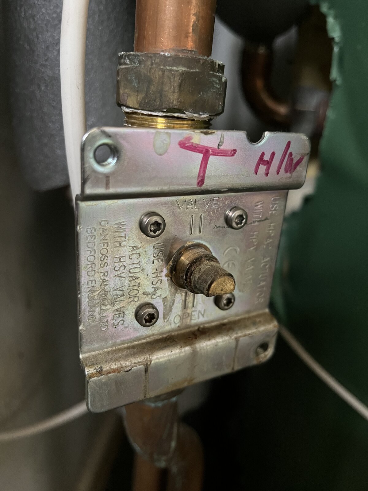

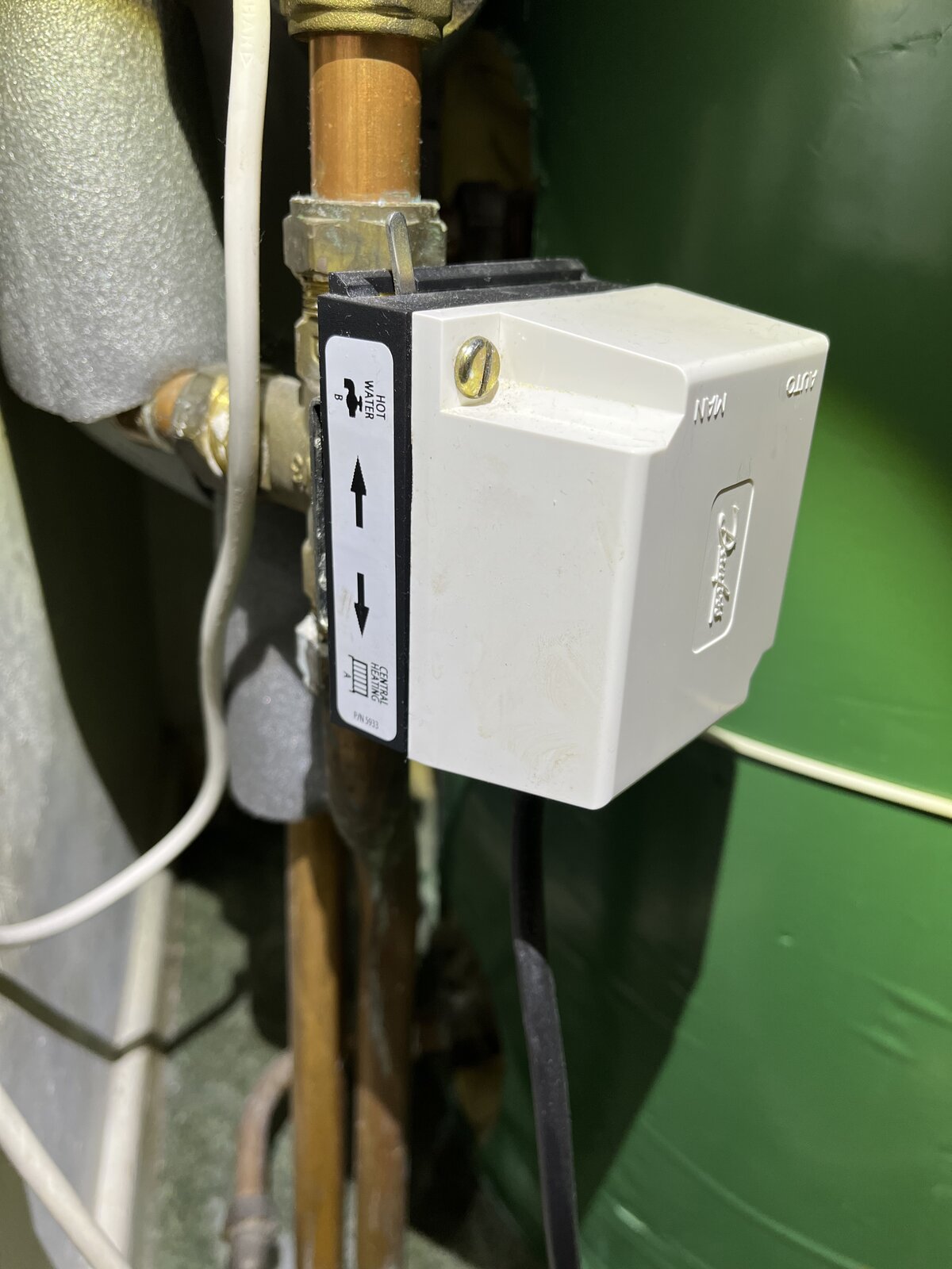

The actuator head ( plastic box ,with wire coming from it) is the part that probably needs replacing ,not the brass body.
I removed the Danfoss actuator, to check it.
The spindle which fits into it is a bit stiff and it seems like there’s some corrosion on it.
I need pliers to turn it easily.
Also, the actuator is quite warm, even though the heating went off a couple of hours ago.
I guess I’ll try swapping out the actuator first and if it doesn’t resolve the problem, I may need to change the brass body as well.

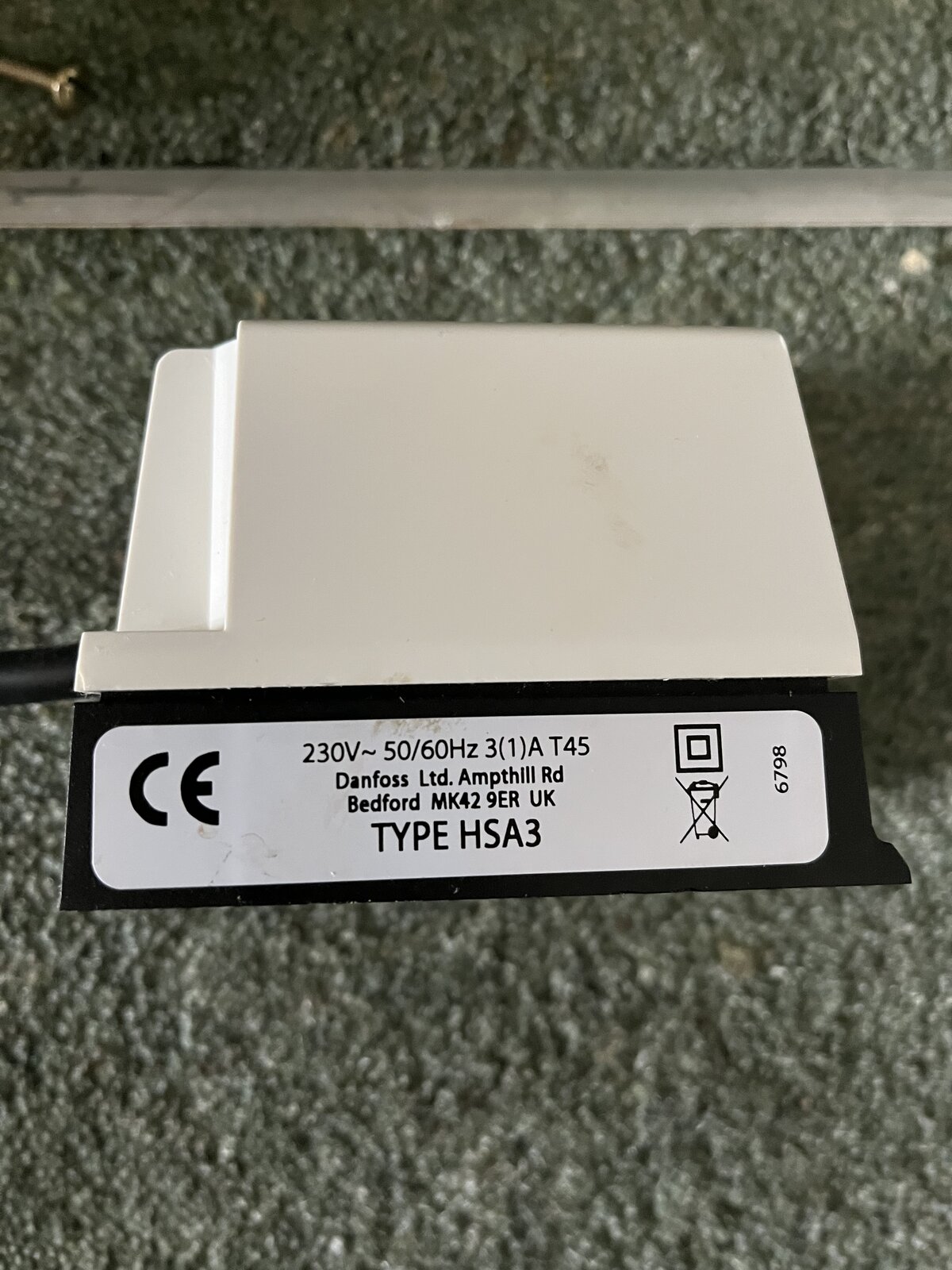

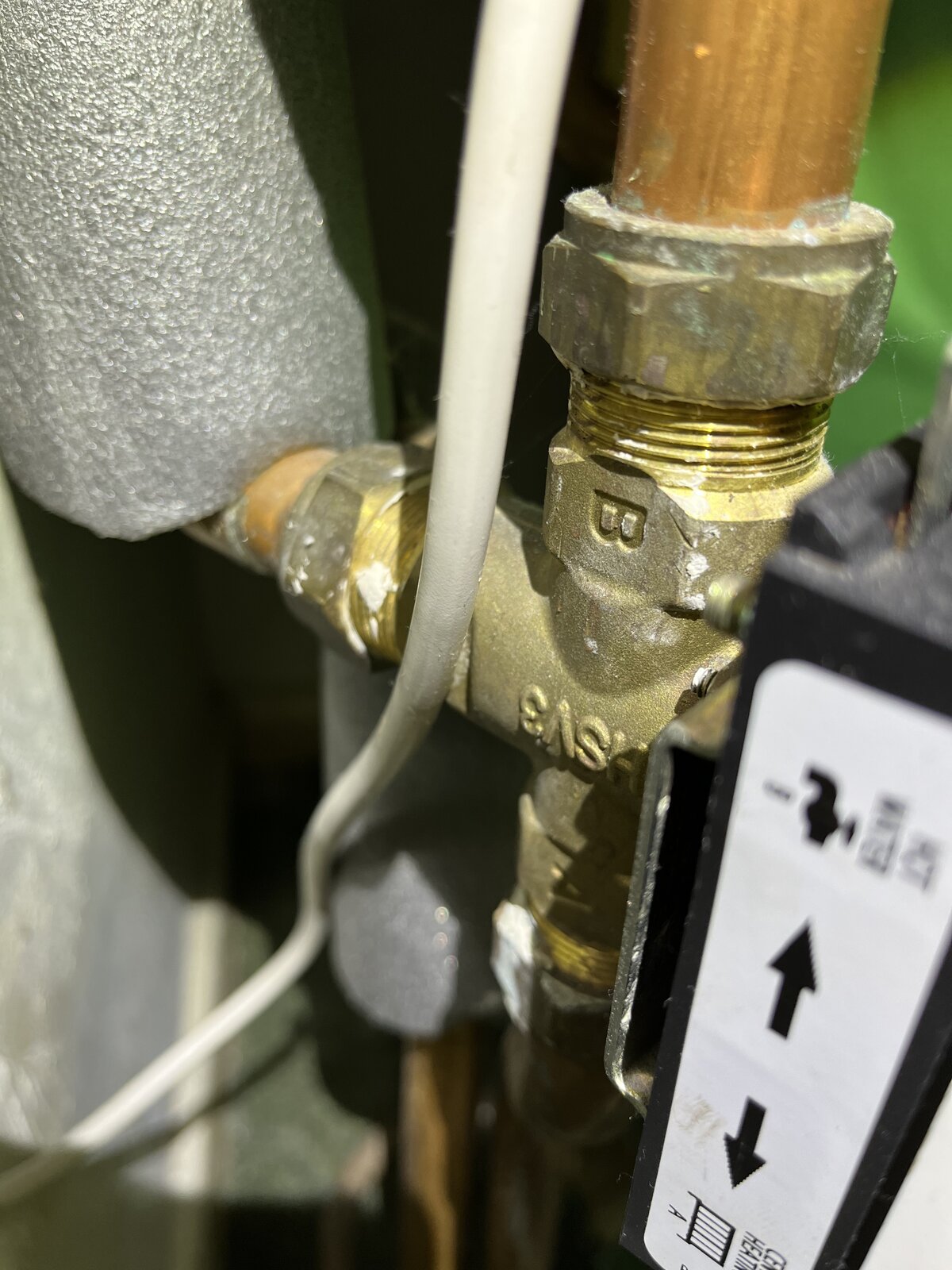

The spindle doesn't turn much ,but should move fairly freely. A drop of oil on it may help.
It has been moving when you manually latched it ,and they do remain quite warm even when you turn programmer off.
The difference in cost between just the actuator ,and a full valve isn't great. I would buy a complete valve and try fitting just the actuator.
