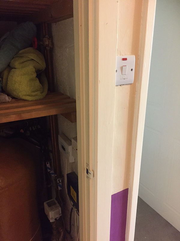

PICTURE 1: As you can see there is a switch with a fuse bit very near to the panel. All the cables from the actual panel however go into the black box.

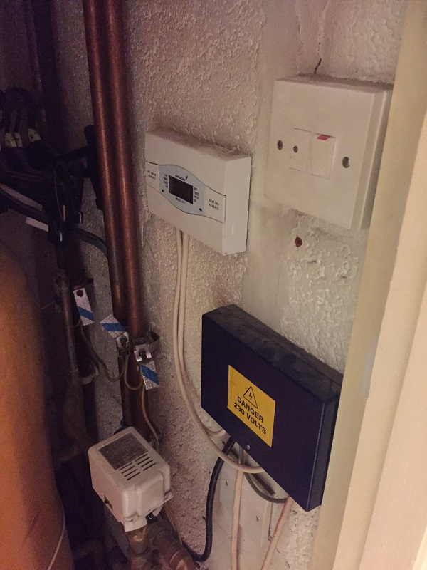

PICTURE 2: There's also this switch which I have no idea what it's for. I've lived here 5 years and it seemingly doesn't do anything. No loft lighting which is what I thought it may initially be for.
Picture 1- Have you checked the fuse in that FCU yet? I know there are no visible cables but people do bury cables in walls :)
Picture 2- Does the neon light up when you switch it on? Most likely for an immersion heater (which may no longer be there)

About to go to the shops and will get a new 3A fuse which is what was in there. Will try that out.
Picture 2: nope, doesn't light up at all
Someone already mentioned that fuses usually blow for a reason.....have a good look inside that cupboard (and that black box) for any scorch marks before you stuff a new fuse in. Don't suppose you own a multimeter do you?
Pic 2- ignore it then. Somewhere there'll be a large lump of cable hopefully not connected to your consumer unit

There's a saying about the dangers of assuming anything. The fuse MIGHT have expired of old age, more likely (especially since the MCB has tripped as well) it has expired because whatever was connected has tried to draw too much current. Could be a failing boiler, could be some DIY nail through cable scenario, could be an arcing terminal. Visual inspection and testing is the only way to get a definitive answer.

The new fuse seems to be working. I placed in, turned the circuit breaker thing to ON. I then switched the switch on where the new fuse was and the control panel turned on
Finally I turned boiler switch on and it ignited and is now producing hot water again.
