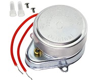

When the motor fails, it can be replaced very quickly and cheaply. The whole valve head doesn't need replacing, and there's no need to drain the system down. So my suggestion would be to keep a spare motor to hand. That's what I do.
You can buy one online here for £10
I wonder if anyone else in your area that has suffered the same power cuts has had any similar problems?
Don't waste your time with that motor...or anything from Banico. Some of the worst knock off heating products around.
Always get a genuine motor...easily available as the bagged Drayton replacement from Screwfix etc. It will say Synchon Made in USA on the lid.
All other motors are hopeless...I've had them barely last a year.

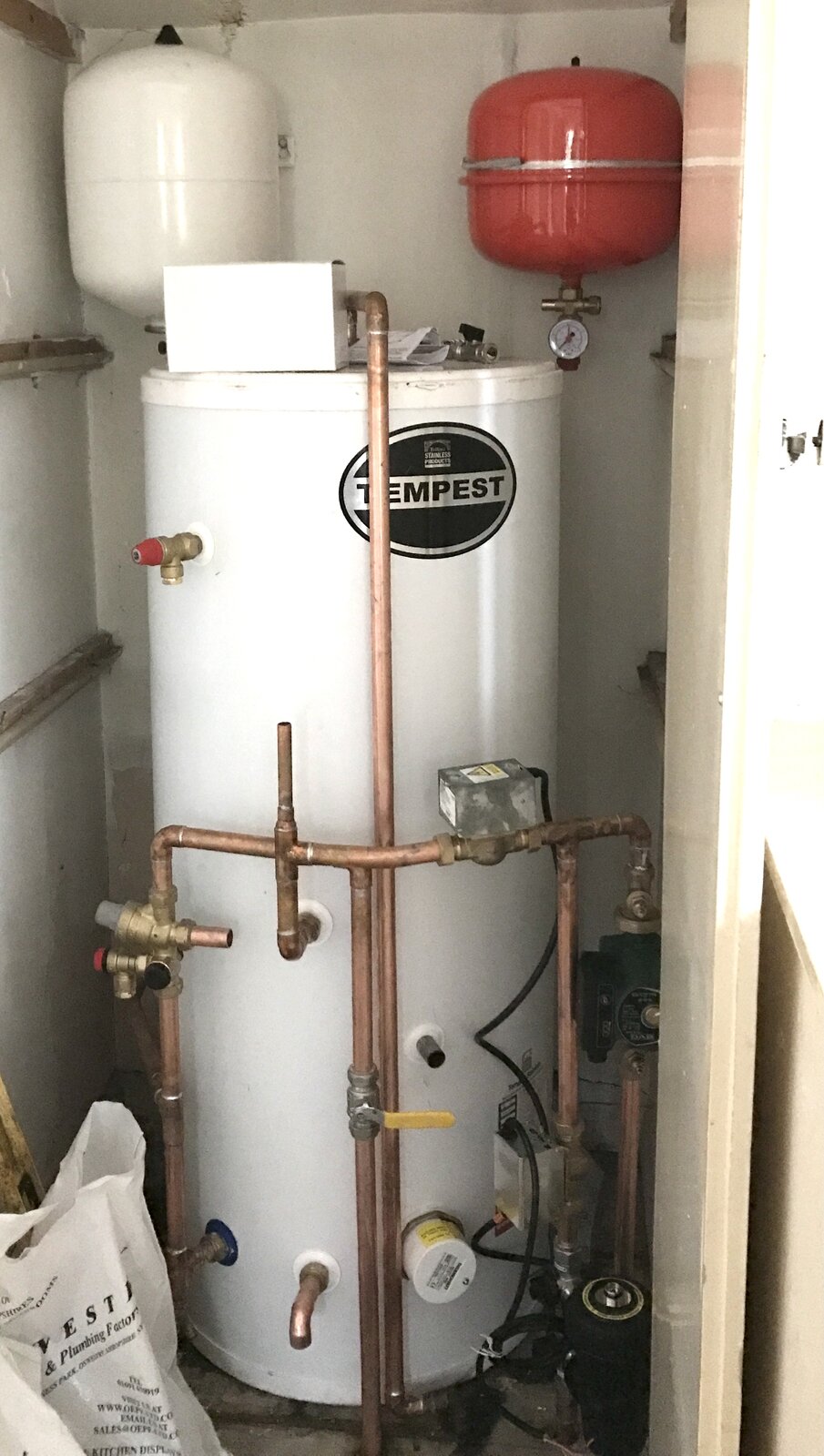

Thank you for your detailed response. The photo posted above shows my entire heating system - there are two separate valves, so one for heating and one for hot water. Its very odd - the first time it happened we couldn’t say 100% that the power outage did it. But the second time, the heating worked the previous day and once the power outage happened, the heating wouldn’t work. the thermostat clicks when we turn it so we think it’s still functional. The controls on the wall seem to work for the hot water etc but just not for the heating valve.
OK, having seen the photos, you don't have a 3-Port valve, but have 2 x 2-Port valves instead. However, the description of the fault still applies to the valve, the heating valve when opened manually won't trigger the boiler switch, but the hot water valve that does work will when the valve opens electrically, so the symptoms are the same.
If you, or someone you know has a multimer and knows how to use it, it's easy to measure the voltage across the L & N supply to the motorised valve. If there's 230V there when the heating should be 'on' and the valve isn't opening, then the programmer / thermostat have operated OK, but the valve has failed. (again!)
If it is the valve that has failed, the power outage is just a coincidence, more likely to be a faulty programmer if the power outage was a factor
