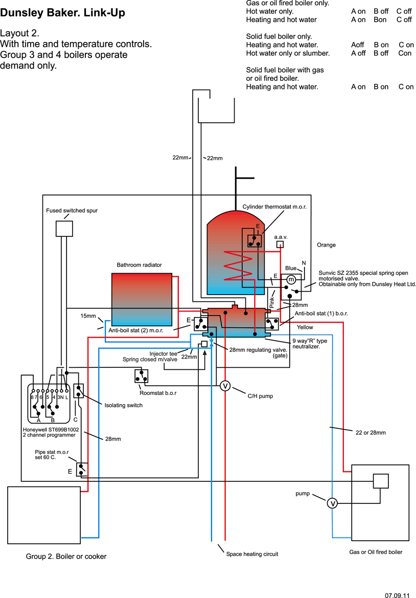

Ideally you need a neutral point (buffer tank) to take everything to. This can just be a modest size cylinder, or a larger one (such as a thermal store suggested as an option).
The wood burner should do nothing but heat this buffer - preferably by gravity, but I believe there are ways to do it pumped.
The boiler should also heat the buffer.
Both these can be direct, or indirect with coils - there is "much debate" about the merits of the two options.
Then draw the CH off the buffer with one pump. And draw off for the UFH separately with it's own pump and it's own TMV which is missing from your diagram. Ie the CH and UFH should ideally have separate tapping on the buffer - but if you share tappings, you should tee between the buffer and any pumps/valves and you will probably need motorised valves or check valves to prevent incorrect flows when only one circuit is running.
DHW can come from a coil in the buffer (as a thermal store), or via an external PHE (as a heat bank).
The above will allow for an "any supplies any" setup. But there are many other ways of plumbing it - generally not allowing for any source to supply any load. Whatever you decide, you are going to have to fix the system as it's got several serious faults - some of them dangerous.
Some really good info there Simon, thanks. I have been pondering & unless I can share the header between the wood burner boiler and the oil boiler, then I don't have much option (don't want to take another pipe up through house). But this presents the problem of the systems being linked. I have now been looking at the Dunsley Baker Neutraliser as a way to solve this. It looks to be an 'off the shelf' solution.
Any opinions?
Here is a pic from the manufacturers website:
The buffer vessel/ neutraliser is effective, but all the circuits from it need their own pump, excluding the woodburner IF the gravity circulation can achieve adequate flow.
You could connect the woodburner to the CH return, if the return passes close above the woodburner. You'd increase the size of the return (giving negligible head losses along it, making it a LLH and so the CH pump induces no nuisance flow through the unfired woodburner).
When the woodburner is on, gravity circulation causes water flow from the inlet end of the LLH to the outlet end. The oil burner is controlled by it's own thermostat, which will prevent it firing if the water, from the wood burner is hot enough.
The CH (primary) pump has to run if either boiler is firing. The flow through the unfired oil boiler shouldn't cause any significant heat loss, assuming it's a fanned flue; otherwise it has to be connected as a secondary sub-circuit with it's own pump.
You need to check the pipe sizes can achieve adequate flow through the woodburner. You can fit a pump, but it needs to have a minimum run timer or be speed controlled; a simple clamp on thermostat will rapidly switch the pump on/off/on/off as the woodburner heats up, pump starts and a slug of cold water passes through. The heat dump rad is still required to operate solely undfer gravity circulation.
