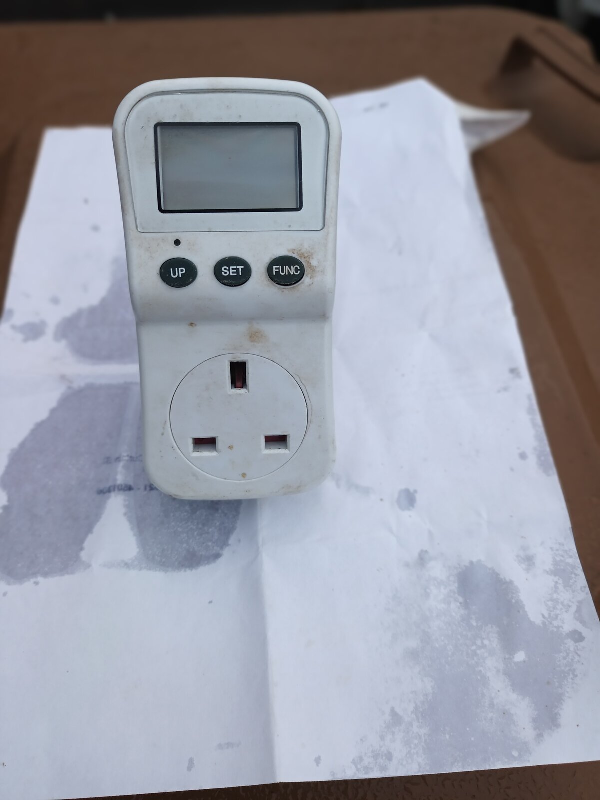

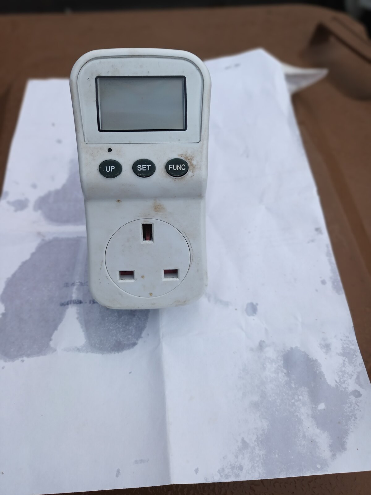

Suggest you get one of those plug in energy monitors, plug it into a independent trailing socket or whatever and plug the UPS3 cable into the energy monitor, you can then read off the power in watts (W) and the flowrate can then be easily read off from the UPS3 pump curves, that will tell a lot.
