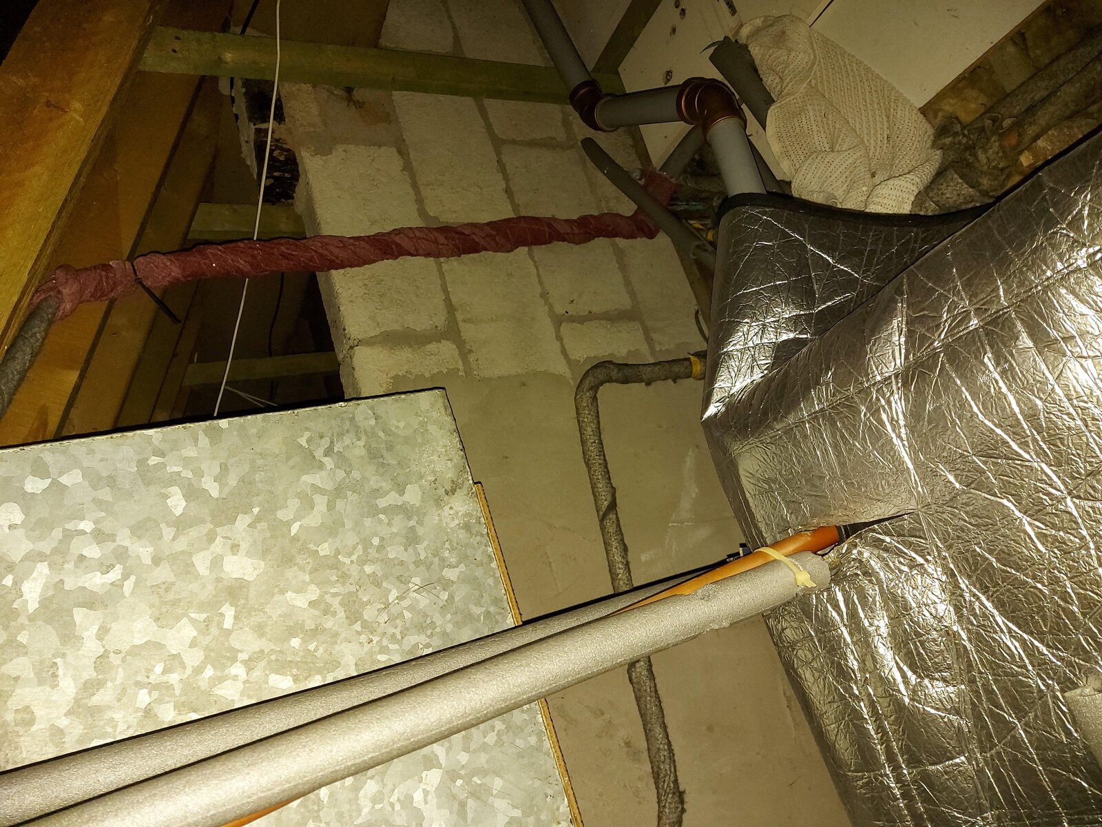

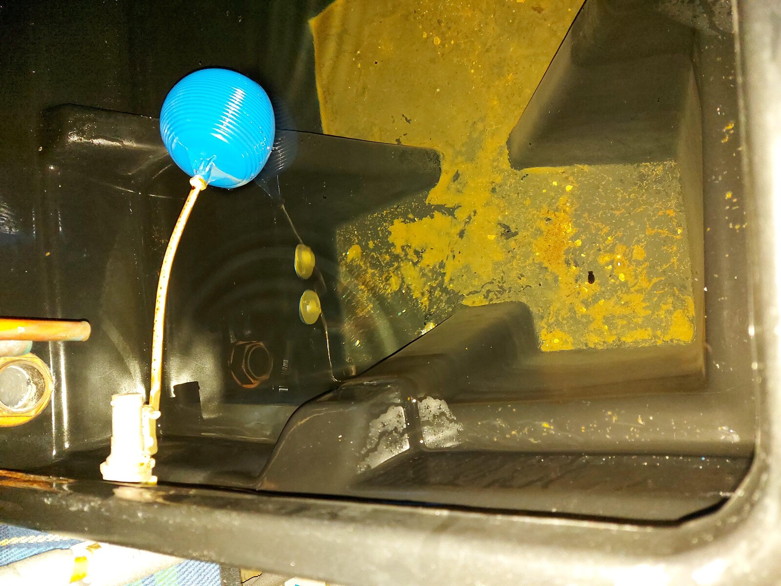

yes small tank in loft above hw cylinder. does this feed the toilets and water taps?

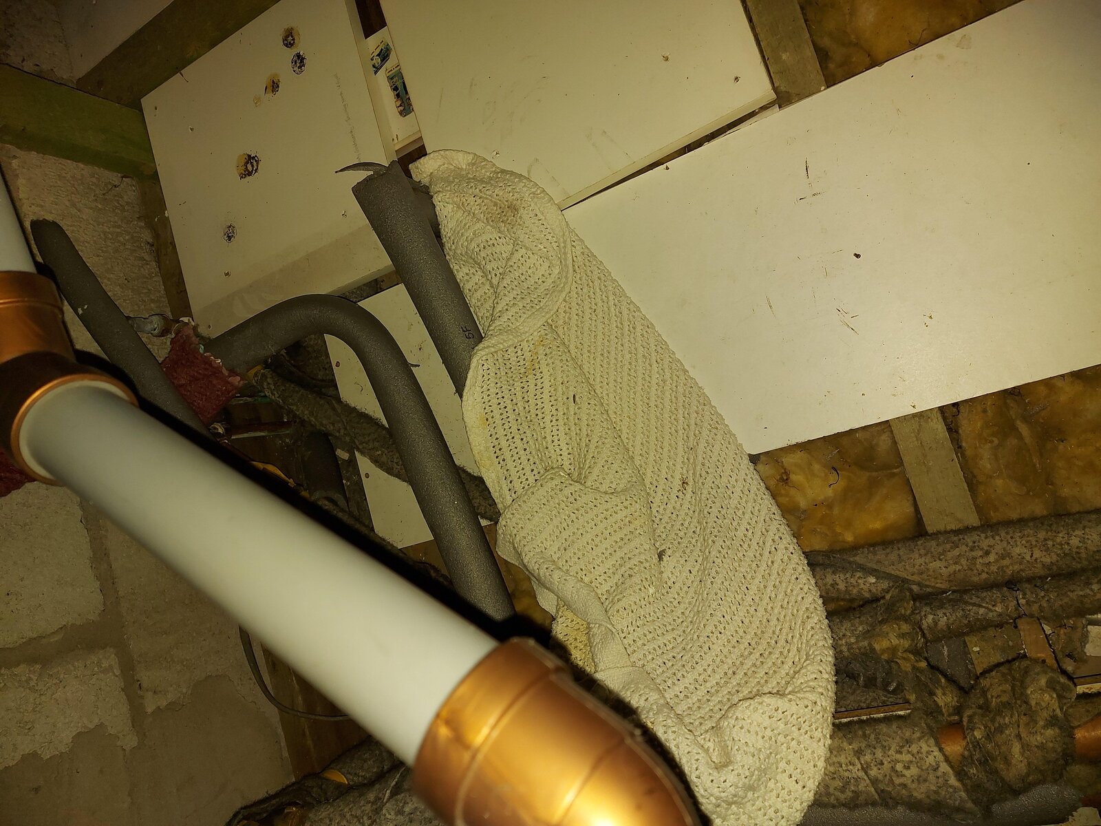

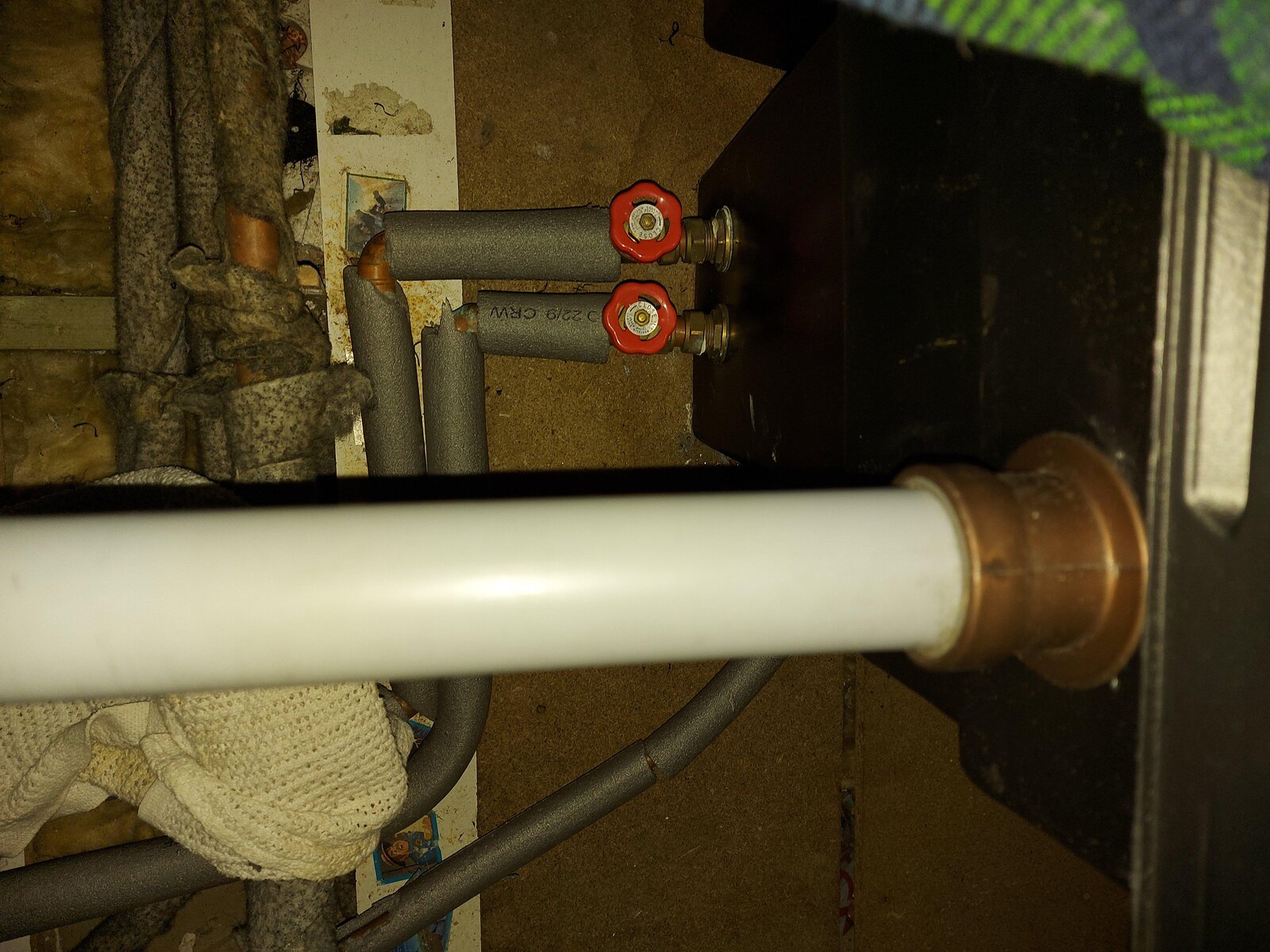

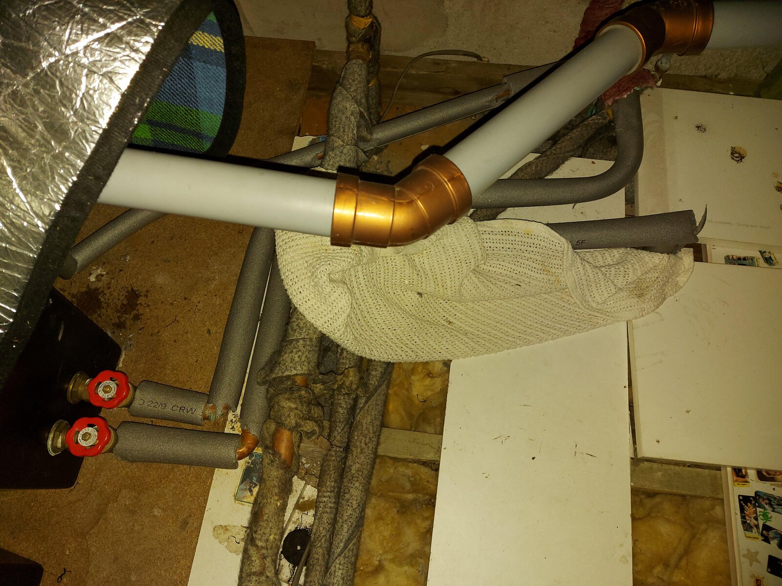

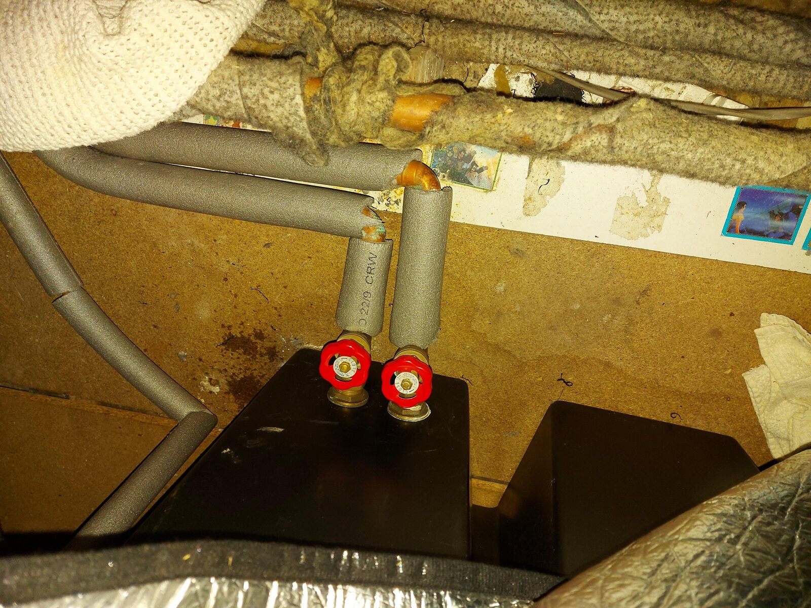

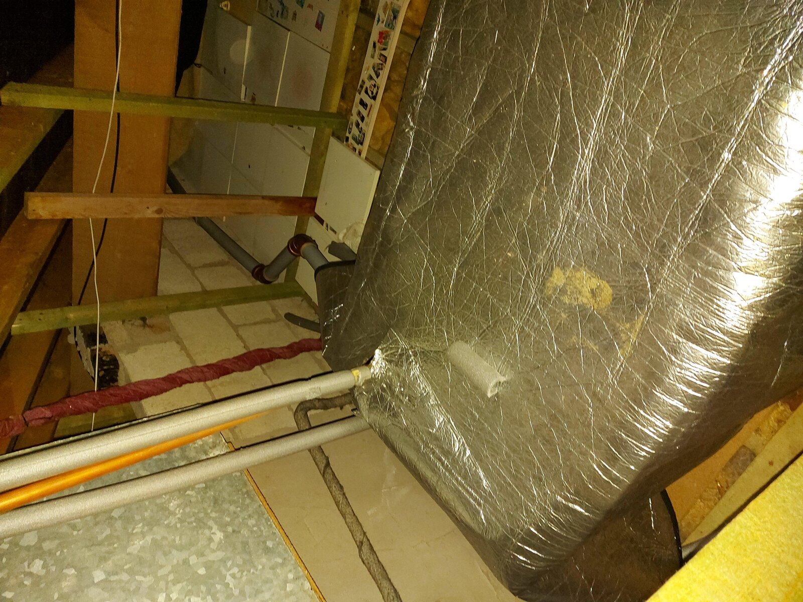

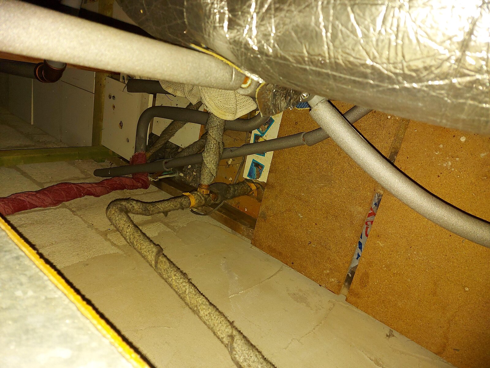

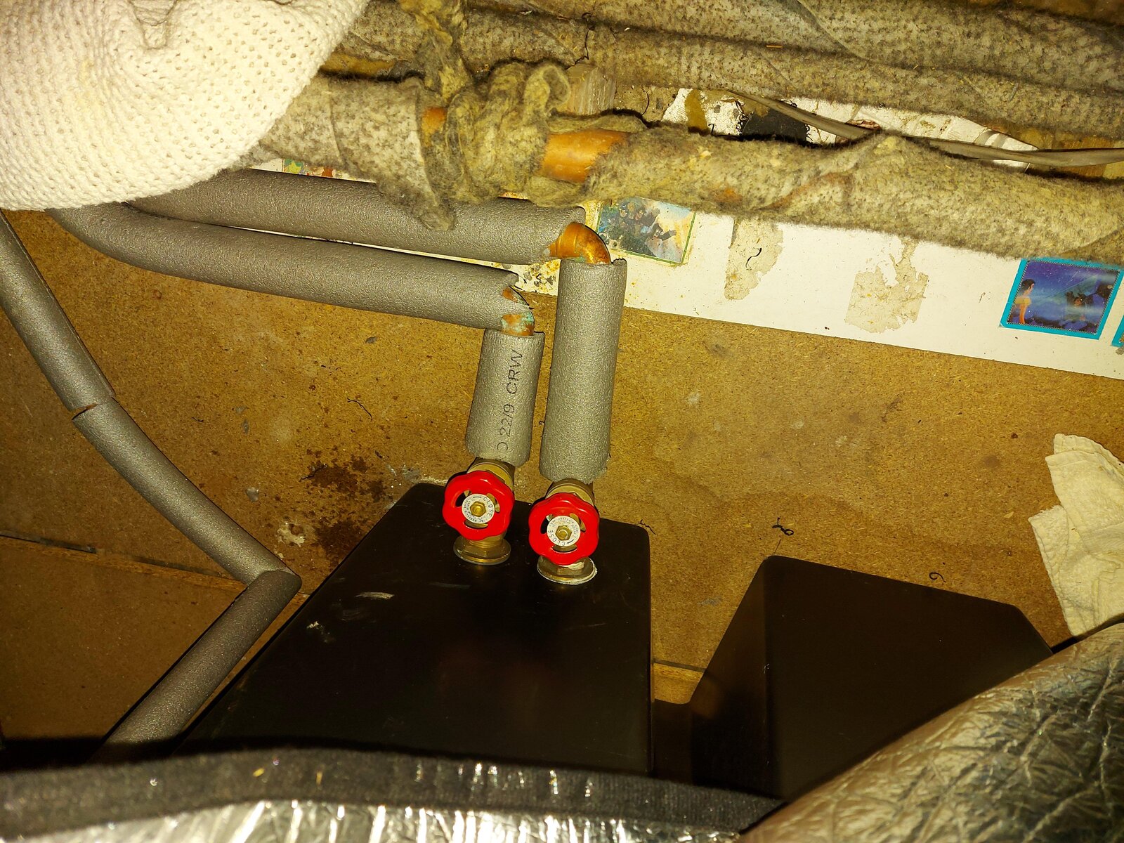

would be best if you posted pics of the tanks in the loft, all of them
getting pics now there is just one black plastic tank with water feed going into it and seems to be 2 outlets running down into hot press where HW cylinder is located.
Pics of water tank in loft

The metal tank seen must have been the old tank which is empty and has been for some time by the looks of it.
that tank is your problem, the water level should be up at the vevel of the bue ballcock the hole juse adove the existing water levil is the pipe that supplies the heating system, either the ballcock is seized or somone has closed a valve somewhere, try gently pushing the blue ball down and see if water comes out
