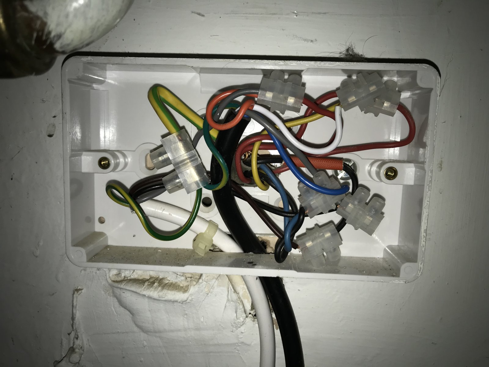

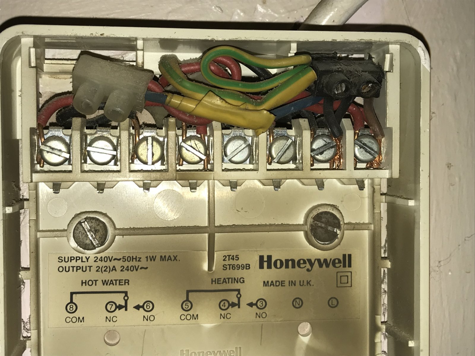

you shouldnt need to change the cable, more likely he just hasnt connected the wires correctly, if it worked before he changed the valve then you have enough cores for it to be wired correctly, post some pics of the wiring centre and the programmer back plate and we will be able to advise you, also with the programmer if you have the HW set to off and just slide the CH to on does the HW on light also come on ?
Hi Ian. Here are images of the wiring centre and controller backplate. The wiring is a bit of a mess so hope you're able to make sense of the connections.
With regards to your question, if I set the HW to off and the CH to constant the HW light does not illuminate. Incidentally, if the CH is set to constant then the CH light illuminates (as expected) but if the room stat is then turned up the boiler doesn't fire up.
Just for reference, the black cable coming into junction box comes from the mid point actuator and the white cable comes from the cylinder stat.
yes it is as we advised, the black cable in the junction box has a grey wire, can you see where that goes to ? it should be connected to terminal 7 on the programmer and also to HW satisfied on the cylinder thermostat, that is your problem
Hi Ian. Ah, that's interesting and, as you say, that sounds like the culprit. I'm not at my mums at the moment but will be popping over at the weekend so will check where the grey wire goes. As you can see, there certainly doesn't appear to be anything connected to terminal 7 on the controller at the moment anyway.
Thanks again for your help with this, it's most appreciated. I'll update with info regarding the grey wire in due course.
that is definitely your problem, come back and let us know how you get on
Hi Ian. I took a closer look at the wiring centre on Saturday and noticed the following.
NO on cylinder stat (black wire) connects to Mid Point Actuator grey wire. Grey wire doesn't connect to anything else.
NC on cylinder stat (grey wire) connects to Mid Point Actuator red wire and also goes off to controller, although I'm not sure exactly what terminal.
COM on cylinder stat goes off to controller, but again I'm unsure of where this connects without investigating further.
There is currently no wire connected to terminal 7 on the controller, or indeed terminal 4.
I hope this is sufficient info for you to confirm diagnosis of the issue, but please let me know if you'd like me to check anything else.
