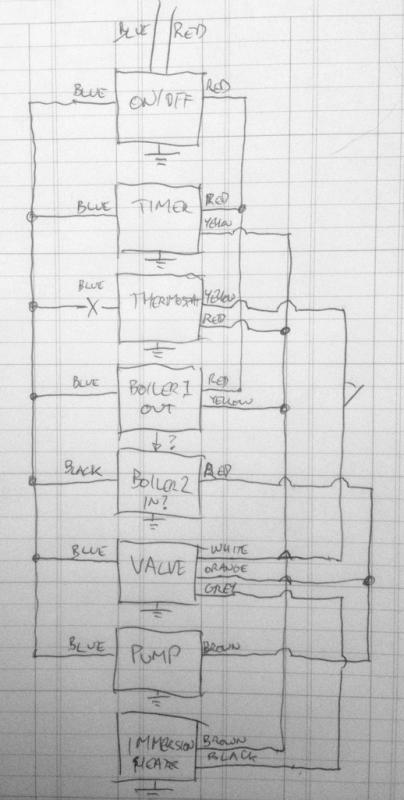

I've posted my circuit schematic below in case it's any help. The wiring is circa 1980s and is a bit of a dog's breakfast, but this is as logical as I can get it...

Here's what I did: I turned the power off at the mains. The thermostat (it's battery powered so was still functional) was connected but set to "off" - i.e. an open circuit across terminals A and B. I measured the resistance between the red wire going to terminal A of the thermostat (marked "red" at the "Thermostat" piece on the diagram above) and the white wire that goes into the valve (marked "white" at "Valve" on the diagram above) and the resistance was 0 ohms. I would have expected an open circuit. (But then again I don't know what goes on electrically within the Valve unit - or it is indicative of a short circuit.) Hope that is clearer.
Thanks for this info. I have just looked at your wiring diagram, which is very unconventional and has raised several questions. :confused:
1. What make/model is the timer?
2. What does the timer control?
3. What is the make and exact model of the boiler?
4. Which boiler terminals do Boiler 1 and Boiler 2 connect to?
5. Is the "immersion heater" the thermostat on the side of the HW cylinder? It may look similar to this:
View media item 10596
6. Are you sure the "immersion heater" has only two wires?
