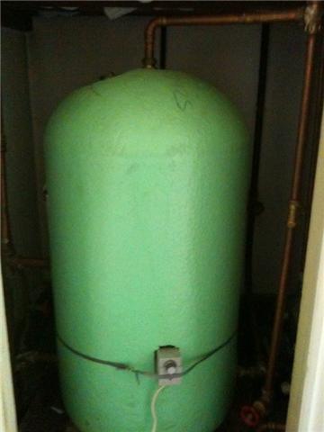

We have to put the heating and hot water on in order to heat the hot water. It's oil fired. Is this an electrical problem or a plumbing problem ?
Dave
Do you have a hot water tank with valves beside it? Possibly one or two?
thanks for the reply.
we have a cylinder upstairs with a pipe going in at the bottom left and coming out a foot higher, both are warm to the touch. There is a cold pipe coming in on the other side and then a hot pipe going out the top. I think it's called an indirect cylinder.
yes indirect.

I doubt it's the way it's supposed to work. Your photo shows a cylinder thermostat which should switch the boiler off when the water in the tank is up to temperature.

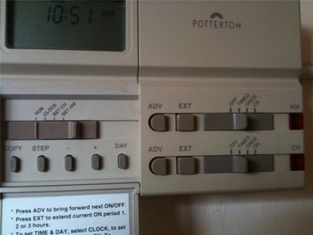

Do you have separate switches for hot water and CH? If you just switch the HW on, does the CH pump run? Is the boiler to cylinder gravity fed or pumped? Do all radiators come on or just upstairs?

There are separate switches for CH and HW on the timer

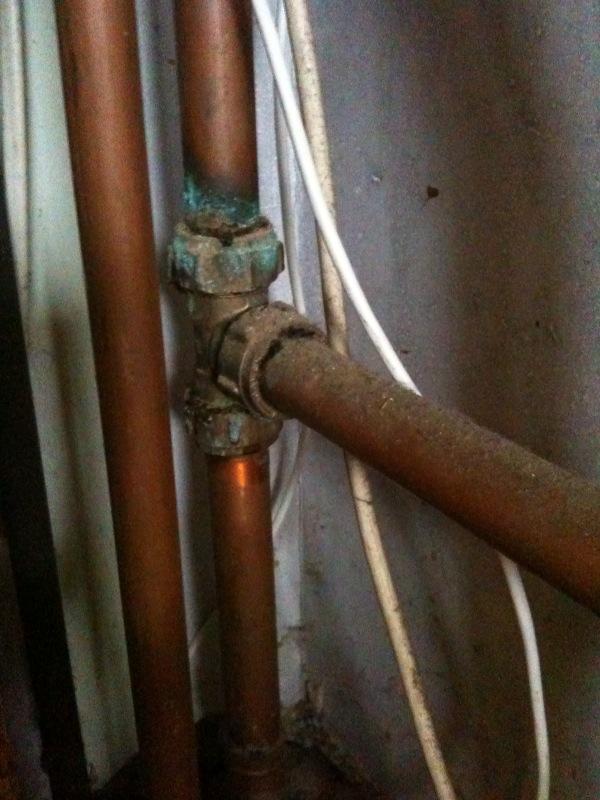

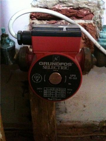

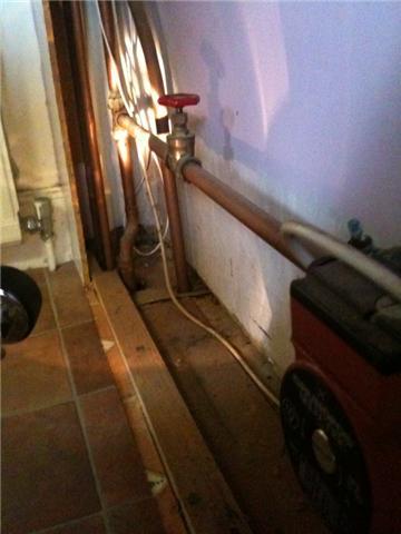

What happens to the pipework either side of the pump?
One side is the hot water flow from the boiler. The other side should go to a tee; one side of this to the hot water cylinder and the other side of the tee to the rads. Try to find the tee; is there a motorised valve located on it?
... but your pump may be on the return.
