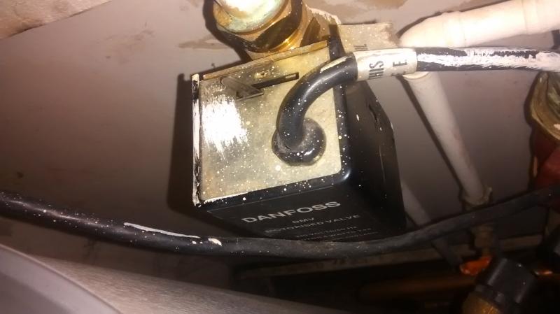

I can't find the valves exactly as you have in your pictures but there are 2 black boxes with the words danfoss motorised valve. One has a switch in 'manual open' position the other has it in 'auto'.
Depending on how old your valves are you might be able to change the head only, can you post a picture of the valves ?

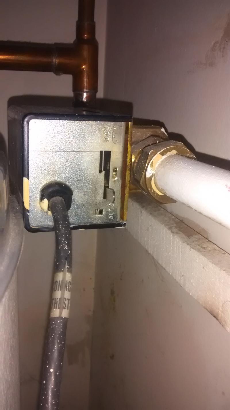

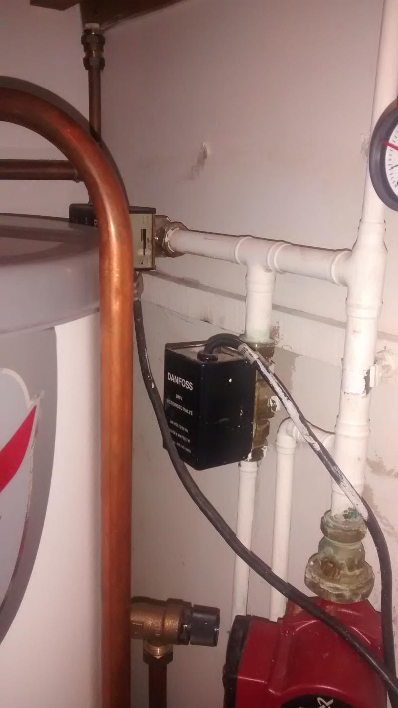

Here are the pictures. The one that is vertical is on 'man open'. The horizontal one is on 'auto'. I have no idea what each one is connected to.
Second photo shows both valves one behind the tank and one vertical.
Doesnt make a lot of difference where the lever is if the microswitch has stuck.
Yes, and if the heating then doesn't come on, it's likely that the motor on the CH zone valve has failed.
If the boiler still keeps firing when the lever is set to auto, then the microswitch is the likely culprit.
To clarify, if the heating doesn't come on but the boiler keeps firing, it's the microswitch.
Or someone has bodged the wiring.

I also noticed the lever in one box moving between 'open man ' and the 'auto' position. Is that normal. Could it be dirt that stops it functioning?
Sorry for continued updates. Just to clarify when I turn the heating on, the lever on the vertical black box in the photo moves from the auto position to the manual position by itself . if I then turn the thermostat down (with the heating timer still on) it moves from manual back to auto. Is this all normal. The lever on the horizontal box seems to stay on auto the whole time.
That's nothing to worry about, as long as it moves back when the heating's off. Is it all working now?
