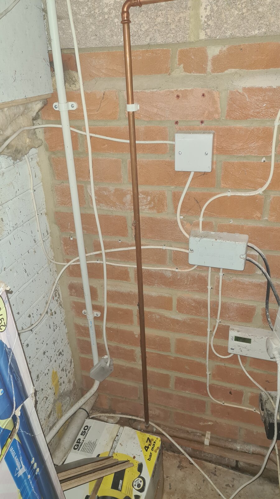

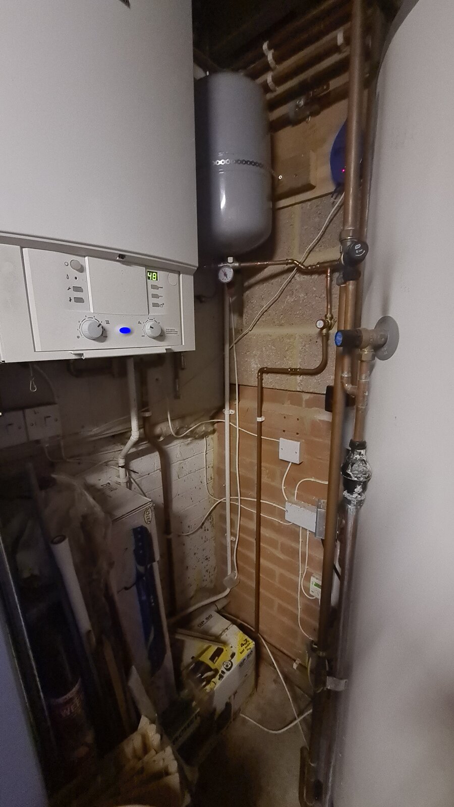

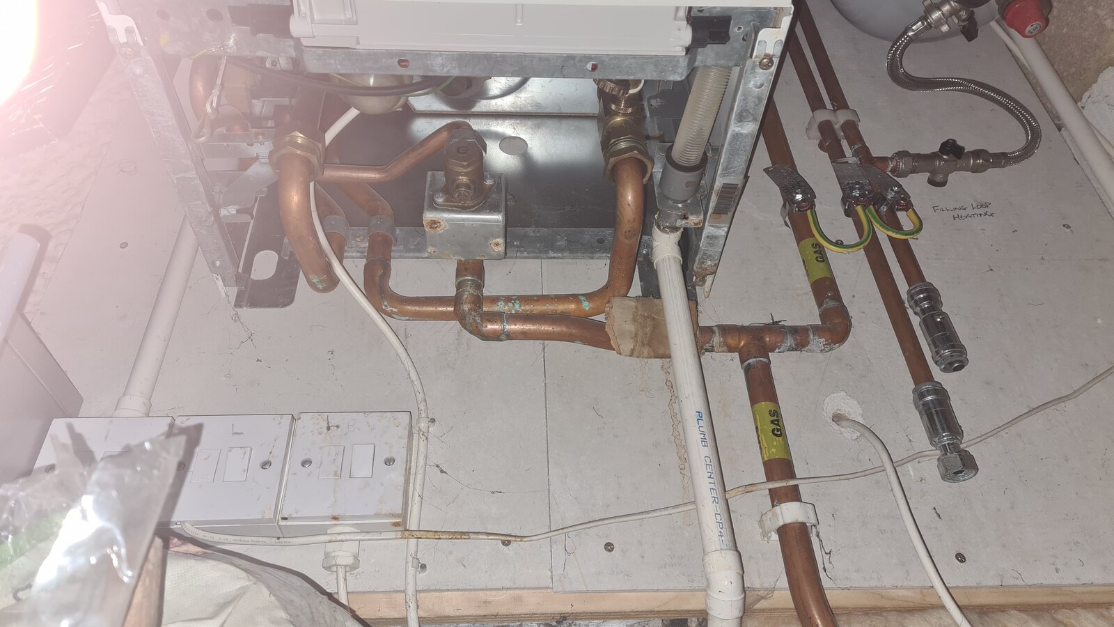

faulty central heating motorised valve its opening but not making the microswitch to bring boiler on ,
put a pic up of your airing cupboard where the valves are

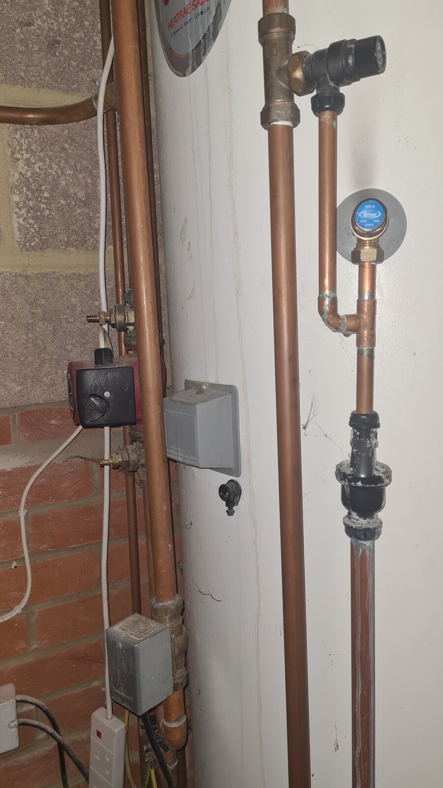

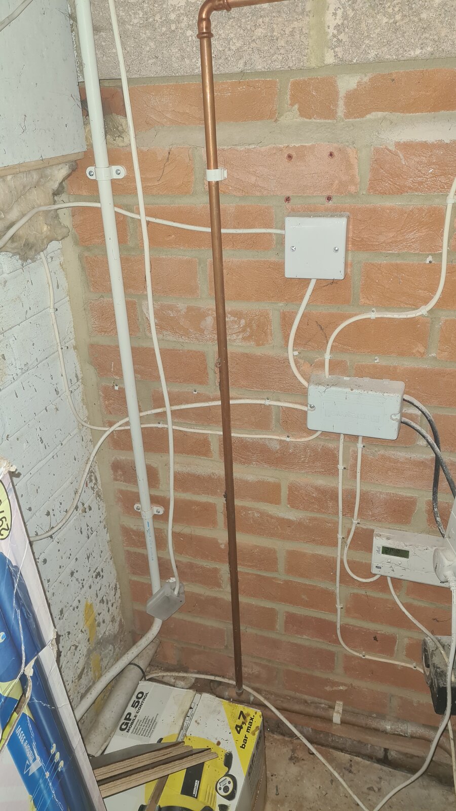

Can you suggest which part exactly should be replaced:
- Diverter Valve (body, actuator, motor)
- Hydraulic Valve
Pictures. Sorry for the mess.

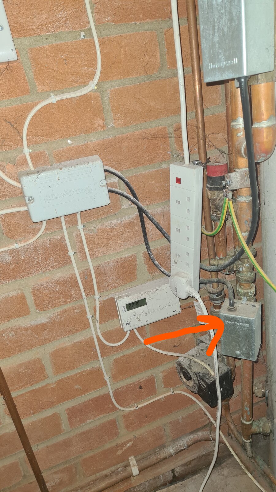

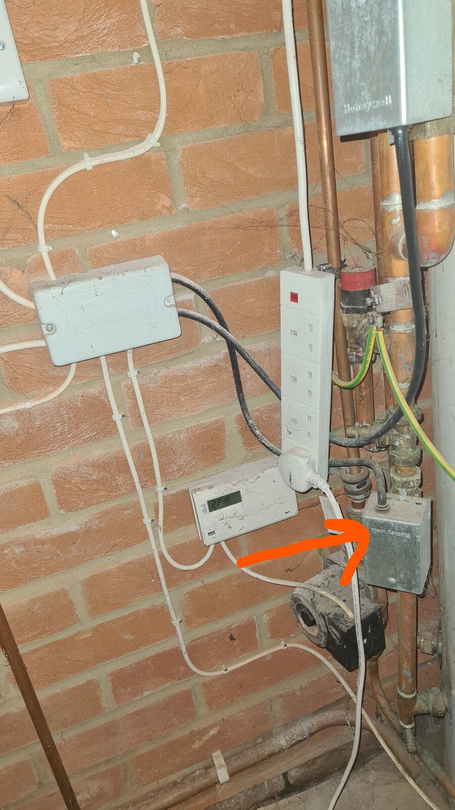

Well, you've managed to miss it in all your photos, but you're looking for the other one of these...
pic 3 with pump and the valve with silver head on it , its the one to heating that is faulty you can just change the head on it no need to change entire valve
Yes found the other one, is this it?
I think Gas112 called it correctly though and it's actually the one I drew an arrow to, rather than the other one

UPDATE: I have changed the powerhead the same day on Friday, and it all worked like a charm!!!
But - midday today I'm afraid this is all over again - no reaction to thermostat signals. the new powerhead is somewhat warm, even if the underlying pipes are cold.
Please guys, any further advice on this?
Maybe that's something with wiring and I should rewire the whole box below? It really has 4-5 wires coming into the same slot at times..
How would I test the powerhead is operational?
Looks like the hot water valve was closed despite the fact it was switched on. So replacing the other one as well. Will replace just a motor (£15 instead of £50 for the whole powerhead).
