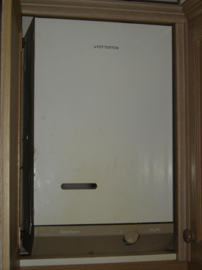

Heating Problem - Potterton Boiler - Micro Bore System
6 Dec 2012
9
Isle of Wight
The problem I have is the boiler will lift the temperature of the radiators to between 50-60 degC, then goes to standby and the returns and hold the radiators at the this temperature for a while. After a short period of time the goes back into standby mode then lights up again for 2-3 minutes and back to standby. At this point the radiator temperature drops down to temperatures 23-35degC.
The room temperature is 19 degC measured with digital thermometer and the wall thermostat is at 25 degC.
The temperature at the pump is 43 degC. The pump is a new Grundfos 15/15 operating in position 3.
The boiler thermostat is set a number 4.
If the boiler thermostat is set to maximum the over temperature button pops out.
If I turn the hot water temperature up to 70 degC and switch on the demand for hot water the boiler lights and will lift the radiator temperature back up to 50-60 degC.

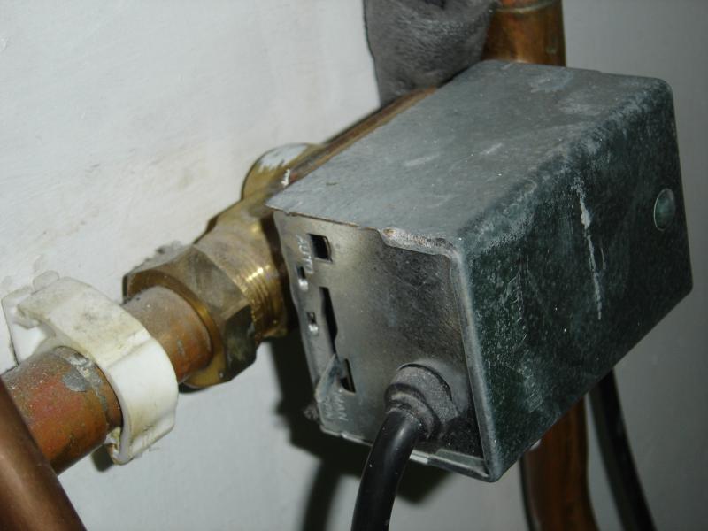

The system has two Honeywell motorised valves and not a three port valve.
I have operated themanual levers on the motorised several times whist the pump has been running and not running.
The next step will be to take the motorised valves out a check they opening fully.

OK, so I can assume that one of the valves turns of flow to hot water cylinder and the other the radiators, on call for CH from the time programmer the live wire goes to the room thermostat, if this is turned up above the room temperature, you should hear the radiator valve open, which in turn activates a micro switch in the valve when it has opened, which turns boiler and pump on.

If I operate the room thermostat by switching the temperature up the following happens:
1) CH Motorised valve opens (checked by using the manual lever)
2) Grundfos pumps starts and runs
3) Boiler starts and runs
4) System running 1-2degC temperature difference either side of the CH motorised valve.
If I operate the room thermostat by switch the temperature down the following happens:
1) CH Motorised valve closes (checked by using the manual lever)
2) Grundfos pumps stops
3) Boiler stops
Repeat the change up of temp on room thermostat and all works fine.
The CH got all of the radiators hot, the boiler stops but the pump continues to run. The temperature of the radiators drops and stays warm until I switch off the CH and restart with the HW first then start the CH.
All radiators get hot again.
If I start the CH first then start the HW the radiators do not get hot only warm.
When the timed program starts both CH and HW the radiators get hot and remain hot all of the time the HW channel is switched on.

The boiler is a Potterton Netaheat Profile 60e.

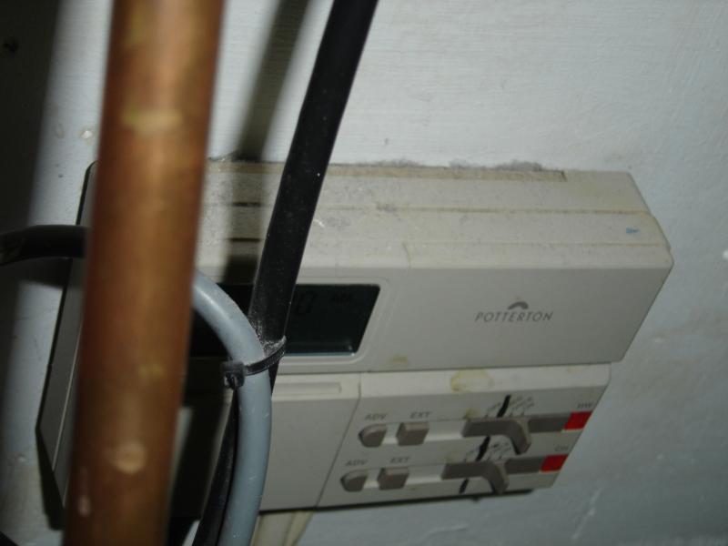

The programmer is a Potterton EP 2000.
The room thermostat is Honeywell wall mounted simple unit.

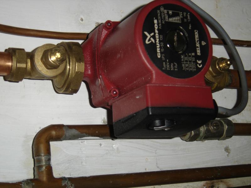

The problem was recently identified after replacing the main pump from a euramo mxl 180 to a grundfos Selectric 15-50.
The pump was replaced because it was noisy and viabrating, even when operated at the low speed. There was also a lot noise (kettling) from the boiler. All the noise stooped once the pump was changed and the chemical was added to the water.

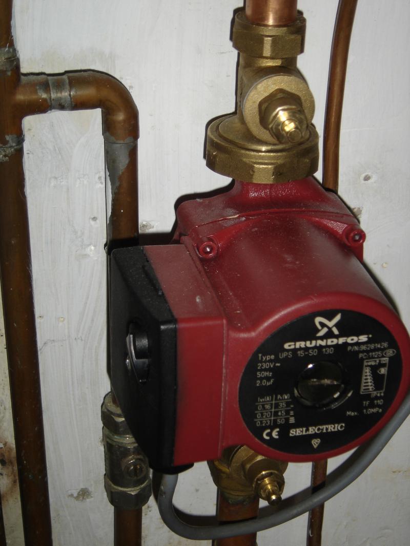

Who replaced the pump?
Assuming the picture is the right way up then the motor head is upside down!
Was that a substandard DIY attempt or a nupty professional?

The pump was installed with the flow arrows pointing up, the flow comes in at the bottom and goes out at top onto the CH and HW motorised valves. You can see from the photograph the Grundfos label is the correct way up.
The label can be rotated to any orientation that you choose!
Most would have advised using a 15-60 pump on a microbore system.
