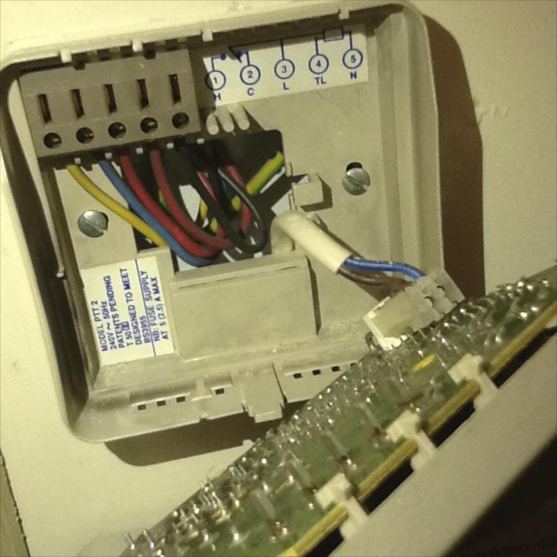

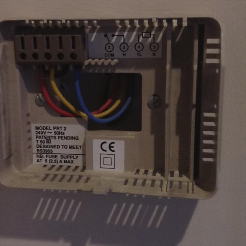

Basically the heating will only come on if I 'force' it by turning the thermostat down past 'below' then turning it quickly back up to the required temperature. Without doing that it will not come on as requested at the programmer. HW works as it should.
Boiler is a Glow Worm Flexicom 15HX installed in Dec 2007 (original paperwork present).
Its controlled by a Potterton EP2002 programmer directly below the boiler (in the kitchen) with a Potterton thermostat in the hall by the radiator with the two lock shields.
I bought a replacement MPE322 but haven't installed it yet. Before I do I was wondering if anyone had any other thoughts on what might be the problem?
Old thermostat? Wiring issue (although I suspect the wiring is as it was when the house was built in 1998)?

Without attending site and carrying out electrical checks to see where the fault actually lays, it is only possible to guess- which could end up costing you more in the long run, I have known the Potterton Electronic Rooms stat to suffer from a sticking relay - of course that is only a guestimate ;)

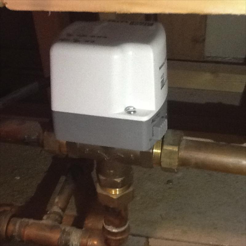

So everything is correct except when CH is called and HW is satisfied. This normally means that there is no wire from the cylinder stat SAT terminal to the valve grey wire. Looking at the picture, the cylinder stat does have a wire connected to the SAT terminal. It would be worth checking the other end. It should go to the same terminal as the valve's grey wire. There will be a third wire on the terminal, coming from the Programmer HW OFF terminal.
If the wires are in place, the only possible cause of your problem is a faulty cylinder stat.

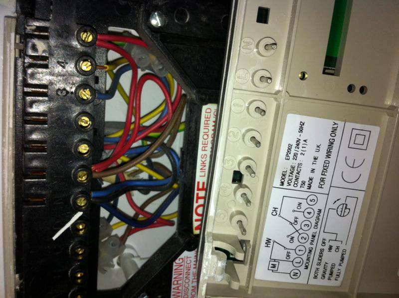

Please see attached a photo of the wiring at the programmer.
Is this where you mean for the other end of the wire to the SAT terminal?

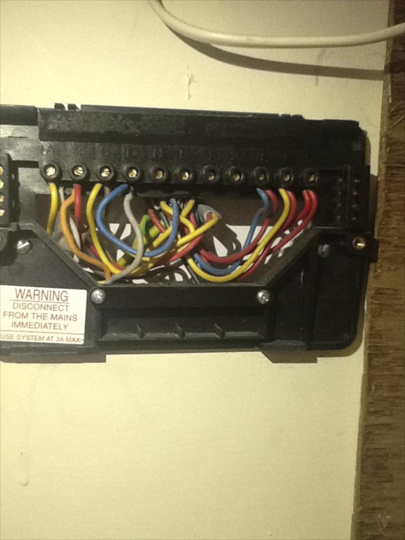

Do the cylinder stat and motorized valve cables connect directly to the programmer or via a junction box?
Direct
Does the valve grey wire connect to terminal 1?
Does the HW stat SAT terminal connect to terminal 1?
via Junction box
The valve grey wire + wire from prog T1 + wire from HW stat SAT should all connect to the same terminal in the junction box.
Hopefully I'm seeing this properly.
The blue wire from SAT (C, 2 - Correct?) is connected to the grey wire from the motorised valve at position D of the wiring centre. There are no other wires present at that terminal. There are also no wires present at terminal 1 of the programmer.
There are
3 x N
3 x L
1 x Blue at 3
1 x Yellow at 4
2 x Reds at 5
Yes, C2 is the SAT terminal.
When you say "wiring centre", I assume you are referring to the backplate to which the EP2002 programmer is attached.
The link from Valve grey to C/2 at D is correct. You also need to link terminal 1 to D as well. Your problem should then be solved.

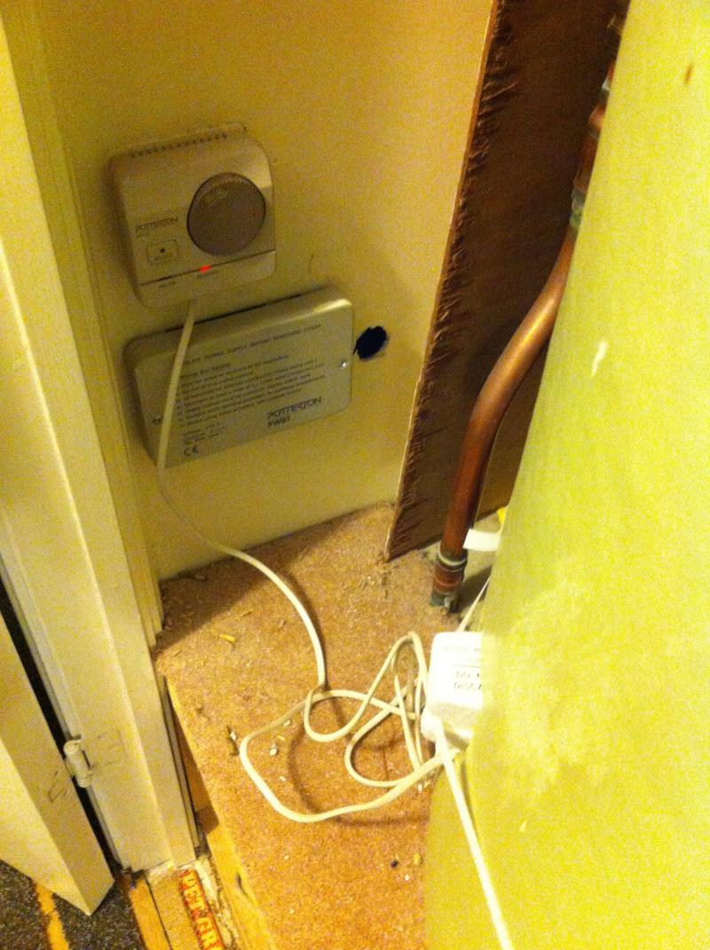

Unfortunately not. For wiring centre I was meaning the big junction box below the cylinder stat.
The cylinder, stat and big junction box are in a cupboard upstairs whilst the programmer is below the boiler in the kitchen downstairs.

So it seems there is no link between Terminal 1 at the programmer downstairs and Valve Grey/C2 upstairs. Its either never been done or is wired incorrectly to another terminal. Although the boiler itself has been replaced It must have always had this problem then as none of the wiring appears to be new nor are any of the controls/stats/programmers.

I think you have a problem which will only be sorted by someone present on site.
Yes, there is a missing link. Can't see how it can be wired to the wrong terminal. The Potterton PWB1 wiring centre is not helping as there is a PCB behind the terminals, so it's not easy to know how the terminals are connected together. A standard 10 terminal wiring centre is much easier to fault find.
Anything else I can do or look at or is there any possible work around?
Not easy. It would mean tracing each cable/wire and finding what each end is connected to. It might then be possible to work out a revised wiring scheme.
