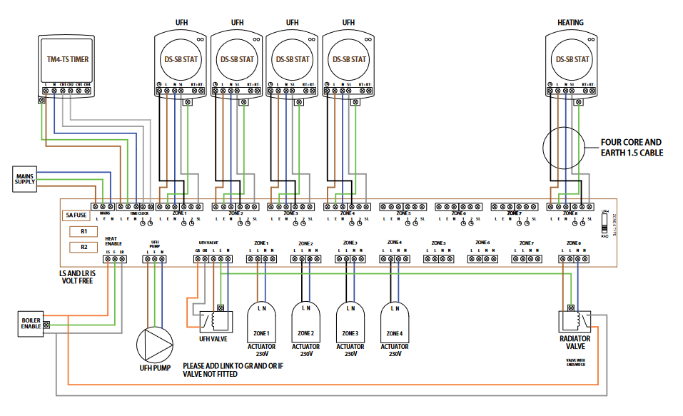

I've just moved into a new build with a heat pump. The upstairs is run from a dual zone Honeywell controller 1 zone for rads another for towel rails. It's also got a heatmiser neostat v2 in the upstairs hall. The problem is that the neostat is just blank with no power to it until the rad zone is switched on from the Honeywell. If the rads are off but the rails are on the neostat is off. This seems a very odd setup as the timers on the Honeywell and the timer on the neostat can conflict but only having it live when the rads are on seems a bit mad to me. Does this sound logical to you? I need to get the builders involved but I'd like to know what you think?
Thanks in advance for any advice.
The neostat does both time and temperature, so the Honeywell programmer is irrelevant.
Heatpumps should be used with controls designed for them, not basic on/off efforts.
Sounds like a total lash up where someone has shoved a heat pump in thinking it can be used exactly like a gas boiler from decades ago.
Clearly not designed, specified or installed properly and will no doubt cost a fortune to run with results that are disappointing.
